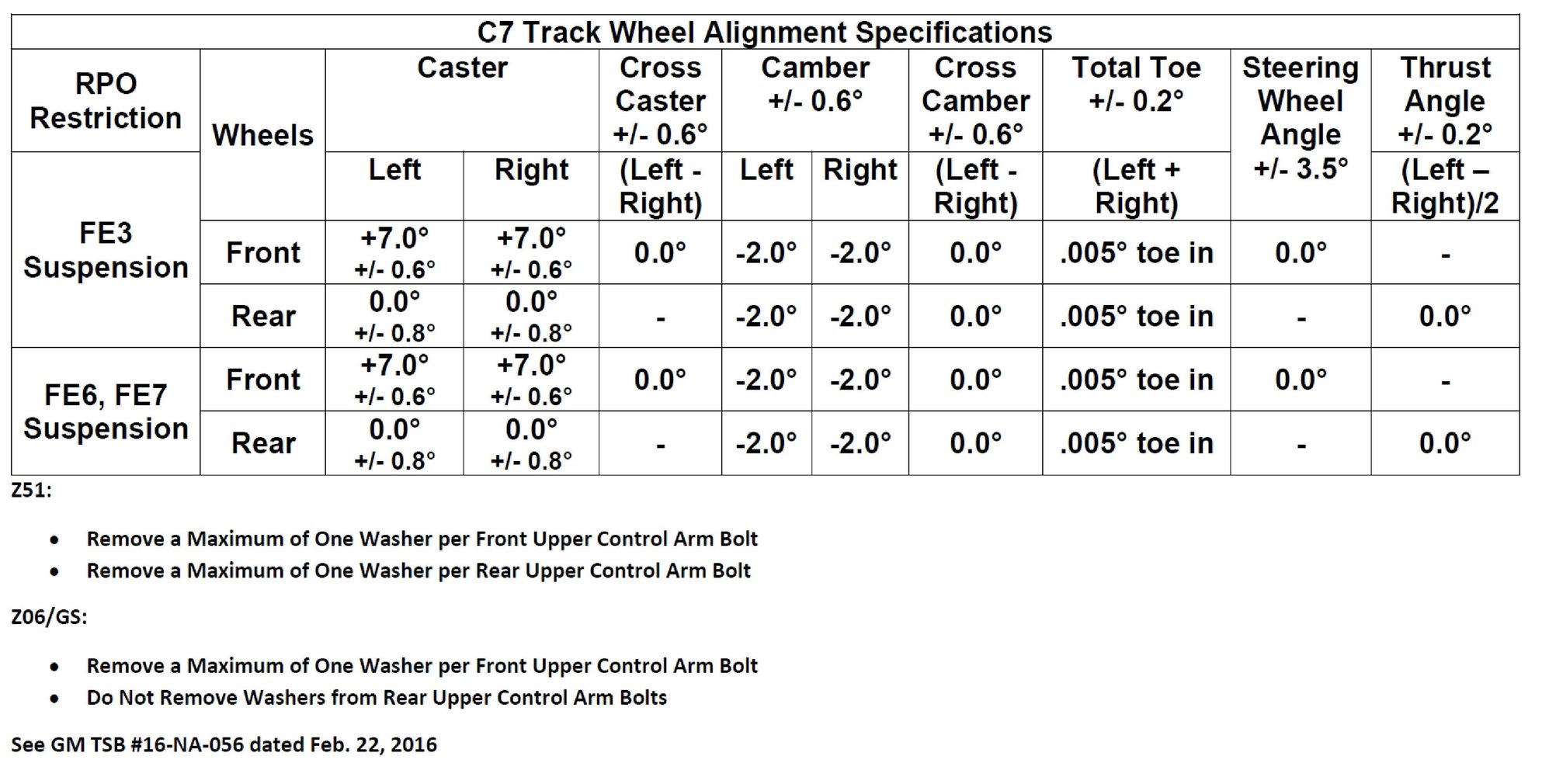

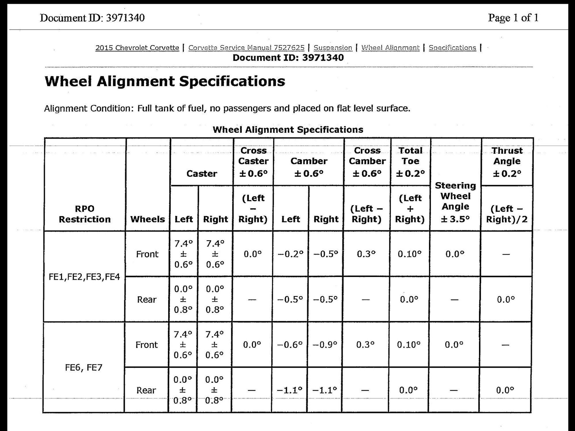

The C7 came with a specific alignment when it came out of the factory. Most of the Z06s and GSs that I have played with came with -1.0 plus or minus 0.1 degrees of camber at all 4 wheels. GM does have a track alignment that is recommended when the car is taken to the track. That alignment is far different than the way the cars came from the factory. Here are the factory specs that are shown in the Factory Service Manual:
The Z06 and GS have the FE6 and FE7 suspensions.
The track alignment is:
Notice the negative camber for the track alignment is at least double the negative camber of the street alignment. Also, notice the front camber is the same for both the left and right sides of the car while the street settings have the right side camber -0.3 degrees more than the left side. This added negative camber helps compensate for road crown pull assuming the car is driven on the right side of the crown Vs the left side.
A lot of mechanics that have never worked with track-related alignments think street settings are track alignments since they are more aggressive than the grocery-getter vehicles they normally work on, but they are still street settings.

Many here have used this spec sheet for their alignment with success, including myself. Good Luck!
