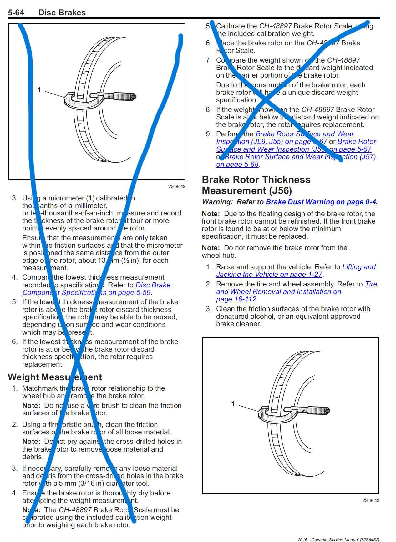

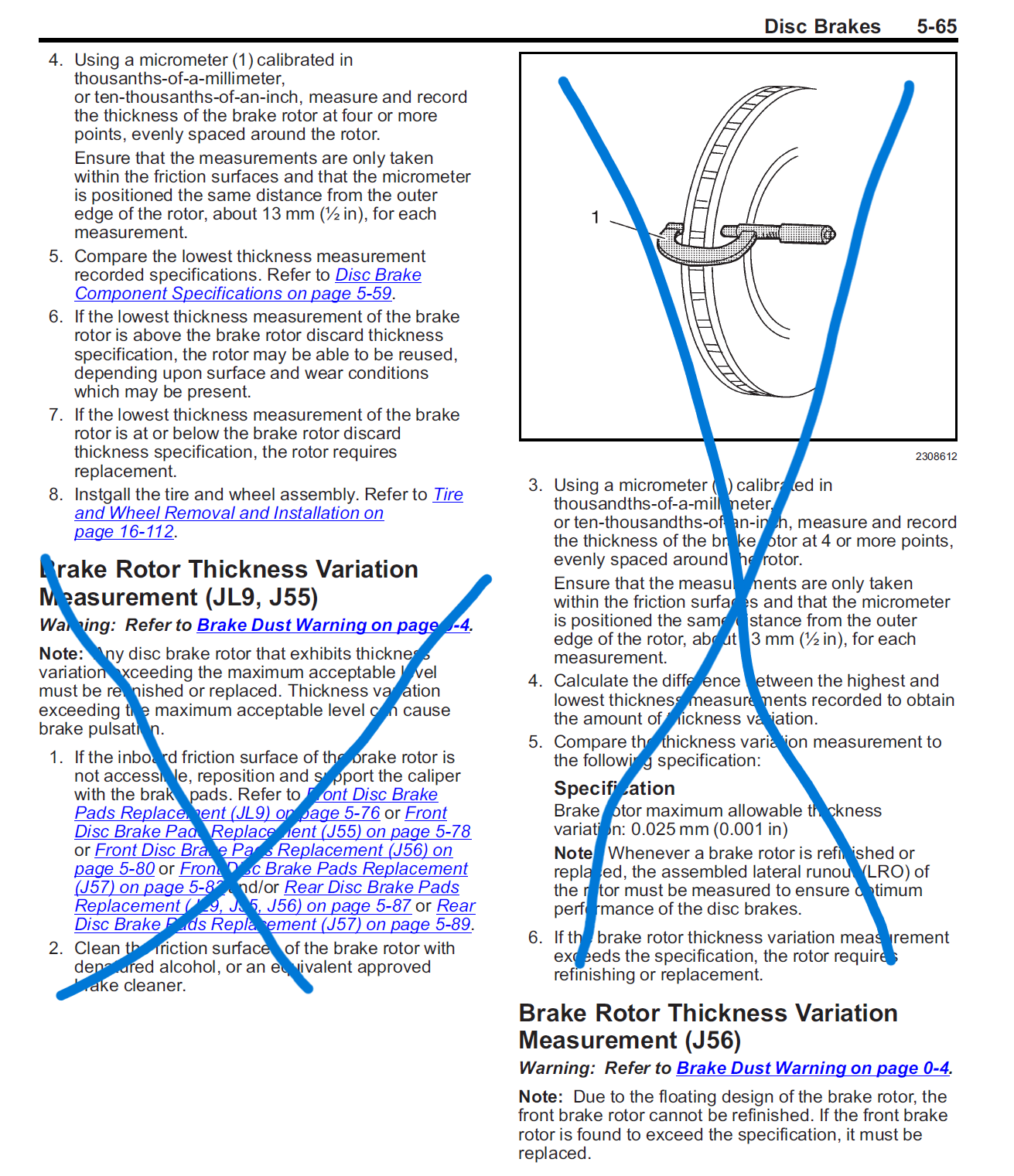

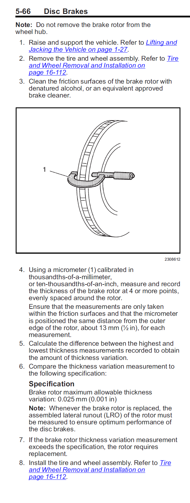

With street driving Iron Rotors should last at least 50K miles and more than likely a lot more. The pads will wear faster but you don't need to replace rotors when replacing pads. If the rotors are above the minimum thickness spec they don't need to be replaced. As the pages indicate the rotors can't be resurfaced since they have a floating design.
Bill

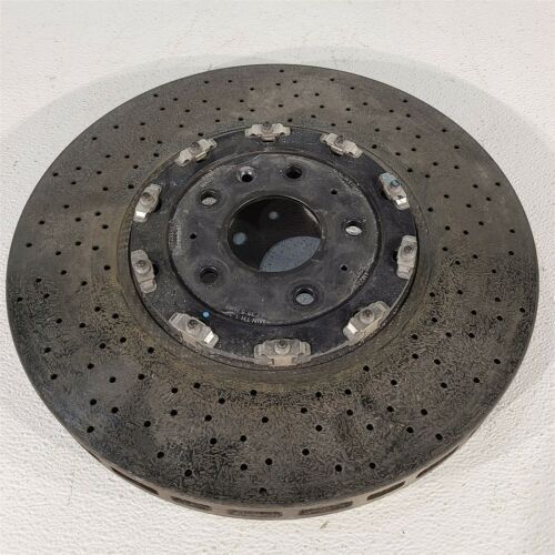

My Front Carbon Ceramic Brake Rotor 15k Miles is available for sale. Still works fine.. Please call or text me 315 221 3957
