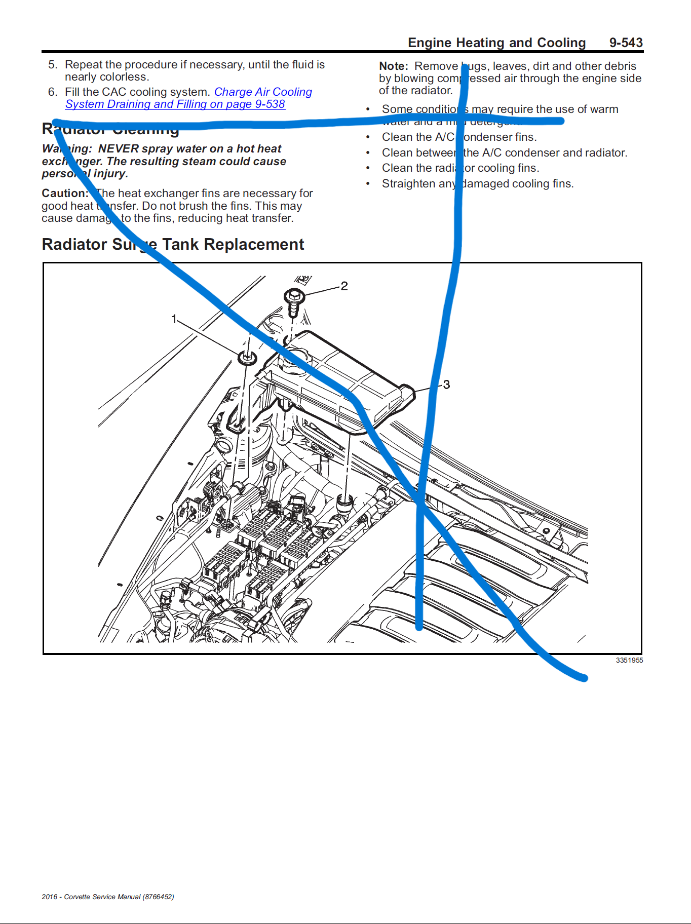

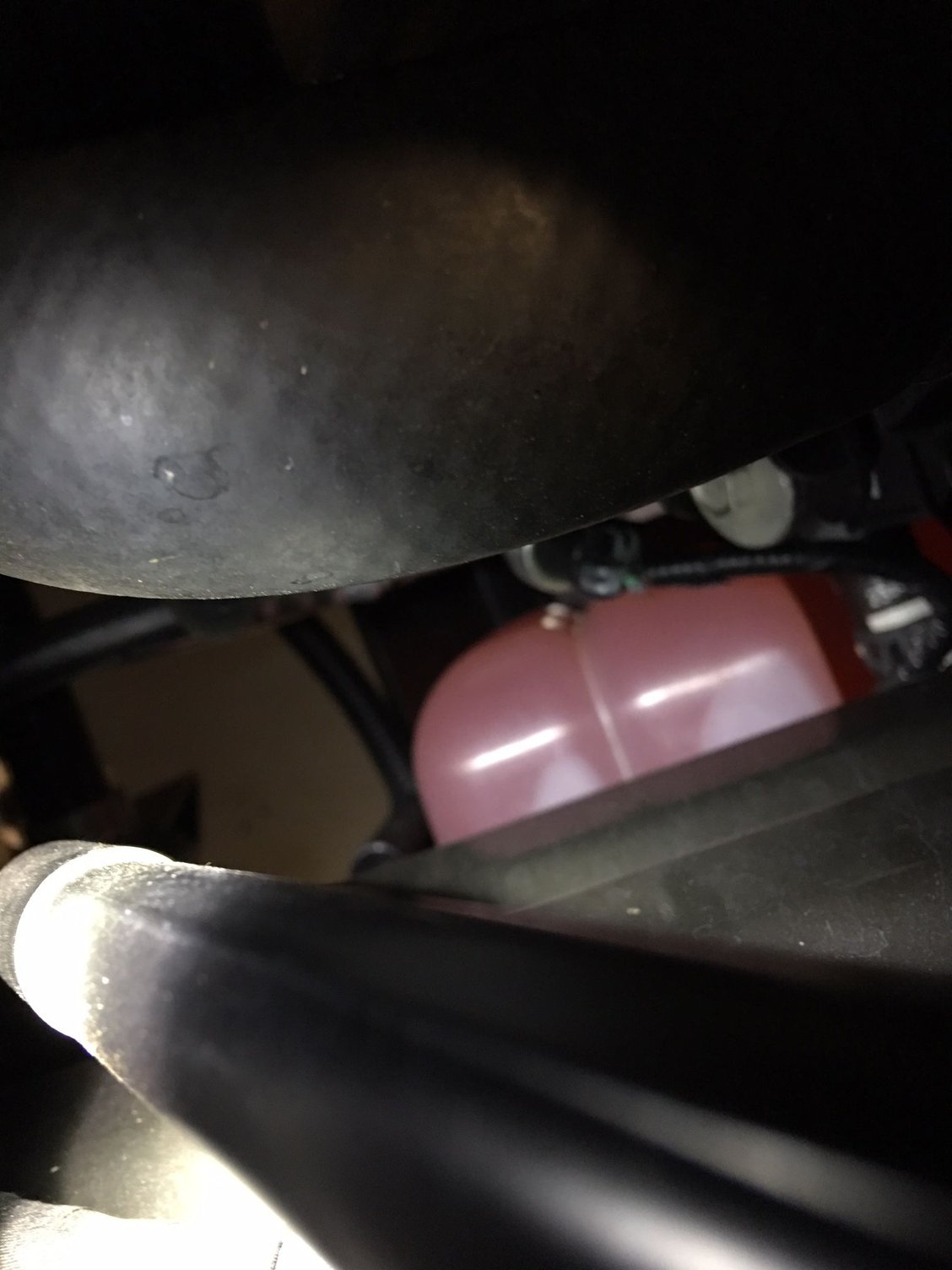

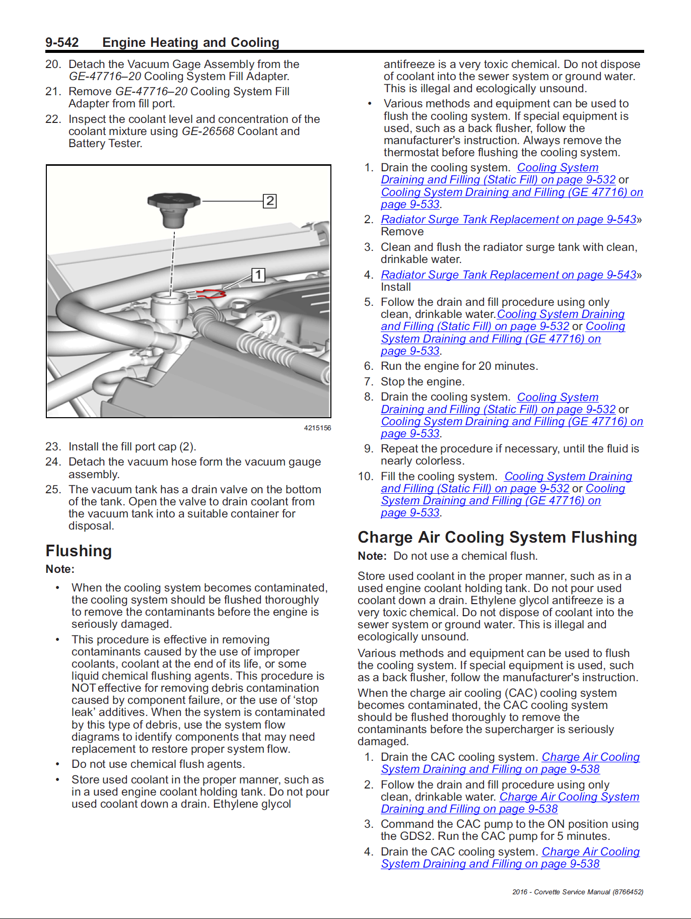

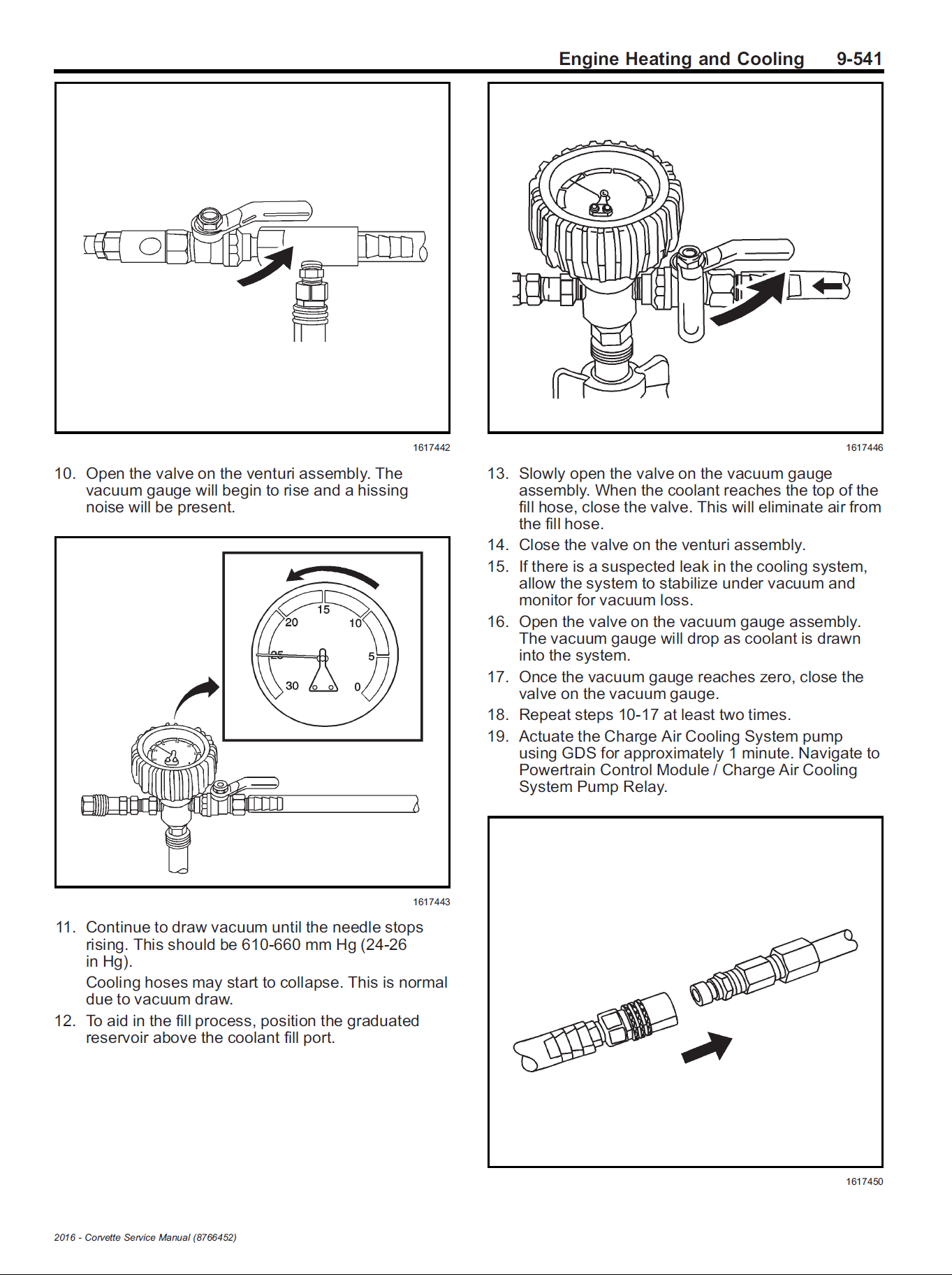

The LT4 engine has two different cooling systems. The engine cooling system and the charge air cooling system (intercooler). They are separate from each other. If you are changing the fluid due to the 5 year/150K mile maintenance requirement then you need to change both systems.
The engine cooling system is basically the same as the LT1 while the Intercooler is more complicated. To drain the intercooler you will need to remove or partially remove the right front inner wheel well to gain access to the drain plug at the bottom of the intercooler reservoir. You will need to use a vacuum fill tool to get the air out of the charge air cooling system. For proper performance, the air gap at the top of the intercooler reservoir must be much smaller than the air gap that was there from the factory. There should be no more air at the top of the reservoir than two air bubbles the size of two US quarters. You can see the reservoir from under the hood by looking down forward of the air cleaner and outside of the hood rod. It is hard to get the air out of the system and it can take several hours of pulling a vacuum and refilling and running the pump motor for a minute or so each period of vacuum.
Here is my reservoir after the dealer mechanic spent a couple of hours bleeding the system per instructions from GM Engineering.
We couldn't get the air bubbles any smaller when using the ZR1 intercooler bleeding tools which Engineering said should be used. After we sent pictures to Engineering they thought the amount of air remaining was OK and that my on track high speed (150+ mph) power reduction issues would be resolved.
Remember that you can't use a 50/50 premix coolant in either the engine or charge air cooling systems. The C7 ratio is 60/40. 60% water and 40% antifreeze. Be sure to use DexCool Orange coolant.
I am attaching pages out of the 2016 FSM that show how to gain access to the drain port and use the original bleeding tool that was superseded by the ZR1 tool set.
You need to have the car hooked up to a battery charger that can provide sufficient current to run the charge air coolant pump while flushing the intercooler cooling system. If you don't you stand a good chance of draining the vehicle battery.
Bill
