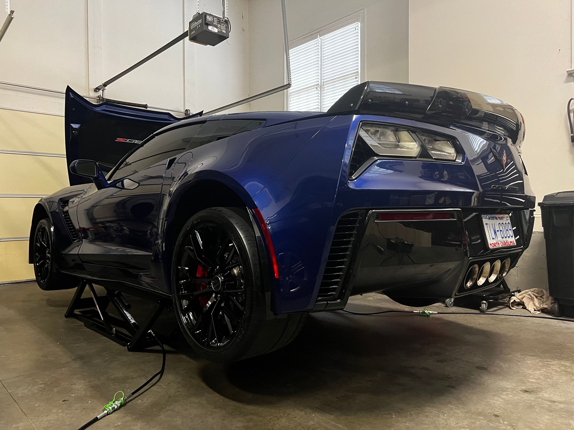

hey just wanted to confirm if the 7000tl version fits the my 19z. After measuring the puck spread of the car , it was too close together compared to the 7000tl min spread. 37 inches min. And I got 36
Old Sep 25, 2023 | 10:49 AM
JoeCT's Avatar
JoeCT
Joined: Dec 2014
Posts: 270
Likes: 108
It fits but with the rubber blocks as far toward center as the quickjack allows, the pucks are about 90% on the blocks and 10% overhanging toward middle. Not ideal and it’s disappointing but it seems quite stable. It’s just a little more tedious to get it aligned. 5000TL is the same. I wish there were a solution to make sure the pucks are completely on the blocks.

There is a good video on youtube using a quickjack 7000 on a C7 corvette

Yeah, none of them will go small enough for Corvette... I agree, I found out once I tried first time to put C7 on it. I have tried the sideways option they show on their site, it works fine, but depends on what you need access to under there.

Definitely a close fit, but they work.
Made me nervous enough that I put some jackstands under the QJ’s just to be safe.

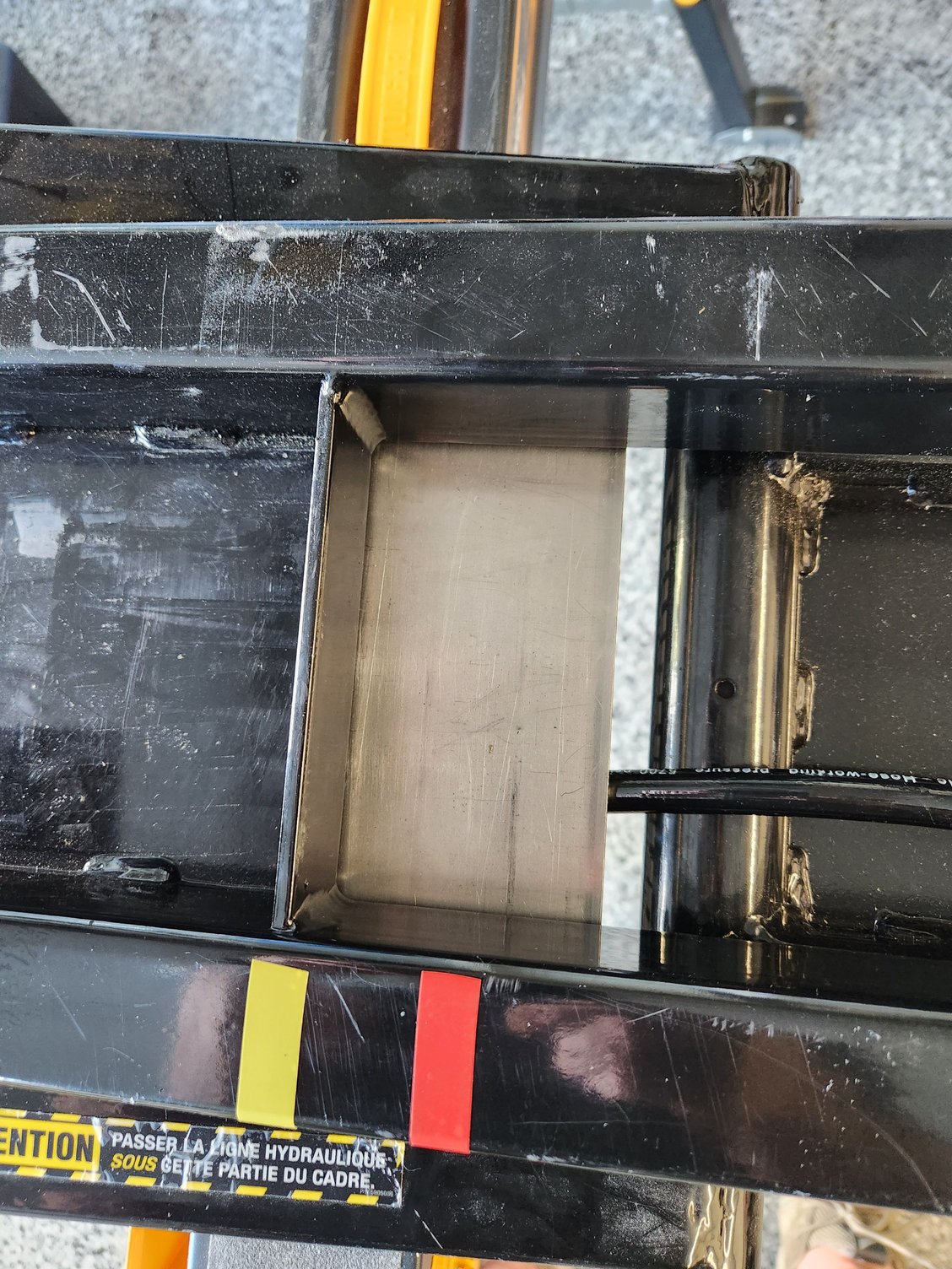

After struggling for 3 years with the Quickjack 7000 under my 2017 Z06, I finally fixed the problem. Bolted 3" x 1/4" steel flat bar to the bottom of each. Welding would be better, but I used four 3/8" bolts and tapped the Quickjack frame. Works great. Leaves just enough clearance for the hose.
Can you share any more details about how you bolted these plates on? What size thread tap/bolts did you use?

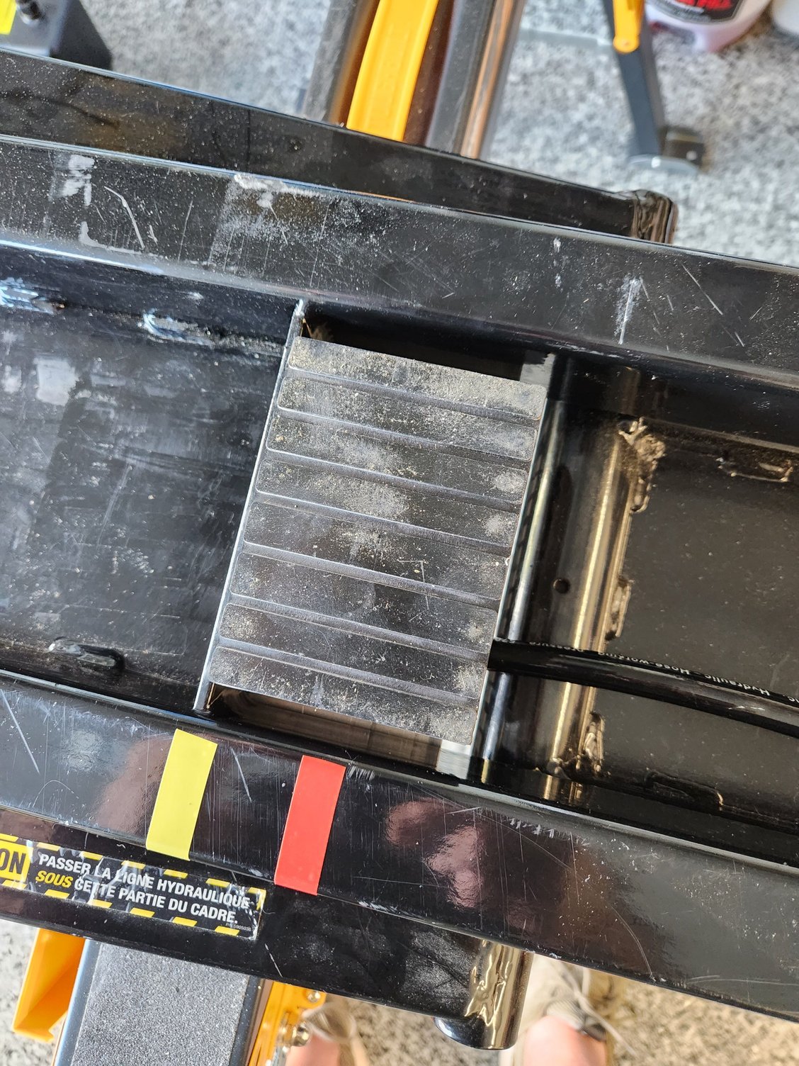

The first pic is the bottom side of the Quickjack. Note you must correctly locate the short hose mounted to the Quickjack before bolting or welding the plate.
I was shooting for overkill on the bolts. Chose the largest 3/4" to 1" long flange head hex bolts Lowes had in grade 5 or 8. These are 3/8" diameter, not sure what thread pitch. Bought a tap to match the bolts.
Have used them several times since the fix without issue.
