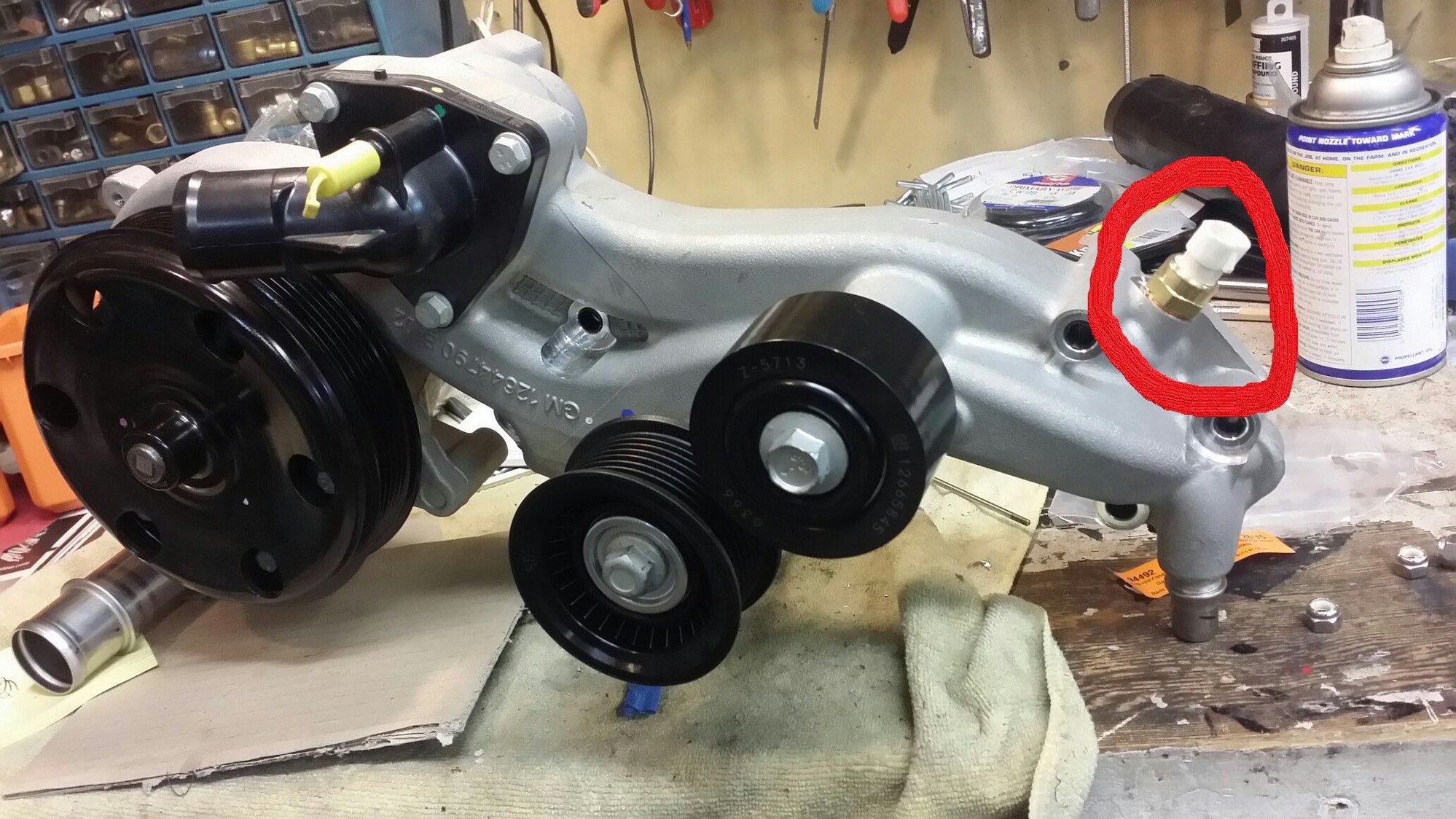

Thanks. This was one of the only pics I could find of a Gen V LT4 and i wasn't sure that was it (circled in red)
Yes that is it.
Different location than on the LT1/Stingray.
If you are troubleshooting a temperature control/fan issue be prepared to change the thermostat as well.
My experience is about a 50% success rate getting it right the first time. Symptoms and code are often the same.
Good luck.

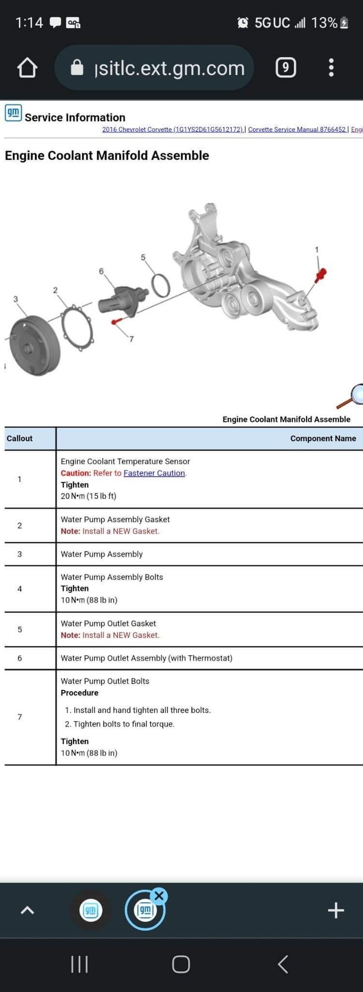

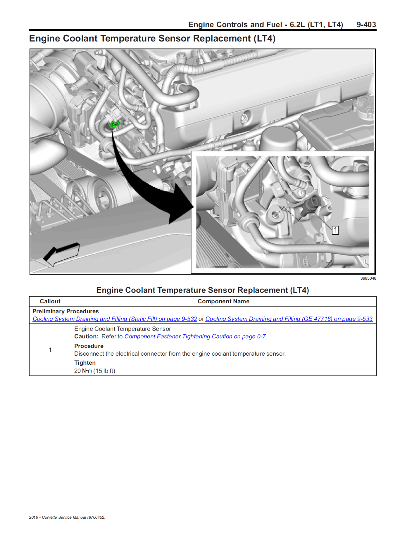

From the FSM:
Bill

From the FSM:
Bill
Yep, thank you. After a little more research (and a call to a buddy that's a tech at a dealership in TX) I was able to procure this bad boy.
Thanks for the help everyone.
