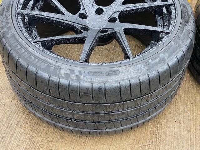

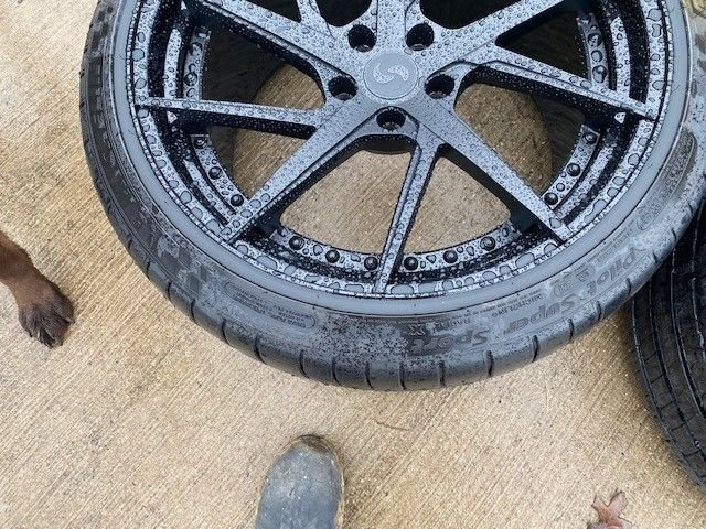

Bought new 21” wheels for rear and put 325-30/21 on
the wheel sticks out further than the tires does. It is driving me crazy, the fronts are 20” and tired are flush like they should be. The 325’s are the same size I had before but I had continental extremes, wonder if it is the tire manufacturer?
FORGOT TO ADD PICS SORRY

I have not mounted these yet, so offset is not a concern right now. I am more worried about how the tire looks like it does not fit the wheel. The tire is not flush with the wheel face, it sits back about an inch from the face of the wheel, see pics I added.
width is 12"

That sure doesn't look like a 325 tire on a 12" wheel.
It's time to actually measure stuff.

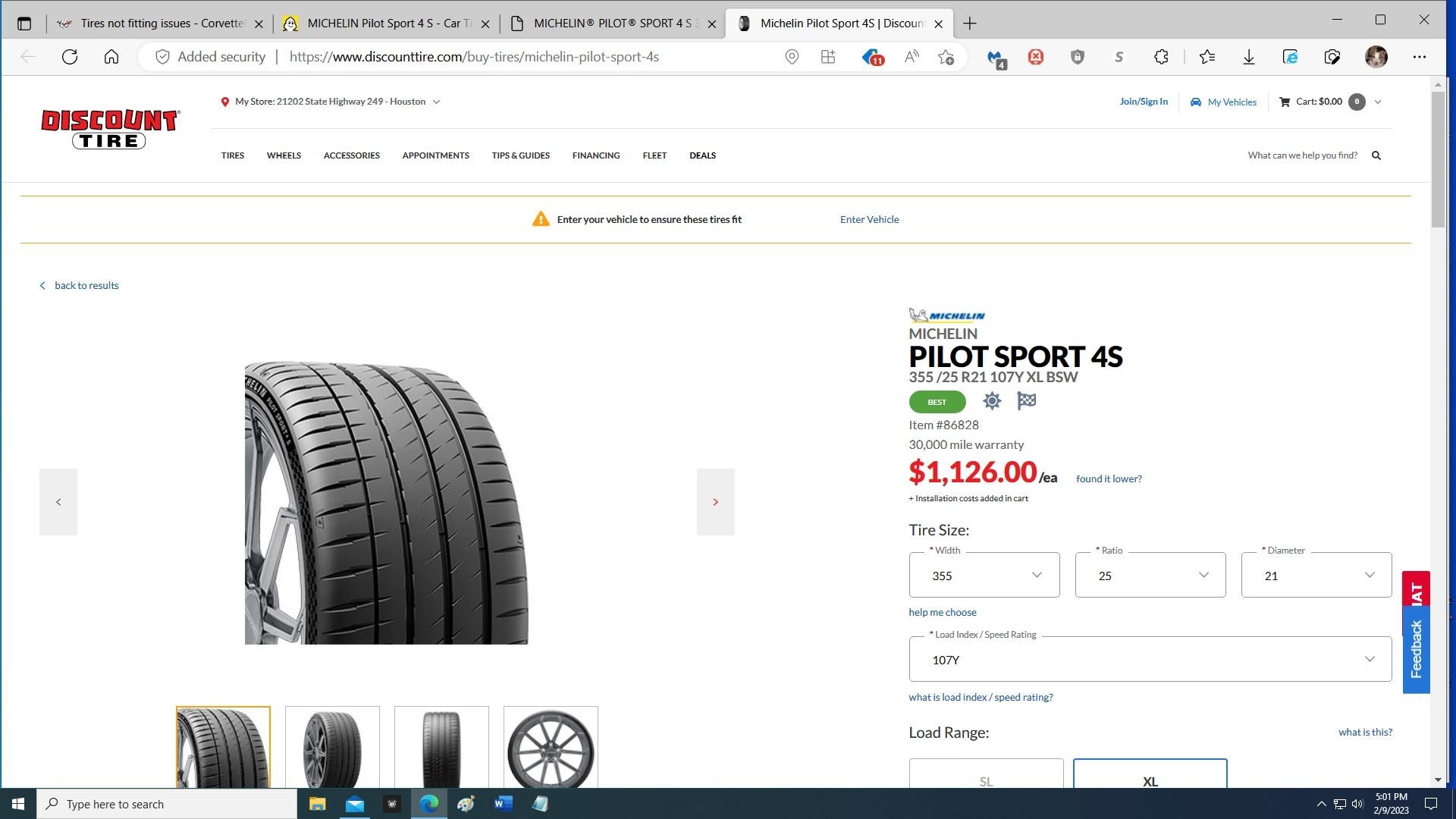

Here ya go, 355/25 - R21 should be nice and wide. Michelin, Pirelli, and Toyo offer tires in that size.
