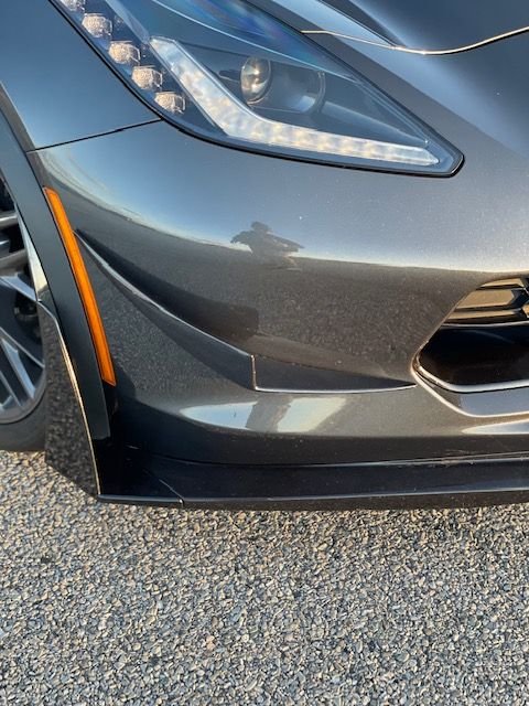

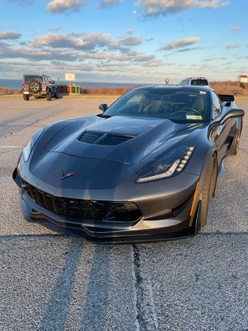

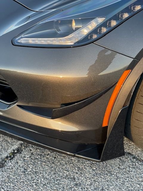

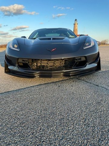

Installed these dive planes from Darwin Pro using double stick tape (3M) and 3 rivets per.
The fit up was a bit of a challenge but I think the end result looks good and aggressive and with any luck might function well in conjunction with the stage 3 rear splitter wicker bill extension.
All held up well after a romp out to Montauk Pt.!
Next test NJMP this weekend.
Thoughts appreciated.

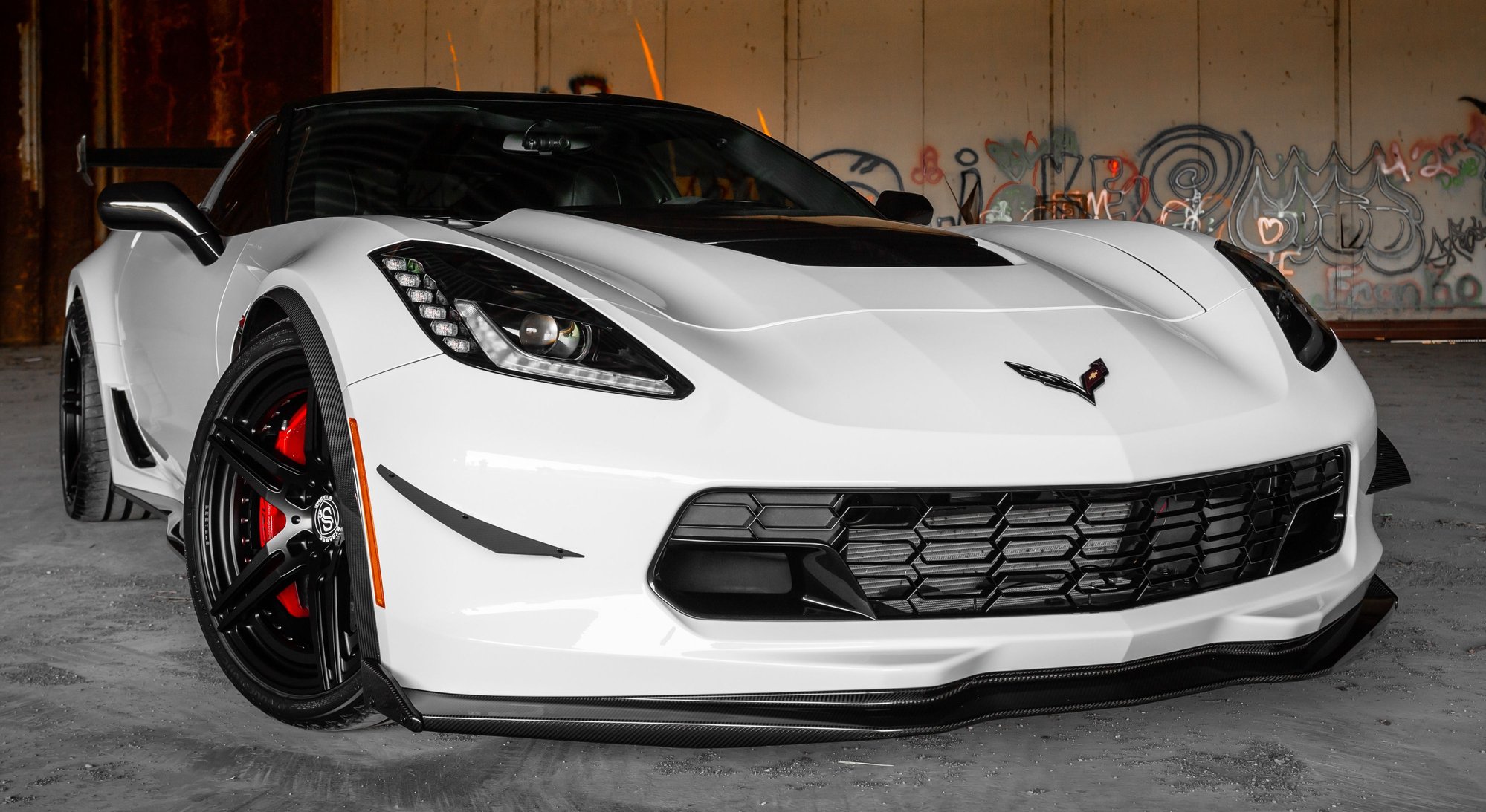

I have them on my car also, except mine are carbon fiber. I love them !!! You'll fine people either love them or hate them. I love them !!!

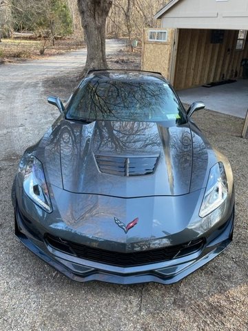

I like!
Made my own carbon fiber version....

How effective they are will probably depend on the airflow over them. There may not be a lot of airflow around the side of the front fascia in that area. You may need to stick small strings along the side of the facia and have somebody take a picture of them as you drive by at high speed so you can see if the strings are indicating airflow in that area.

DaWelda, My Friend, You already had "dive-planes" on the front of your car! What do you think those big scoops are on each end of your front "spoiler"?
