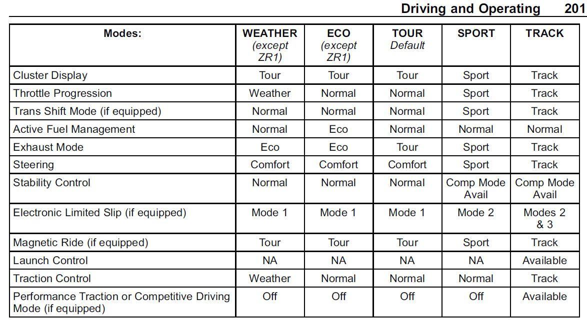

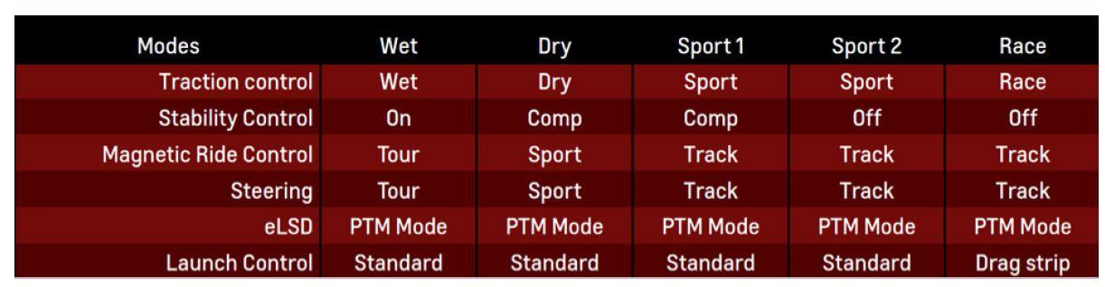

Mag ride, throttle progression, stability control are always linked to drive mode set by the rotary ****. Steering, exhaust, and dash display can be set to stay in Tour, Sport, or Track or Link (change with the rotary ****). Steering and exhaust selection is on the infotainment settings screens, dash display is set using dash menus and steering wheel buttons..
I keep steering, exhaust, dash, and HUD set to Track all the time.
Nannies change with the mode and Track submode. Track by itself is not defined. For Mag Ride equipped:
The Owner's manual is your friend!
