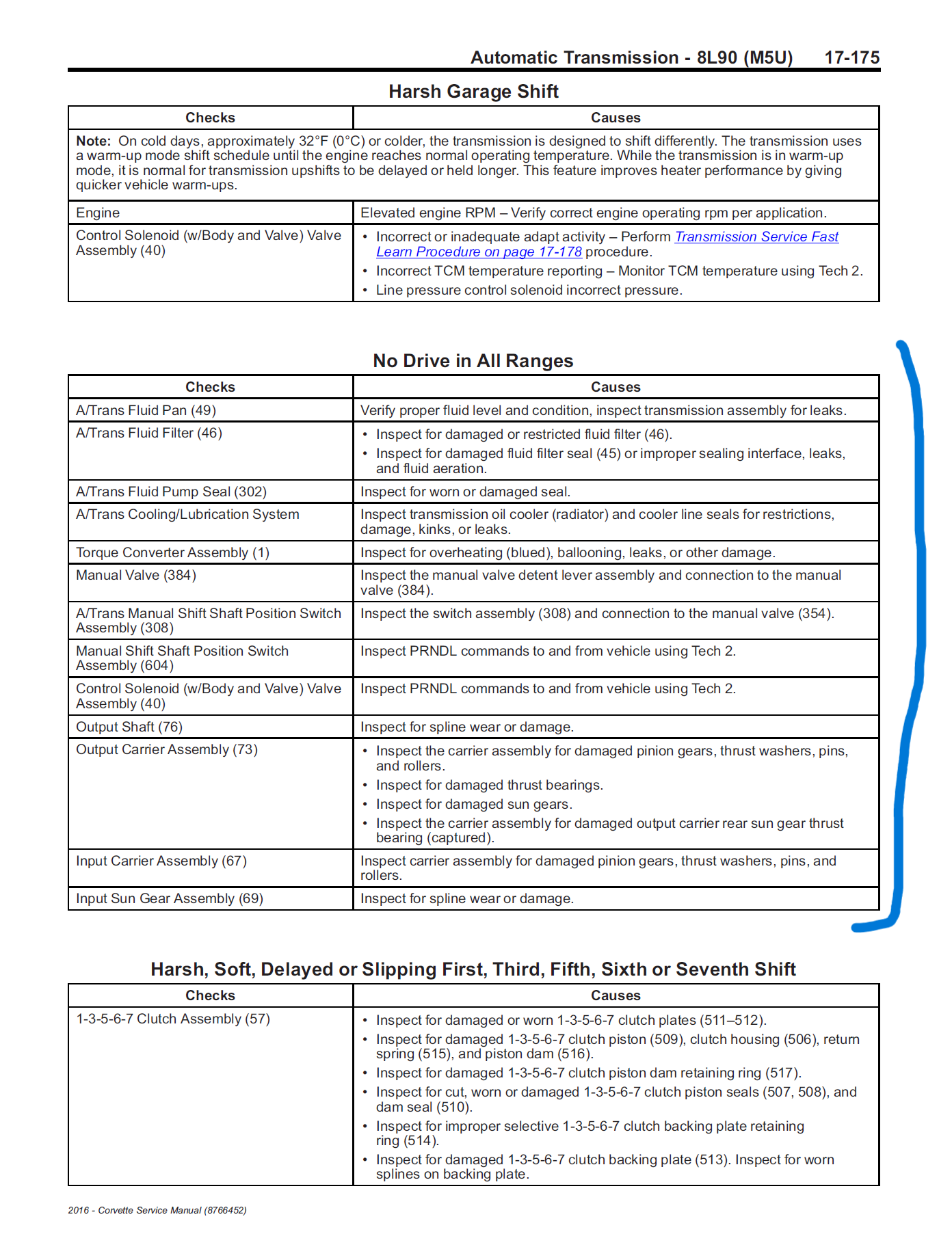

P0700 is an Informational DTC. It just tells the mechanic the ECM has a code that tells it there is an emissions-related code in the TCM. There are several emissions-related TCM codes and your scanner should have listed those along with the P0700 since P0700 wouldn't exist without the TCM codes being active.
With P0700 being active in the ECM you should see one or more of the following codes (highlighted with blue marks) in the TCM:
Bill

The bottom line, 0700 means the brains in your tranny detected something not functioning properly. Anything is possible...i.e. limp mode, or in your case, no mode, as the tranny attempts to protect itself until it is repaired.
The code is likely still there. Initially a code is logged in temporary memory until it repeats. It then turns on the warning light and registers in the permanent memory. Most cheap readers only read the permanent codes, not the temporary. Better readers will read both memories. You have cleared the permanent memory, but, like I said, the code is likely still logged in temp and will recur to a warning and code after a few attempts to drive the car.
Other than checking for loose connectors and fluid level, repair will not be novice level...sorry...
