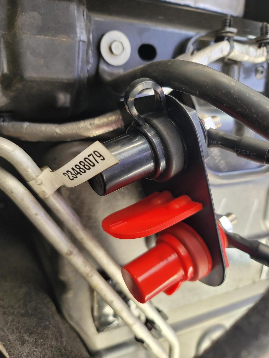

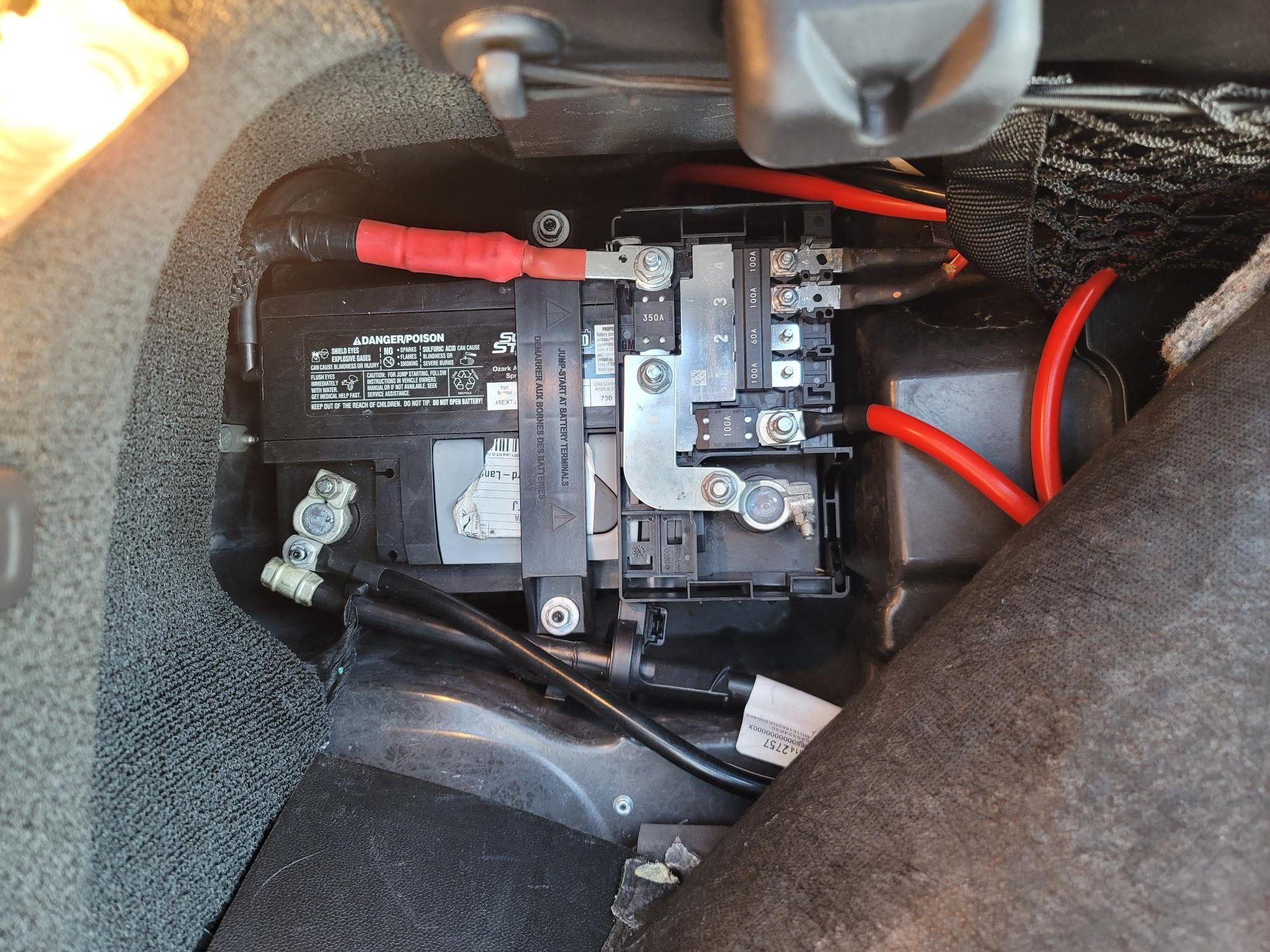

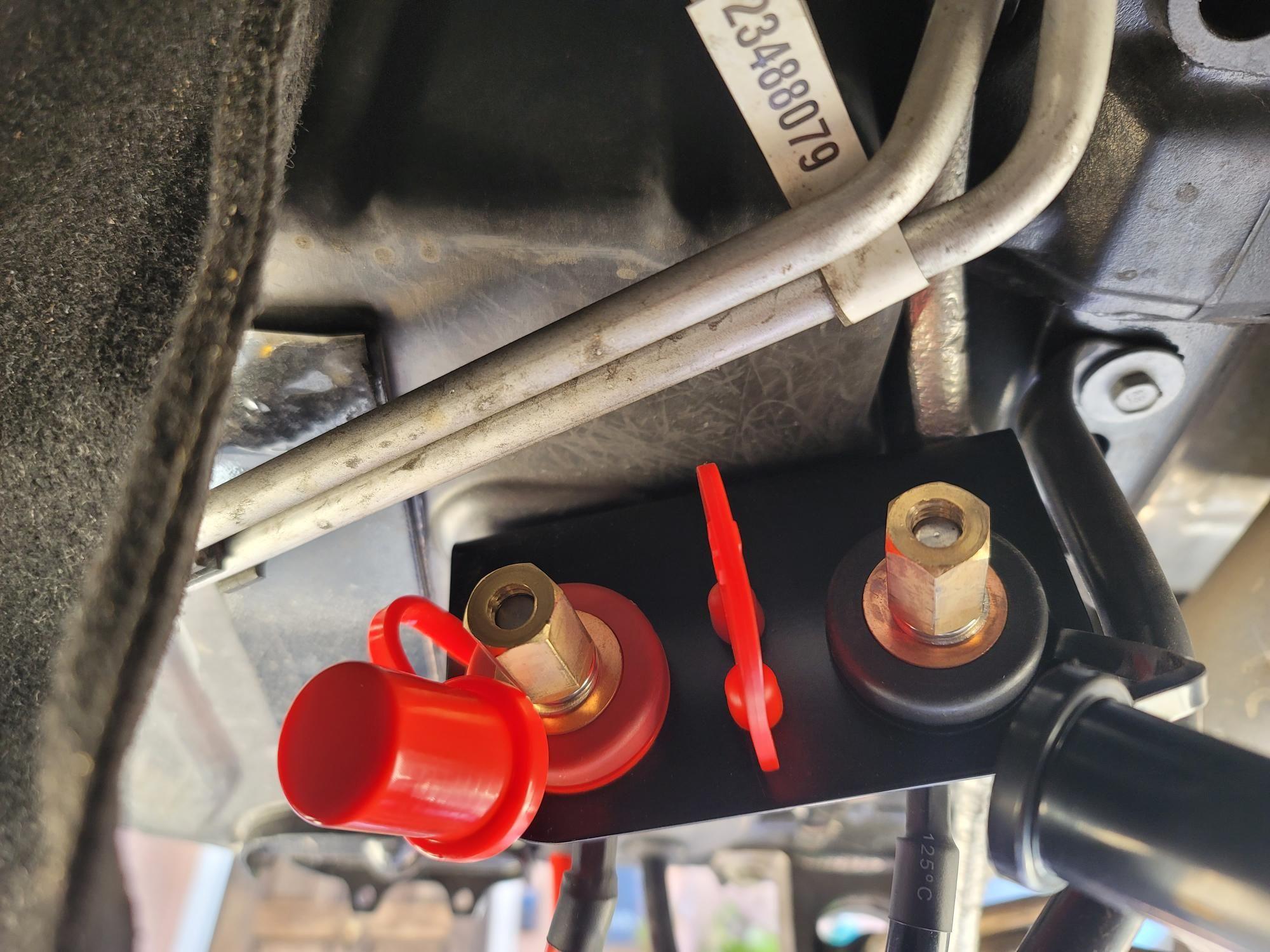

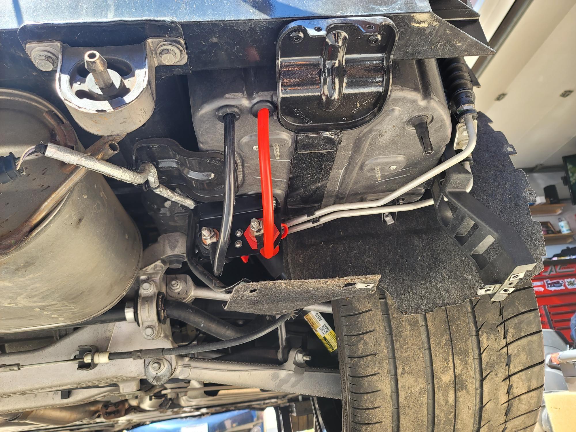

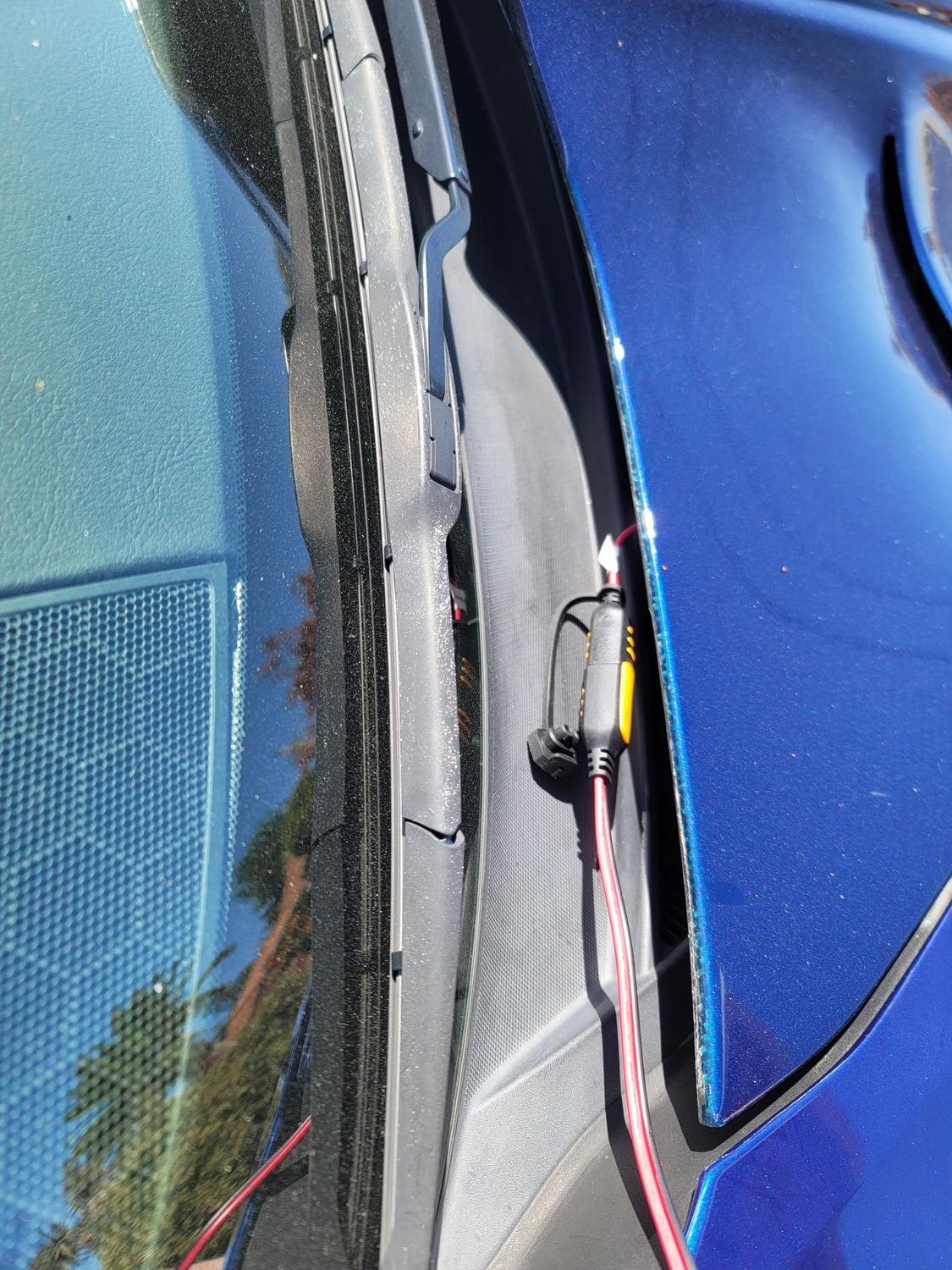

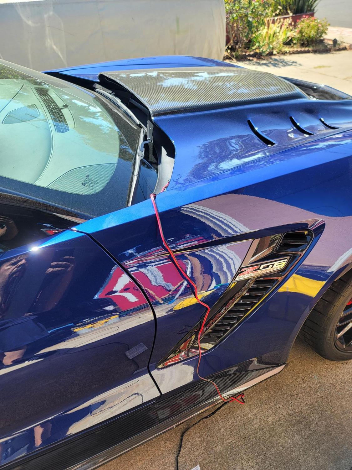

So, let me start by saying thanks to the forum for helping me get in my car. I went on vacation, and when I came back, my Z06 was utterly dead. When I tried to use the key to open the trunk, I discovered the drum for the key was gone, so I searched the forum on what to do, and fortunately, I read you could jack up the car and charge the battery using the starter positive cable and what do you know it worked. So, after gaining access to the battery, I decided to do some modifications to make it easier next time. First, I fixed the truck's key, which had fallen out, and then I added my own battery jump studs under the car. I also moved the battery tender connection to the front. Here are some pictures. I hope it helps someone.

You plan to jump through a 100 amp fuse on top of the battery? Not sure the fuse will hold in all circumstances...

I like the location of the battery tender connection. Are there any issues with using that connection?
Ron
Yeah, thanks Ron, That one was a spare I already ordered a 500amp fuse for it,

@Dave McDufford I checked the wiring and that post is a constant 12v source from the battery so it should be ok.

I connected my battery tender with alligator clips at the rear stud on the underhood fuse box for years. I propped the hood open a bit with a roll of paper towels on each side so I had a visual indication that the hood was open and the charger was connected.
I now use the lighter plug in the trunk.
