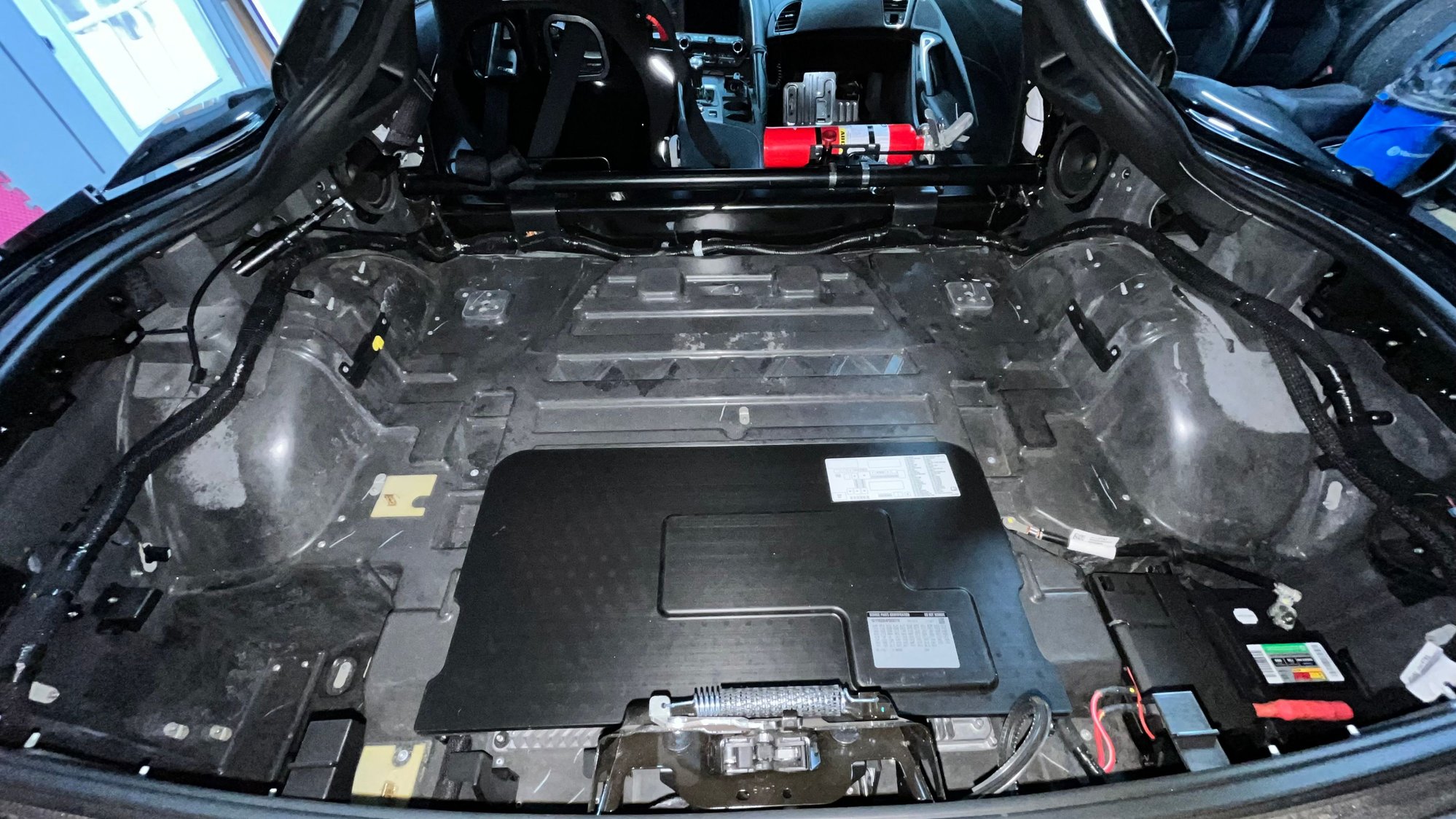

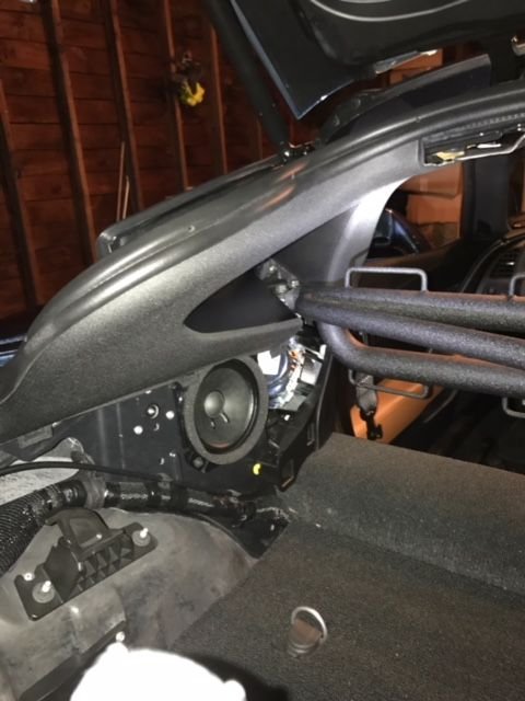

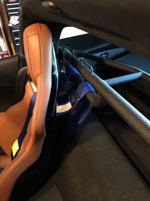

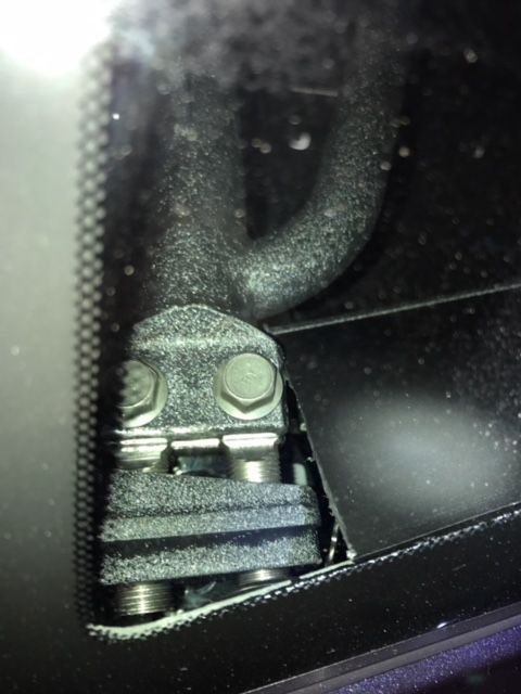

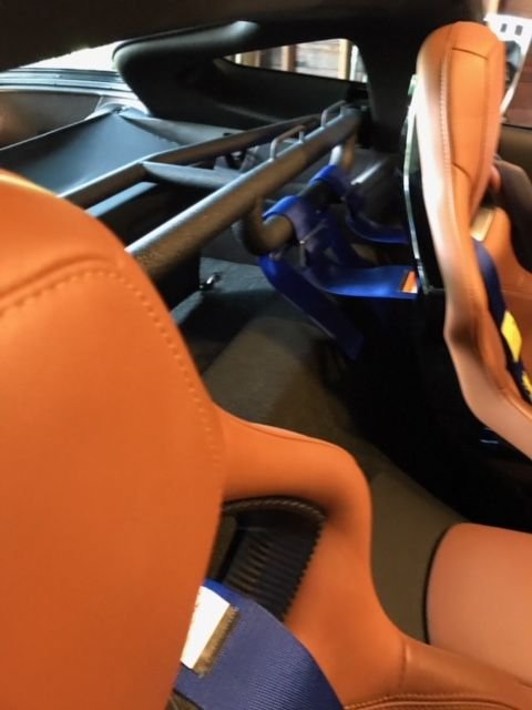

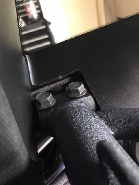

There are two harness bars that you can choose from. They will both work with the stock Competition seat but not the GT seat. These are the BK Auto C7 bar and the lap belt mounts (https://www.bkauto.com/category_s/332.htm ) and the Shark Bar ( https://vetteworksonline.com/catalog...roducts_id=199). The Shark Bar is mounted low and close to the vertical panel behind the seat. It meets the harness manufacturers' mounting recommendations for no more than a 20-degree down angle with the shoulder belts. However, the comp seat pass-throughs are placed about 4 inches lower than those in a regular race seat which complicates usage. If you are approaching 6 ft in height you will need to mock up the bar and belt paths to see where they fall when you are sitting in the seat. The following picture shows what happens when somebody is over 6+ ft tall and attempts to use the shoulder belts. In between the belt's mounting point on the harness bar and the contact point with this person's shoulder, the seat pass-through interferes with the belt's path and bends the belt down. Thus the seat becomes part of the harness and may fail when a hard impact occurs. If you have this situation you need to go with a race seat or continue to use the stock 3 point belts while making sure you use the Corvette's Belt Cinch feature.
The BK bar has two cross bars with one mounted low and the other higher. The low bar is to be used if you have a comp seat while the high bar can be used with a race seat. If you think you might eventually move to race seats this would be the best bar to purchase although the mounting points leave something to be desired from a looks standpoint.

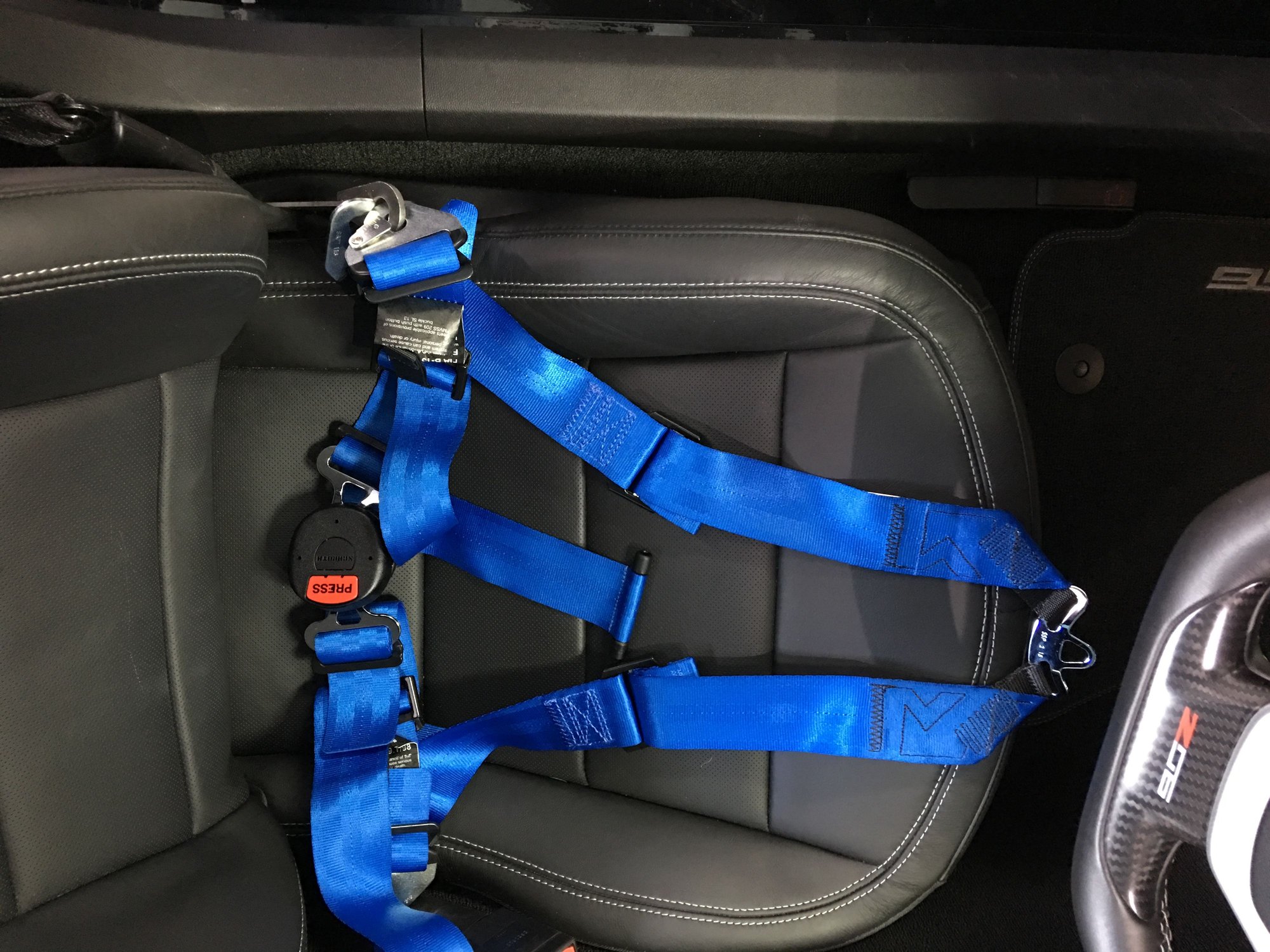

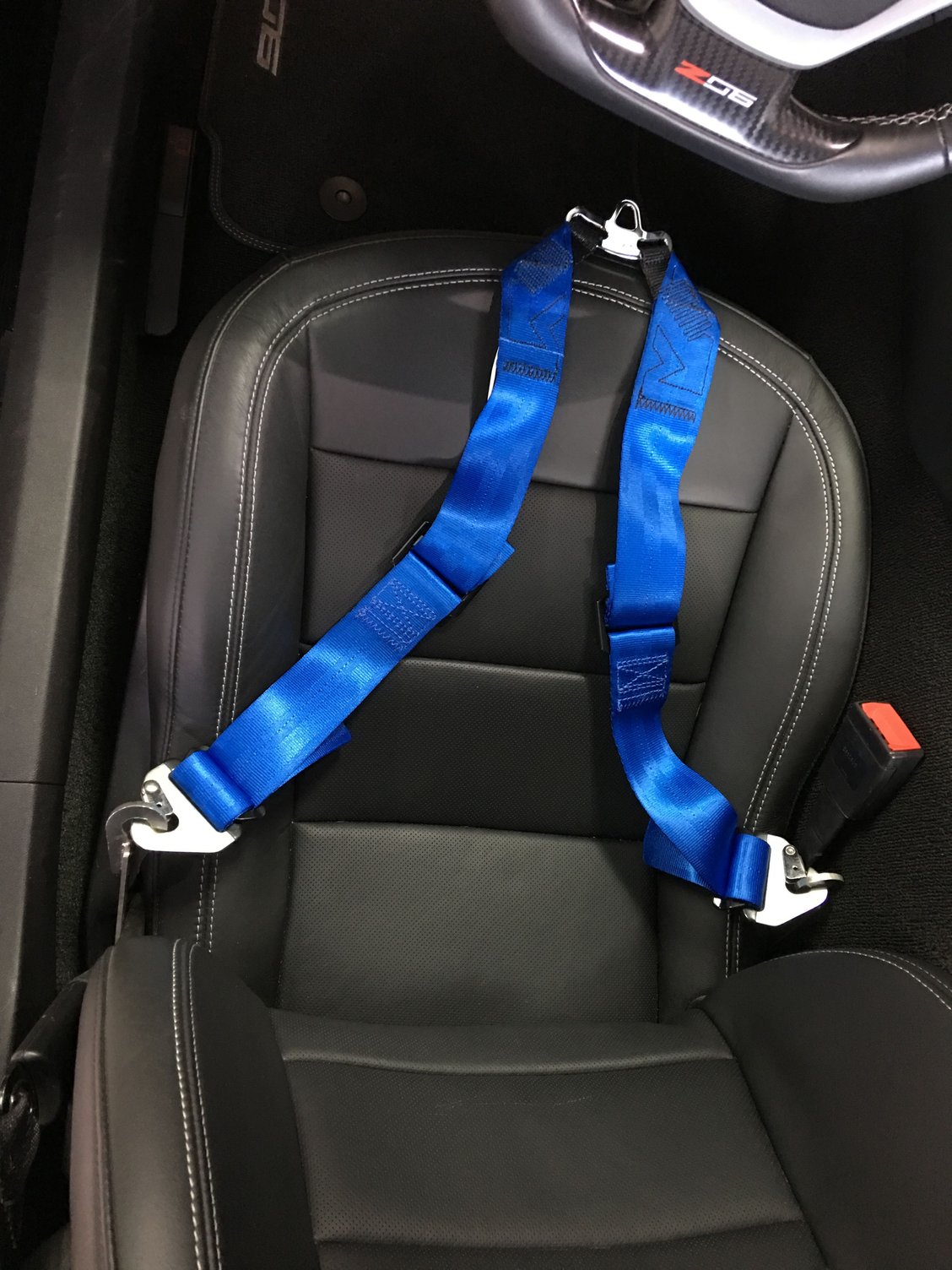

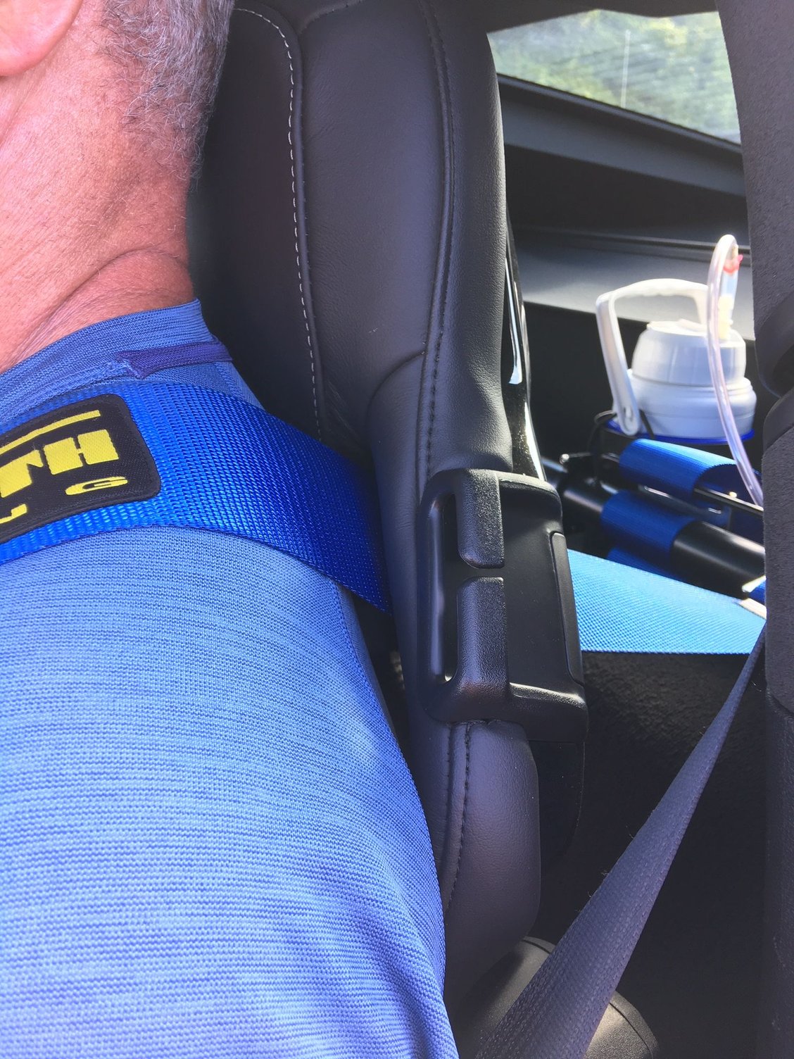

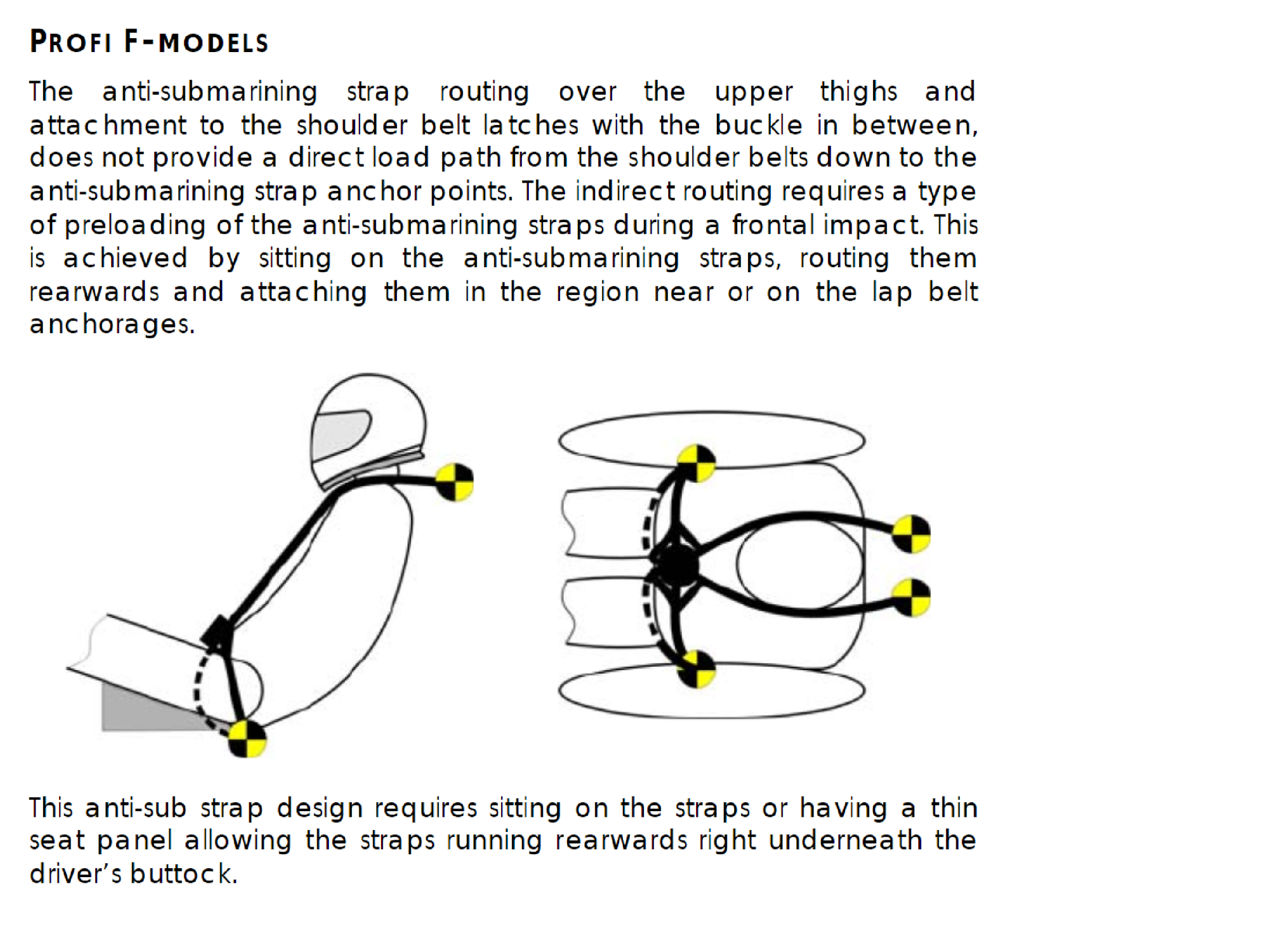

As for harnesses I use the Schroth Profi II ASM harness. The ASM harness resists submarining under the lap belt by making a 4-point harness behave like a 3-point during the initial phase of an impact which lets the upper portion of the body pivot over the lap belt before the second shoulder harness restricts forward motion. The harness will also let you add a 2-point sub belt if you want to have a sub belt for organizations that won't let you run the ASM. The BK Lap Belt mounts should be used with the BK Bar or the Shark Bar. You don't want to use mounts that mount the belts at the rear of the seat. You can install the sub belt to the lap belt mounts and use it in a Formula configuration where the occupant sits on the belts or have an upholsterer add a sleeve through the seat bottom (at a crease) and fasten the sub belt to a cross bar that is part of the seat track.

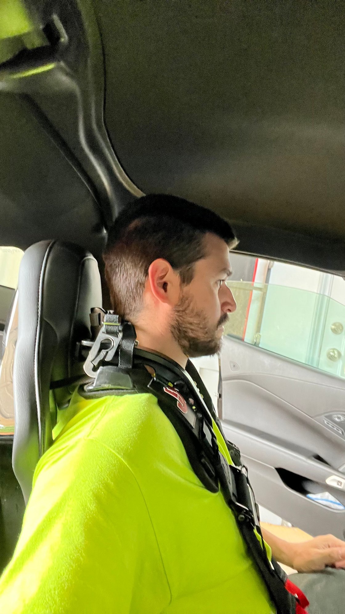

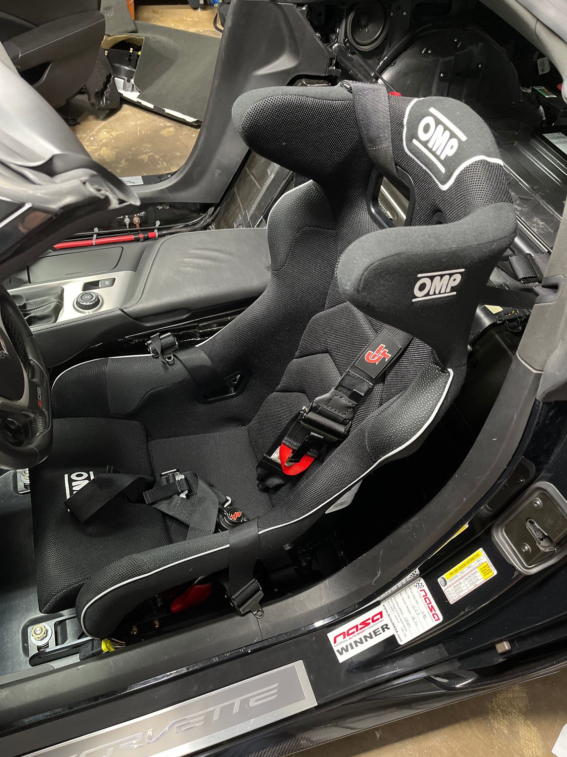

As for wearing harnesses Vs the 3 point belts. There are a lot of myths about roll overs and the first one is how often they happen. The occurrence is very rare. I have been participating in HPDEs since 1992 with thousands of laps and many days at the track. I have only been at 3 HPDEs in 31 years where a car has rolled over. Second, the typical rollover injury and some films demonstrate this is a head injury due to the head being tossed sideways through the window and impacting the ground as the car rolls. Third, most Corvettes that roll without a cage have damage like this:
I witnessed this car rollover while my student was following it into T6 at the Glen. We were about 100 ft behind it when it climbed the tire wall and then flipped onto its roof, dropping at least 4 ft straight from the tire wall onto the roof. The A pillars are the parts that collapse but even on this car only the passenger side A-pillar collapsed. When I took this picture the hatch had just been opened. The owner had the car towed about 300 miles home but I might have been tempted to drive it home when it was dark. The passenger side headlight could have been taped into place and the outside mirrors removed. The car was still drivable as none of the power train or the brakes had been damaged.
I have seen other pictures of C7s with the roof collapsed like the one in the previous post. However, there was a video with one of the pictures and it showed how the tow truck driver dragged the Corvette across the ground upside down so he could flip it onto its wheels. I suspect the dragging across the ground had some factor in the total collapse of the halo panel.
The truth is the odds are better if you have a harness that holds you in the seat from both a driving and a collision standpoint.

for future reference, at 6’1”, the shark bar worked for both comp seat and a OMP HTE-R 400 on AMT low profile seat mounts for me with no problems. Obviously it depends on torso/leg length, etc.
Old Mar 3, 2024 | 01:51 PM
Bill Dearborn's Avatar
Bill Dearborn
Joined: Oct 1999
Posts: 41,055
Likes: 9,817
Originally Posted by brakebias
I'm trying to visualize this. So the sub belt connects to the BK lap belt mounts and runs through the gap between the seat back and seat bottom, and the driver sits on the sub belts?
I want to run 6-points, but want to retain the competition seats and don't want to create holes in them.
The BK lap belt mounts attach to the same points as the stock seat belts and are next to the seat Vs behind it. The formula mounting shown in the old Schroth Competition Instructions shows the lap belt and sub belt mounts are co-located as shown in this picture:
This is how they look when installed on the BK mounts in my car:
This picture shows the sub belts installed.
This picture shows the sub belt with the lap belts installed to the same mounts.
If you decide to go with mounting the sub belts behind the seat do not mount your lap belts there. They need to be beside the seat so they maintain the proper angle across your pelvis and they shouldn't wrap around the rear of the seat bottom, there has to be a direct path from your lap to the mounting point, the BK lap belt mounts provide a direct path. As for mounting the sub belts behind the seat be aware the space between the seat back and the seat bottom is very small and there is a chance of damaging the sub belts when they run through that space. The advertising picture on the website for the belt mount shows damage to the belt they used for the picture.
I sit on the sub belt, fasten it to the bottom of the cam lock and then fasten my lap belts and get them tight. Then I fasten the shoulder belts move the seat forward and tilt the seat back forward so I am sitting in a more vertical position which will tighten the shoulder belts. The lap and sub belts will remain as tightened before since their mounts move with the seat.
Bill.
