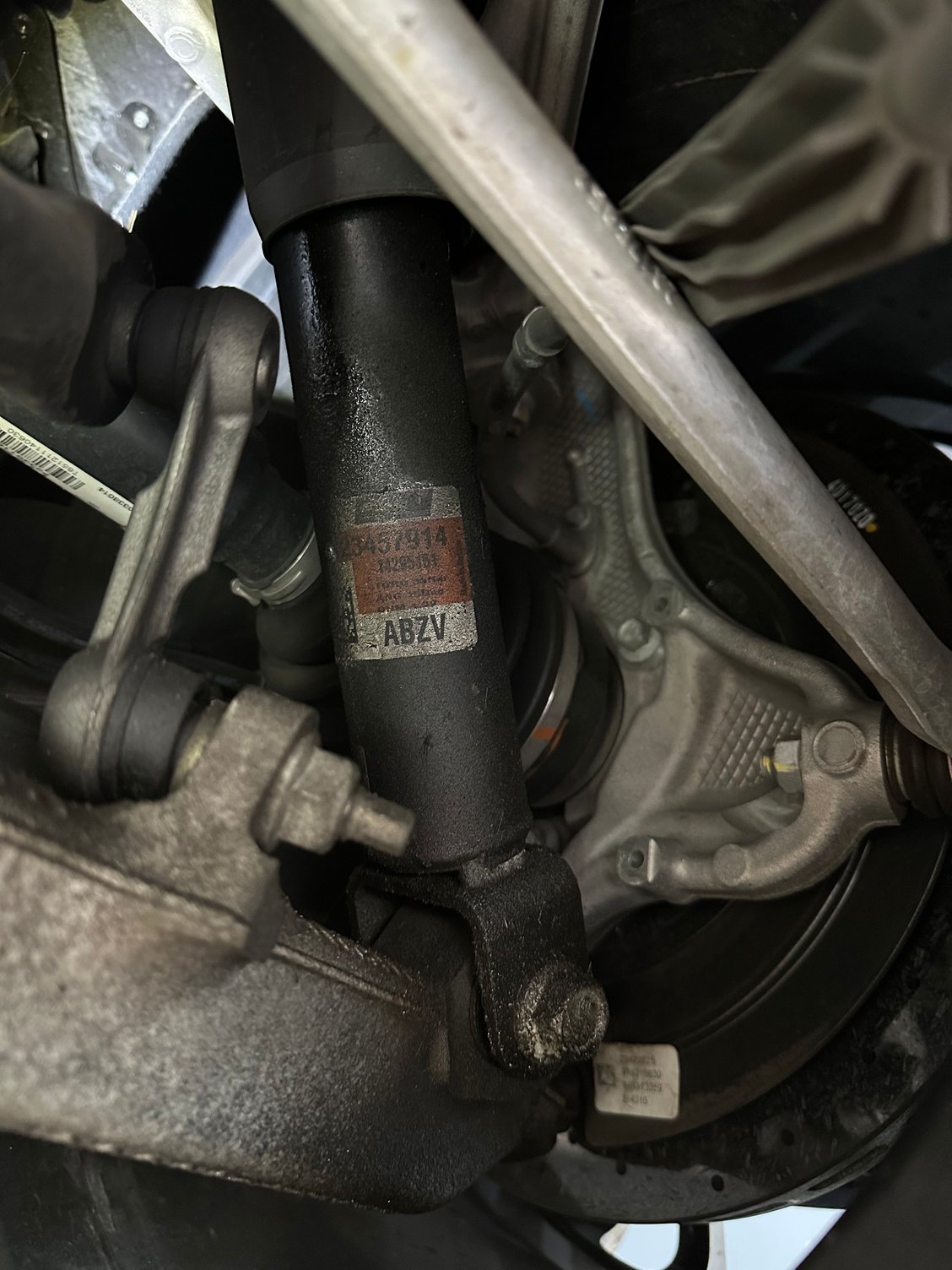

Here is a pic of a rear one… and upon closer inspection, only one in the rear is bad…the other one is perfectly clean

Does your car have the FE6 base Z06/GS suspension or the performance FE7 suspension that came on the Z07 versions of the car. The OEMs are about the best you can get unless you want to go with a more race oriented shock that also requires you to change the shock control module. The OEM shocks aren't cheap so you need to make sure they are truly bad. I am attaching the guide that GM uses to determine if the MRC shocks need to be replaced.
Depending on whether or not you have the FE6 or FE7 suspension the shocks required will change. GM Discount Parts dealers charge from $500 to $520 plus tax and shipping. Your local dealer parts counter can order the correct shocks based on the VIN of your car without any shipping charges and may offer an extra discount if you ask so they may become the low-cost supplier. Amazon has some aftermarket shocks that are available at about half the price of the wholesale GM shocks but you need to know which ones your car needs so that means talking to a dealer parts person and getting the GM part numbers.
