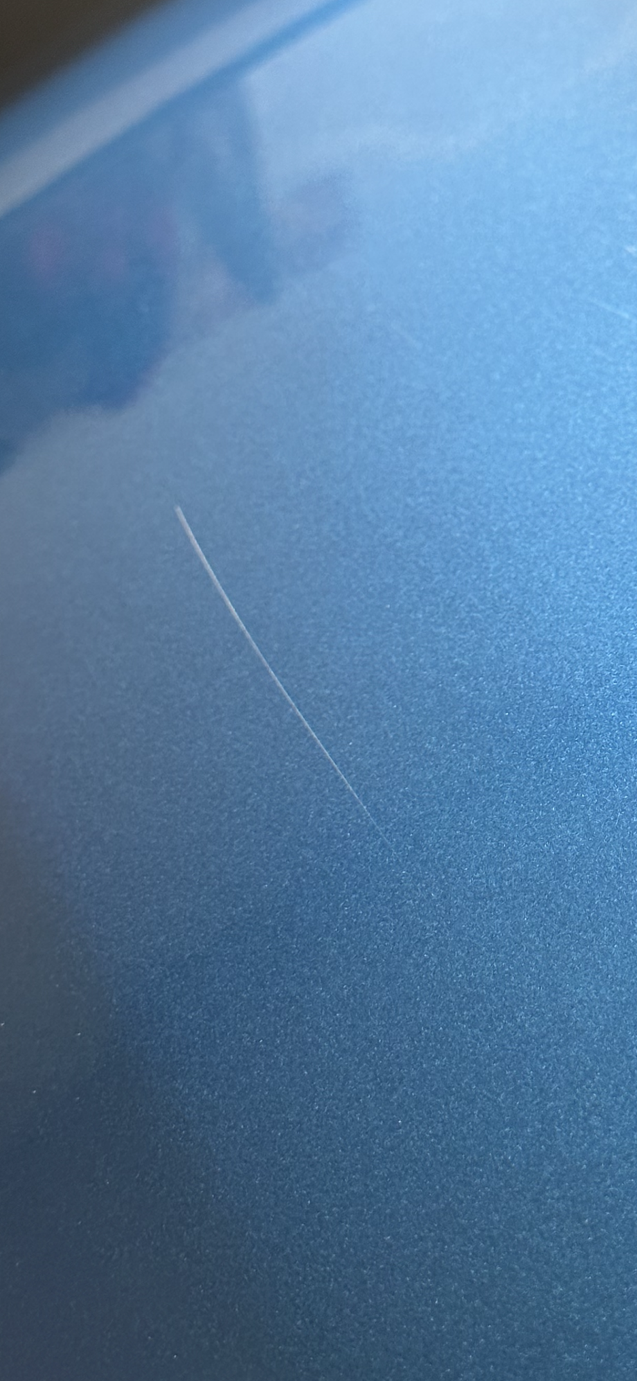

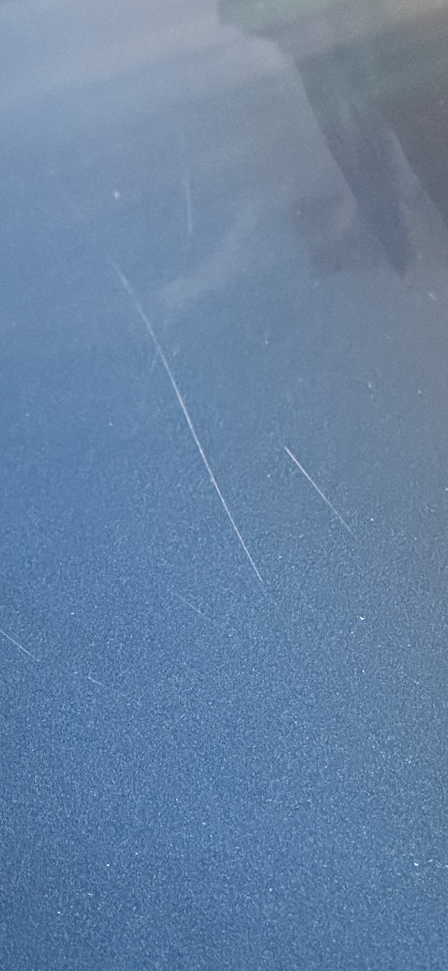

Picked up my new to me 2016 Z06
overall very happy
somehow did not see a number of scratches until I got it home and now that I see them I’m rather disappointed.
Trying to gather opinions on if this is something that can be repaired with paint correction.

A good detailer will be able to hide that somewhat but from the pictures I would say it’s not going to go away completely. The smaller ones yes but the 2 biggest scratches that stand out look too deep.

You'd be surprised what you can do with 2000-grit paper (wet-sanding), compound / polish, and a good buffer. The deeper scratches might not completely buff out but you'll have to look harder to see them. As was mentioned, lots of videos on YouTube....
