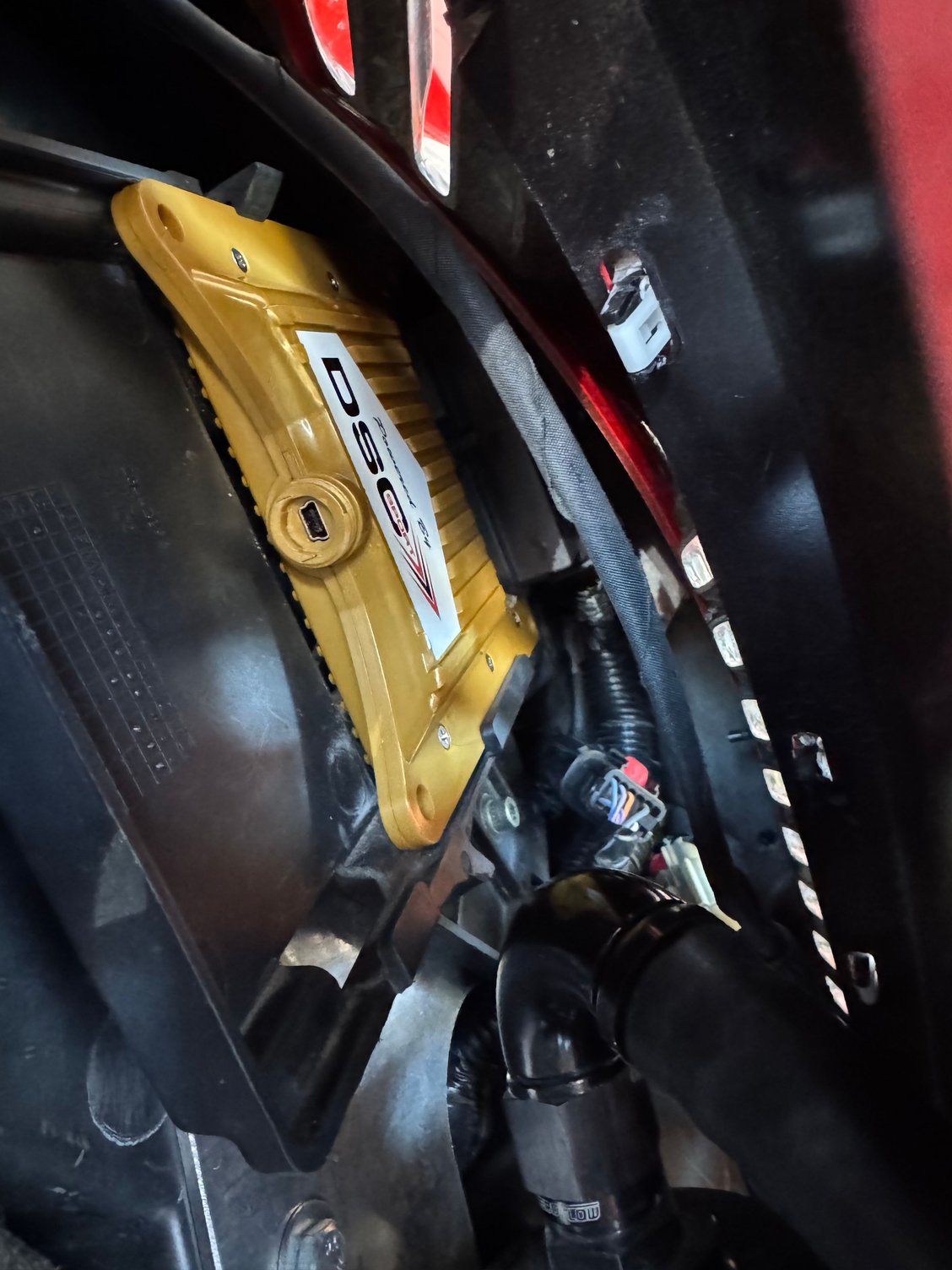

ok I picked up a used dsc controller. as we all know they are very reluctant to support their product in any way when its bought used. new they are fine but used they rarely touch. so im reaching out here for some guidance
1. what type of cable end is this?

@9sec,
Looks like you have a V4 version.
1. Cable (needs to be a 5 wire data cable)
Amazon Amazon

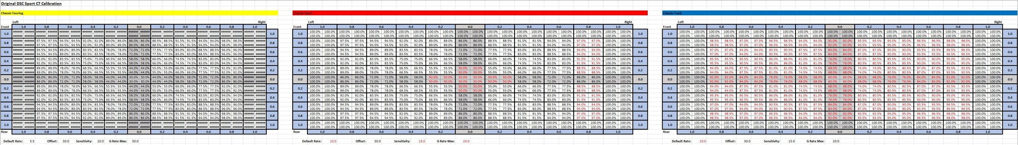

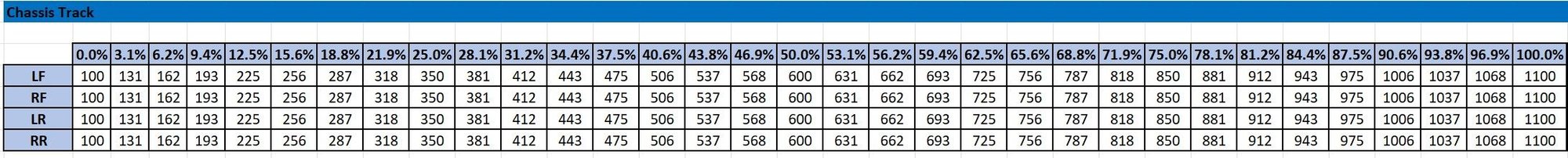

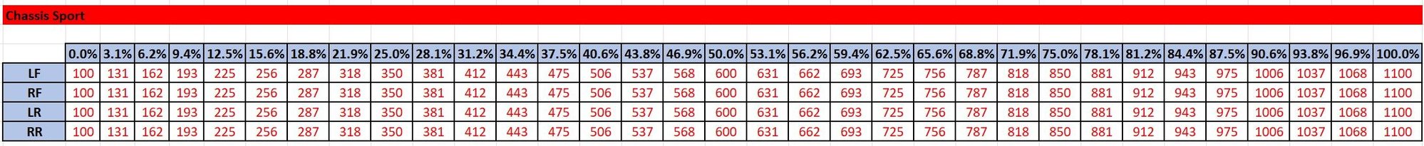

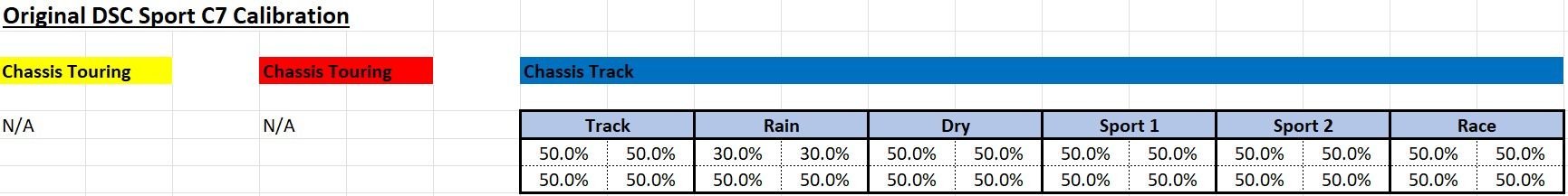

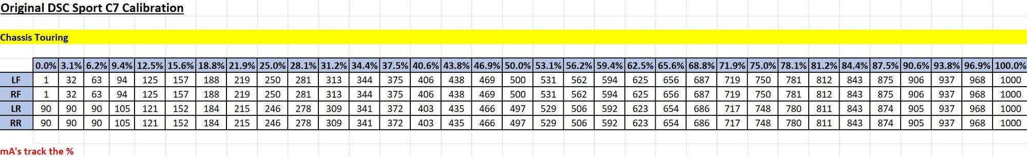

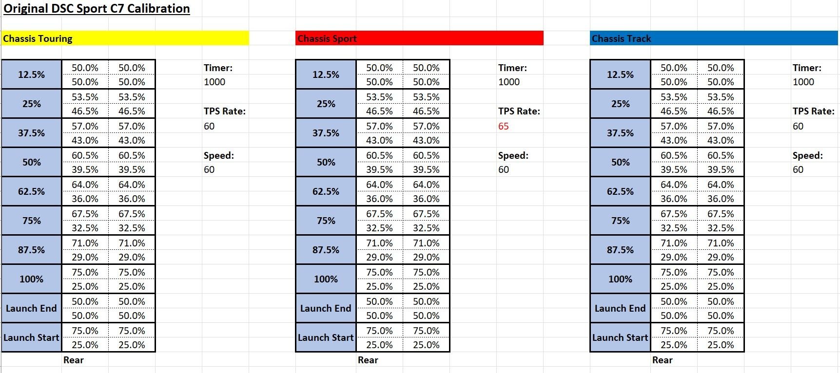

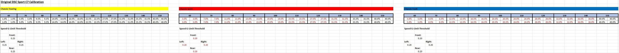

Original settings to check if your file has been changed.
Settings in red font are different from the previous suspension mode.
GForce
All #'s are 100.0
G Force
Brake
Accel
Speed
PTM
Shock Calibration
Velocity
GForce
All #'s are 100.0
G Force
Brake
Accel
Speed
PTM
Shock Calibration
Velocity
Did you type all that in or find a way to export the info? Just curious since that's a lot of numbers!
To the OP....I'd download what's in the controller now and save that as your base file. Then, "Zero" the ride height and go for a drive. Based on that drive or several drives you can decide what you want to change.
Old Feb 26, 2025 | 11:58 AM
westsdad's Avatar
westsdad
Joined: Sep 2020
Posts: 423
Likes: 390
From: CO
Didn't find a way to export that would save any time. Some typed in with a lot of copy and paste. Then compared with 2 ZR1 files and 3 files from forum members that were posted in the thread that I mentioned above.
