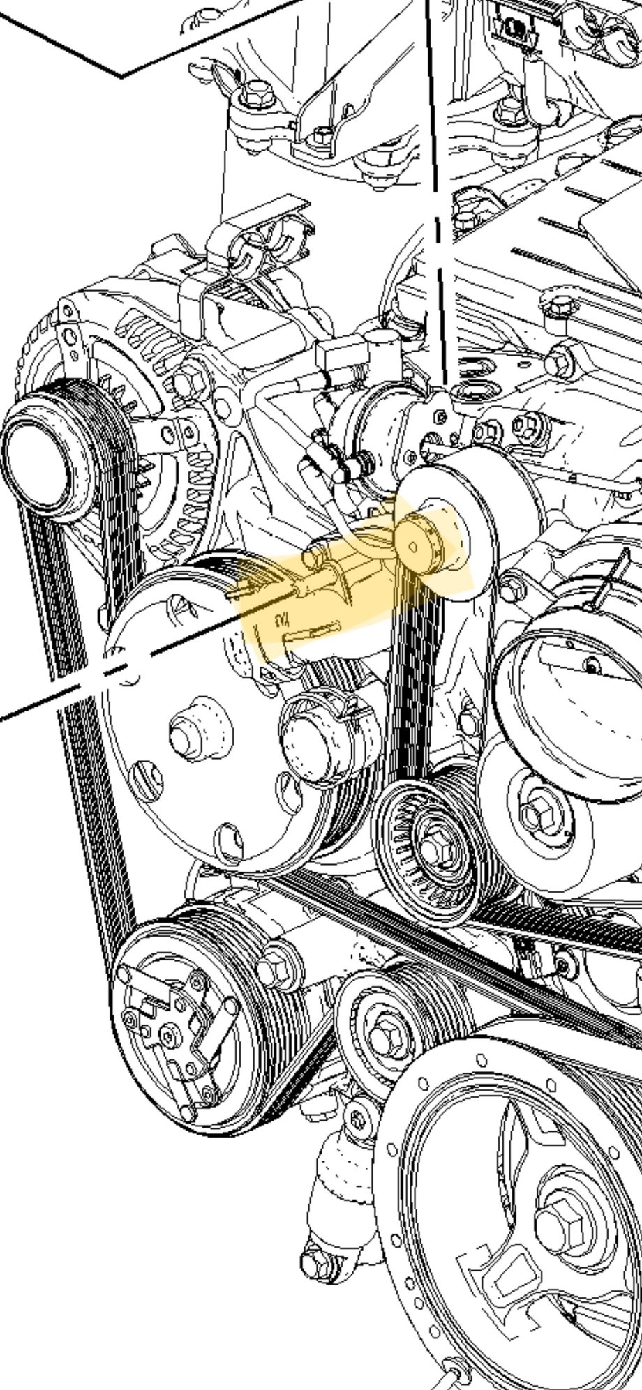

what's that thing that's highlighted do? Changing air filter out, thing broke off. Can I cap it and move on? Looks like a breather valve to help coolant flow better?

Try and post a real picture of what you are looking at if possible.

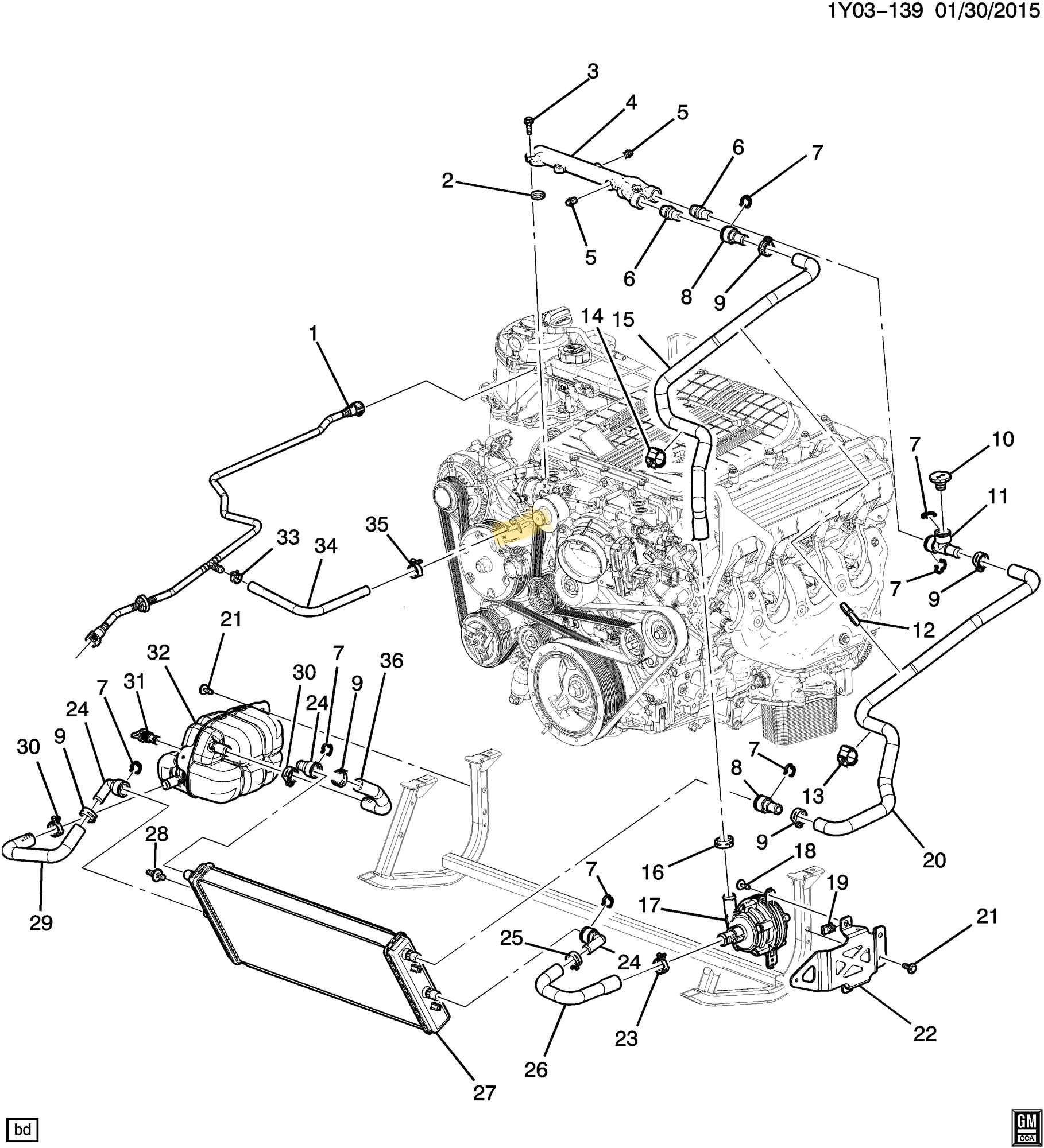

Nevermind, I figured it out. It's thermostat housing bypass nipple. Apparently most halltech intake owners broke this one time or another. What a cheap piece of crap. Fragile plastic nipple. Now I habe to replace the thermostat housing. Ugh...
