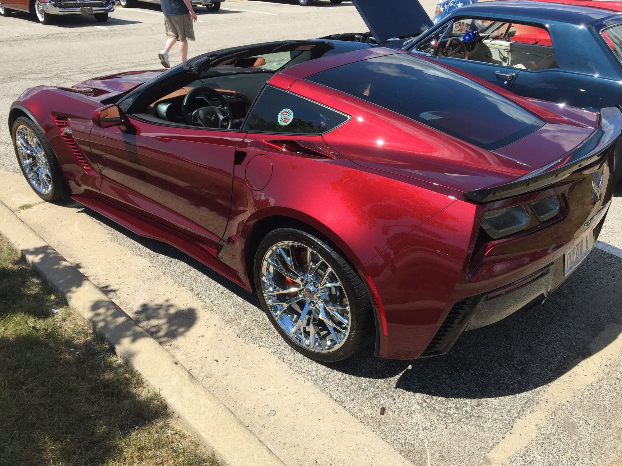

I don't know what wheels you have, but I recently went through this process with a cracked rim on my right rear chrome wheel. After researching repair, OEM wheels and forged wheels, I chose to replace my OEM wheel with another OEM wheel. I know, I know, trying the same thing again expecting different results, the accepted definition of insanity. But here are my thoughts on why I did this. First, I have owned my 2016 Z06 for nine years and this is the first crack (although two were slightly bent), so hopefully the new wheel will last many years. Second, I am thinking seriously of selling my car so I wanted to replace the OEM with OEM rather than use a replica or get a full set of more expensive forged wheels. Third, while a weld repair would be the least expensive alternative, in talking with the best alloy wheel repair shop in Northern Illinois, they admitted that the welded repair of a crack would always be a weak spot on the wheel and the tech I spoke to said if it was his wheel he would replace it. Lastly, I got a fair price for the OEM wheel from House of Wheels in Florida (a couple hundred less than from a dealer even with a trade discount) and all the casting numbers match. Having said all that, I suspect a weld repair done by experts would be fine, but if I am selling a car that I have owned from new, I want to be straight up with a buyer and not have something potentially worrisome I would have to disclose. And if I were planning to keep the car for many more years, I would definitely go for a set of lookalike forged wheels. Probably not chromed but polished and clear finished, because I like the look but know that sometimes chrome itself becomes a problem. For my particular wheels, my research has led me to Wheel Designers and the ZE-11 wheel; that would be the one I would get but they offer many alternatives. Just some thoughts for you. Good Luck with your search.--Bob
