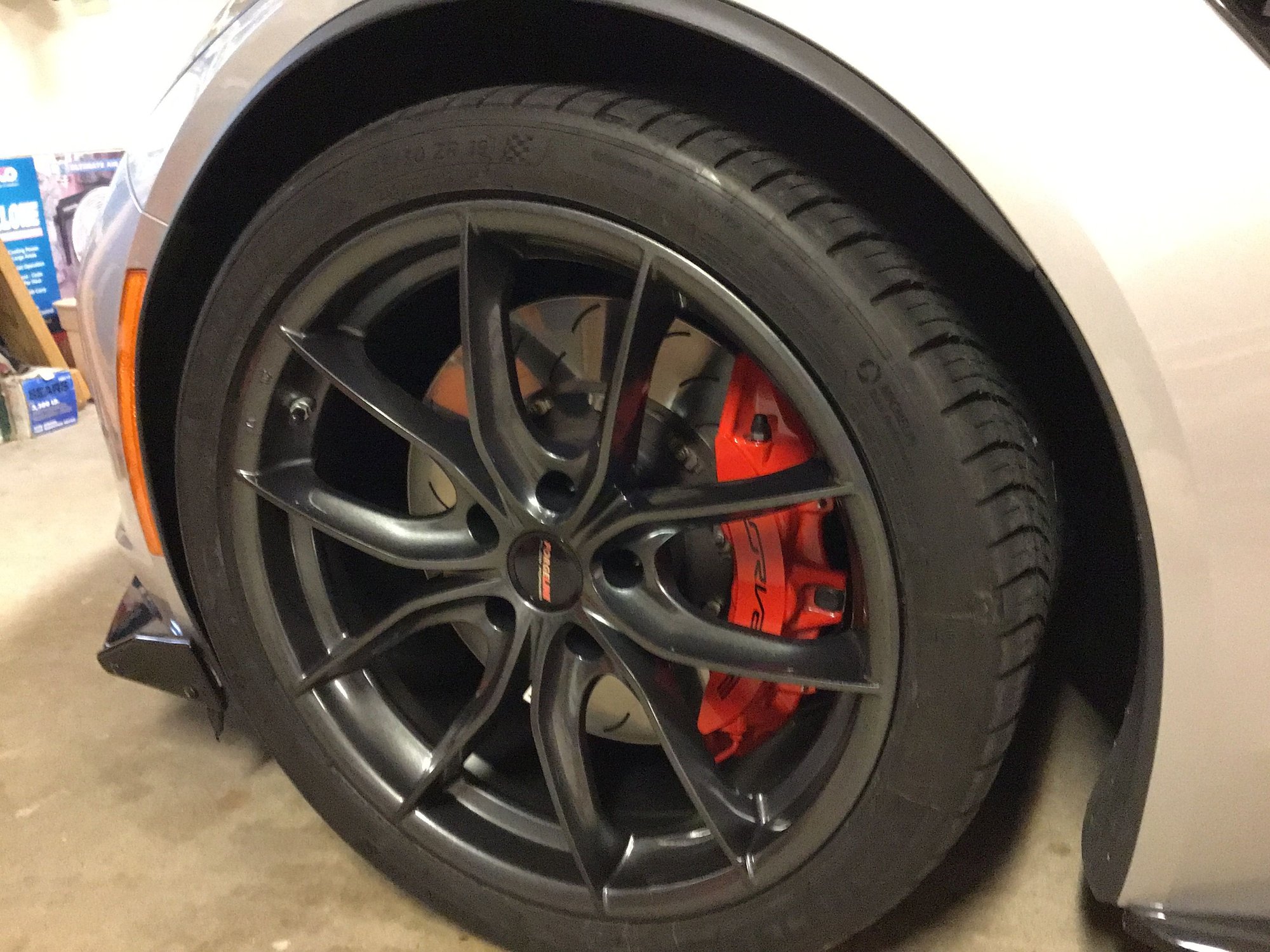

My rotary forged F01s in Anthracite are now 30 months old on my Z06.

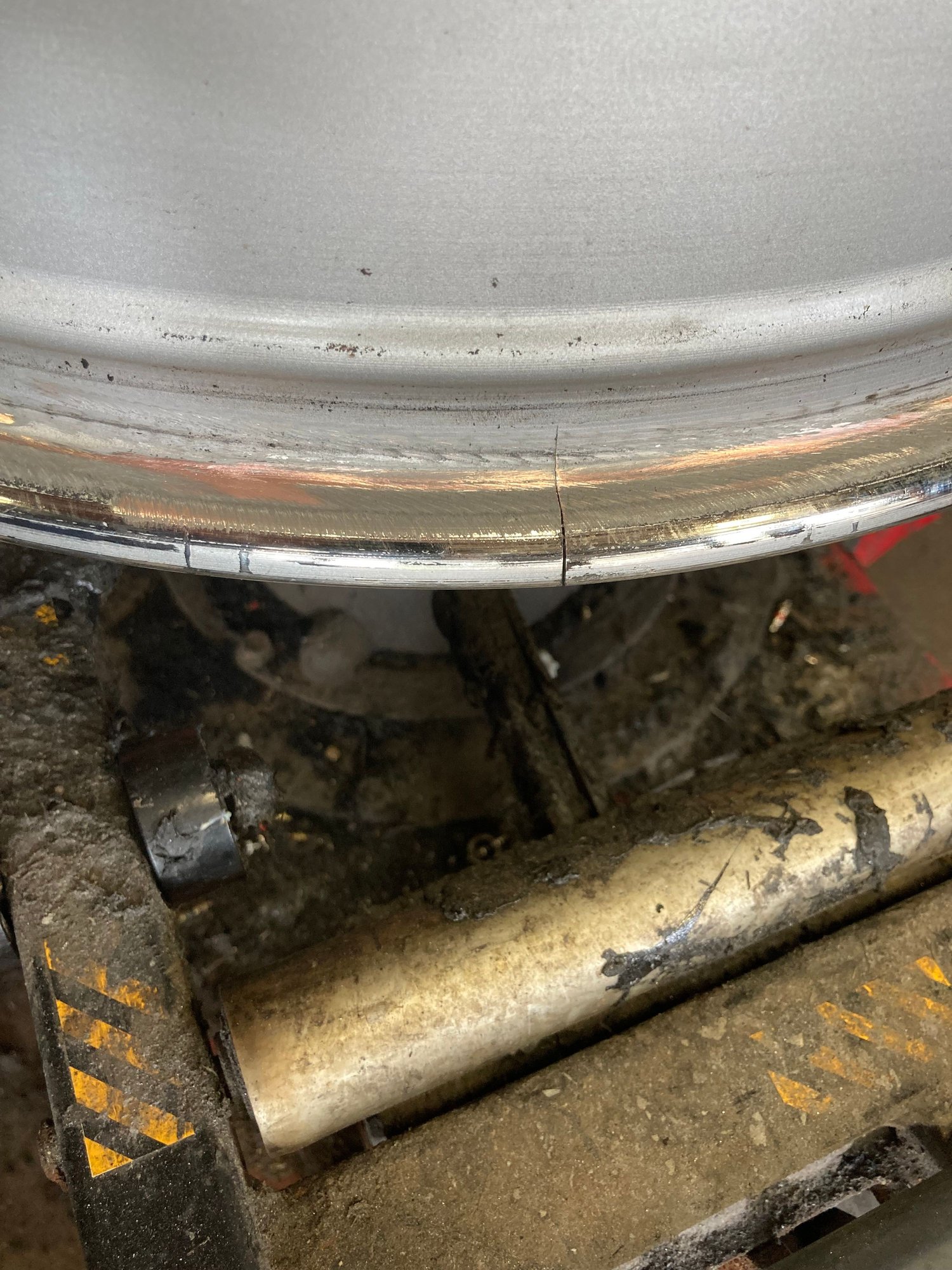

I also recently experienced a cracked rear wheel on my 2016 Z06's with chrome wheels. I have put about 34,000 miles on it in 9-1/2 years and I know that at 20k, when I replaced the OEM tires, the two right side wheels were slightly bent (but not cracked). The tech was able to balance them out perfectly and I have had no problems since until I picked up a nail in the center of the right rear tire this summer. When I took it in for repair the tech pointed out a crack. It had not caused the tire to lose air; only the nail did, but it was there. He put some sealer on it, mounted the tire, and it did not lose any air after that but I knew I needed to do something about it. Because of the problems with our wheels I had previously researched forged wheel alternatives, but decided that at this point in my ownership it was best to replace the wheel with an OEM chrome one which I got at a fair price from House of Wheels in Florida. The reason I did this is that I plan to be selling my car sometime in the near future, probably next spring, and I felt it best to have all OEM wheels on the car as it is otherwise unmodified. After all, the wheels had done fine for nine years and 33k miles of my ownership and will probably be fine for a long time to come. So for me, at this time, that was the best decision. Having said that, however, if I planned to keep the car a long time, the next time I got a crack I would replace all four with forged ones. Since I like the look of my OEM chrome wheels (Old Guy), the wheels I would probably get are the Wheel Designer's ZE11 wheels, probably in a polished or painted finish rather than chrome as Track did. But those Forgelines look fine as well. Good luck with your mission.--Bob
