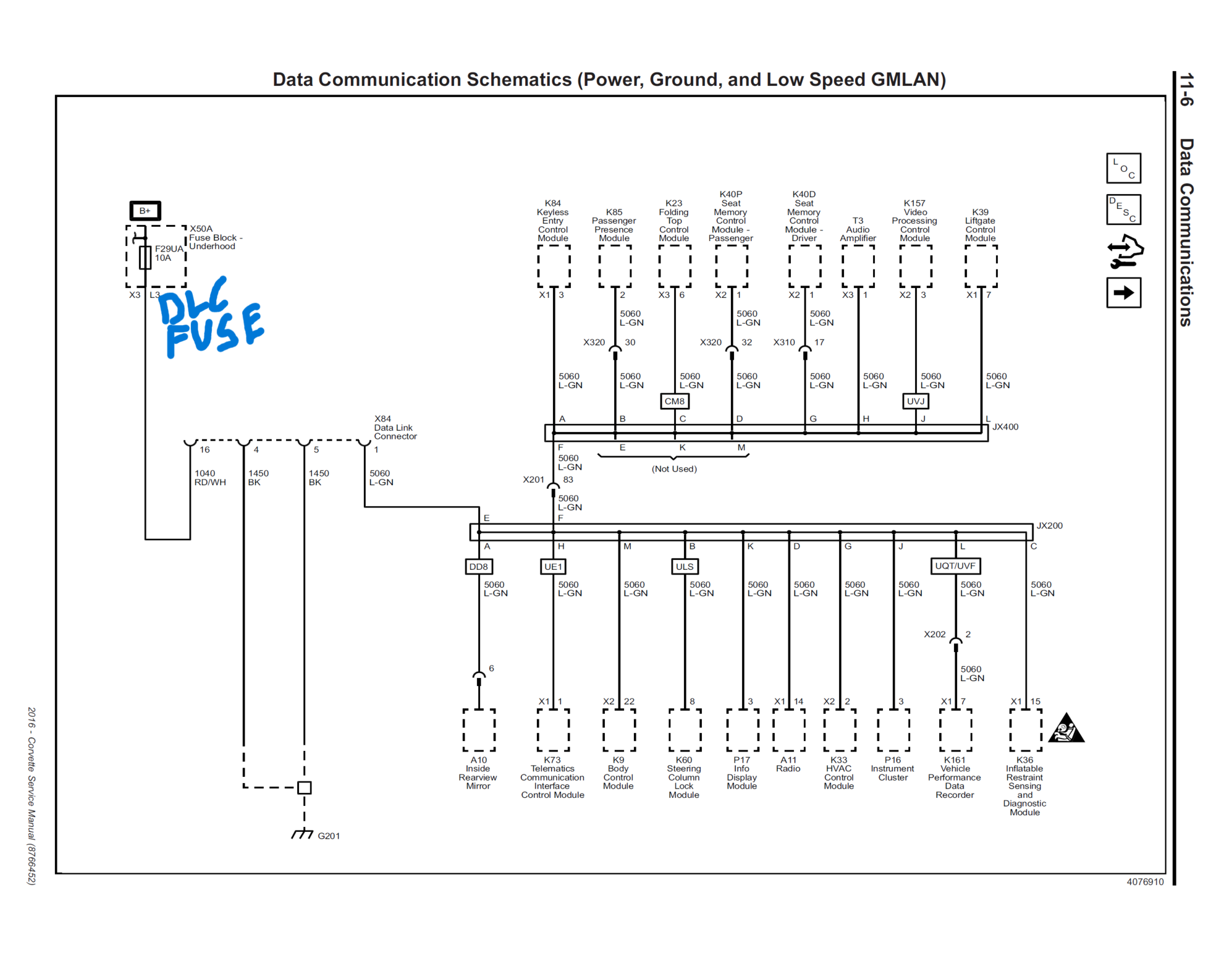

that sounds like a good idea. Should I avoid spraying the hot pin 16? That location has the most corrosion. Yes I do have an OBD2 scanner.
Just remove the 10 amp DLC fuse in the under hood fuse box which powers terminal 16.

No need to worry about disconnecting the battery to do this either...ignition is off anyway...if the car has been shut down for a while your modules (high and low speed CAN buses, the LIN and MOST busses will be "sleeping" even if the ignition were on...for demonstration purposes I've shorted out those busses to power and ground with a 12 volt test light...they are "fault tolerant"...if the scan tool can't communicate with the car it may be a "communication" issue and not a problem with the DLC or scan tool.
