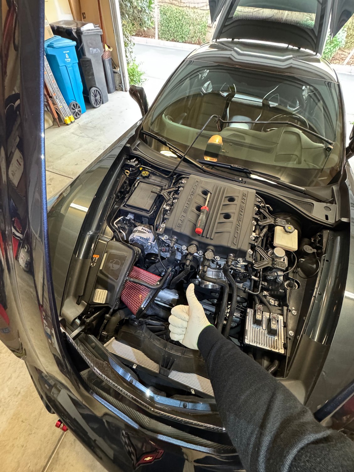

Just an update on this little saga in case anyone cares. Got a bit sidetracked since four weeks ago some POS thug smashed the drivers window when I was parked at a mall for 90 minutes. Cameras everywhere and tons of holiday shopping traffic…they got some calls I’ll give them that. So now that I’ve replaced the window (quite a bit easier than I was expecting actually) today I got around to fixing my electrical issue…
Kinda nice being able to lean right through the halo hood sometimes.

So yeah. It was the alternator. Before the incident with the broken window, I’d been watching the voltmeter in the gauge cluster. Saw it getting in the high 15s, then 16, and then as high as 16.6 volts. So ok that sold me, that’s beyond its operating range. Even for the slightly higher than normal range the C7 uses. Oscillating brightness (or flickering) of exterior lights is a super common symptom of a bad alternator. Since the charging system of the C7 can be at 15.5v and that can be a normal condition, I didn’t immediately suspect the alternator was overcharging.

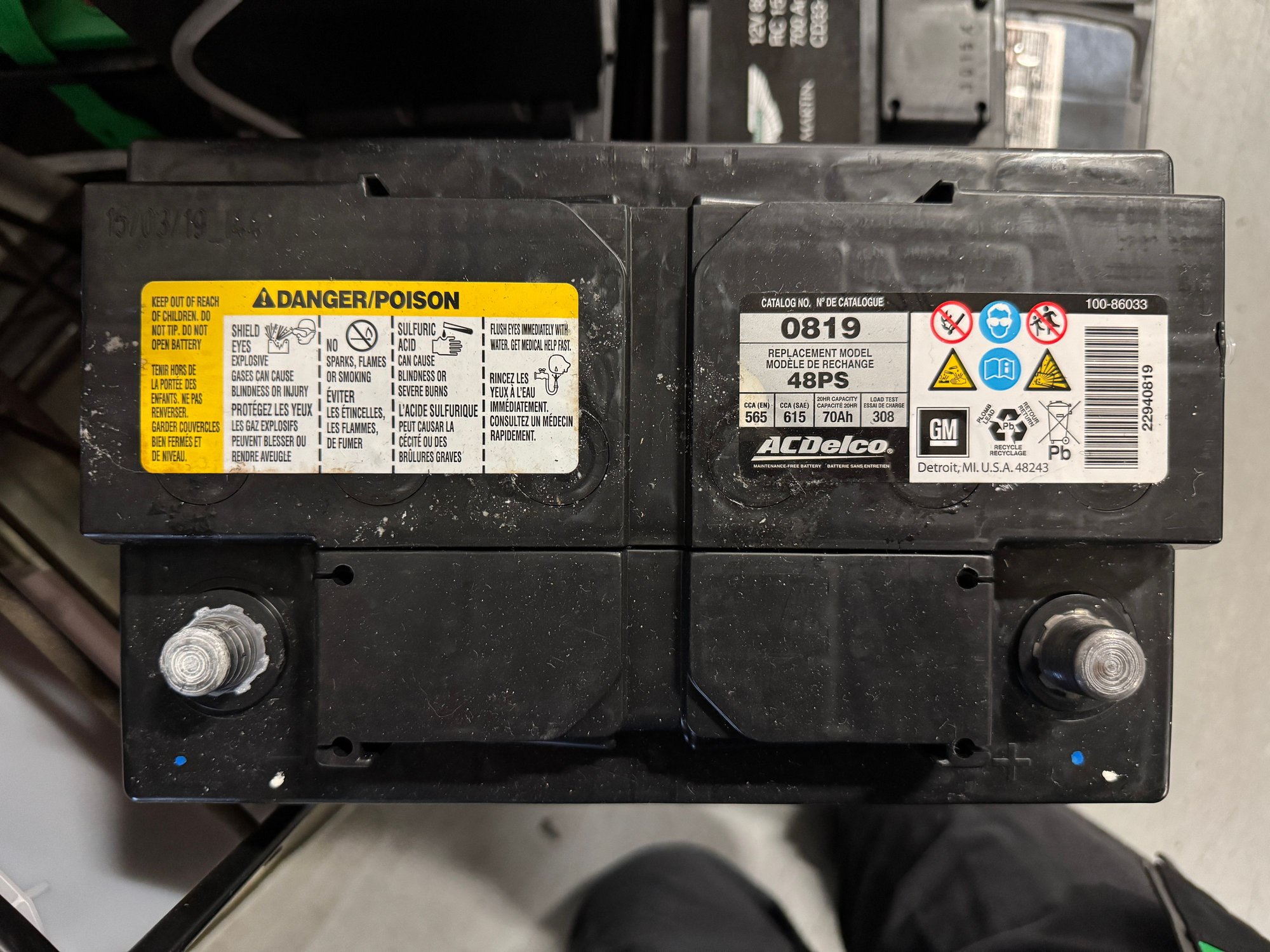

Even though I replaced it over a month ago, my shop still has my original sitting around (our vendor doesn’t come to collect them all that often).
While there is nothing labeled on here defining whether it’s AGM or flooded, a quick shake to hear the acid sloshing around very much confirms this is a flooded battery. Looking though a list of AC Delco batteries, it seems the “PS” in the 48PS is how you know. Seems like all the flooded batteries have the group number with PS or PG after it. And an AGM would be a “48AGM” label.

Hey Hib I am the original owner of my 2019 ZR1 (purchased July 2019) and it still has the OEM battery, its a AC Delco Grp 48PS, 615CCA and 110RC Flooded non-AGM battery. I was going to replace it with a Interstate Flooded battery but changed my mind and decided to stick with flooded AC Delco battery . I just checked the surface charge and did a loaded test and all is good but I will replace it at the start of summer. Yes when not being driven l keep it plugged in with the OEM battery maintainer.
