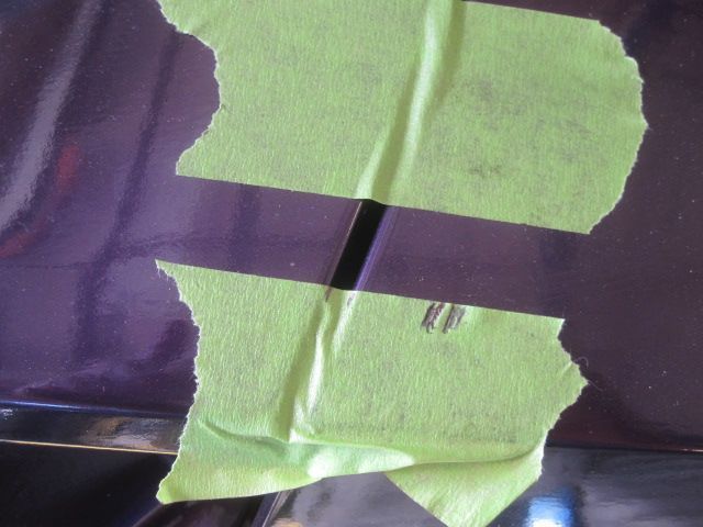

It is a very complex subject. Notice how my efforts to explain PMI in layman's terms falls upon deaf ears. It's very sad. I've raced a bunch of C4s, C5s and my beloved C6. It took 'till the 2004 C5 Z06 to be faster than the C4 GS. The C4 had a perimeter frame like a 50s Chev Biscayne. The engine was far back compared to the C5, 6 and 7 which loaded the frame adversely. The long wheel base Vettes that followed have a unique structure while they transitioned from steel to aluminum. It's a perimeter, space frame, backbone structure. I love it. The focus of chassis design is the friction circle at each tire. The most important component is the load at each tire. Late model Corvettes are a little like go carts in that the chassis is part of the suspension. The bending and torsional displacement in the C7 chassis does not effect tire grip at either end. The back and the front of the car are doing their own thing. It would be impossible to stiffen this chassis without making it very heavy or using expensive materials. The long wheel base provides for a lot of leverage, the front tires are already loaded so the turn in is brisc. A ME car coming out of a turn under power will understeer but you will be able to get on to the power sooner. Always trade offs. The C7 Vette will out brake any car just because of tire loading. You have to have lightning quick reflexes with a ME car to recover from a problem you encounter at the limit.
I have a steel roll cage in my C6Z which changes the entire equation. It becomes a single purpose car.
C7Z after your jack it up...
....and after you let it down.
