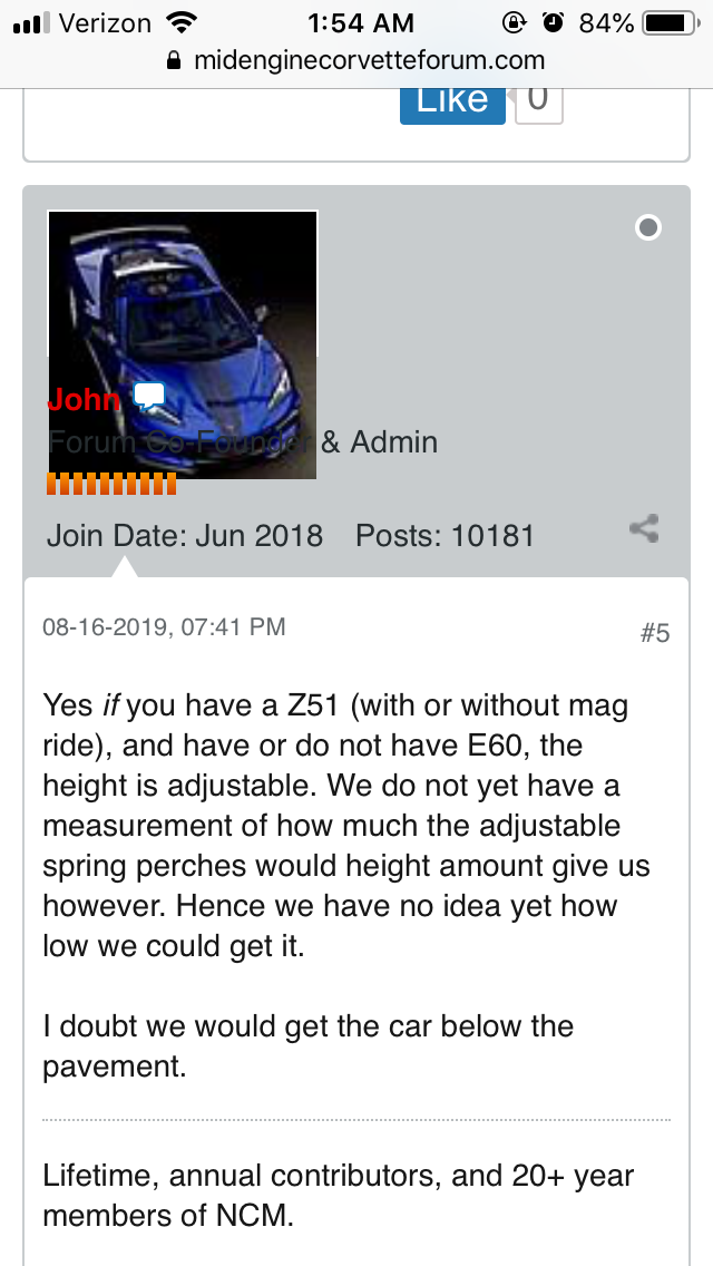

Having Z51 and Also E60 Does Not Result In Height Adjustability Loss
I wrote to Harlan seeking clarification as this was a significant question as to whether having Z51 and E60 resulted in the loss of adjusting spring perches height adjustability.
Originally Posted by John
Your help again please!
SUBJ: If Z51 & E60 combined, retains ride height adjustability?
Harlan,
Thanks. This has been a hot topic in both forums this past weekend, but I did not want to bother you during the weekend.
We all so appreciated your response back a week ago, then confirming that as we thought, that the Z51 has adjustable spring perches to adjust ride height.
However, if one were to get a Z51 and add in additionally E60 lift option, does one lose the ability to adjust a C8’s height?[/Quote=JohnElegant]
[[b]Quote=Harlan]It’s two different things so one does not effect the other.
Now - if someone lowers there car with Z51 spring seats, obviously the front lift will not go as high as it is all relative.
