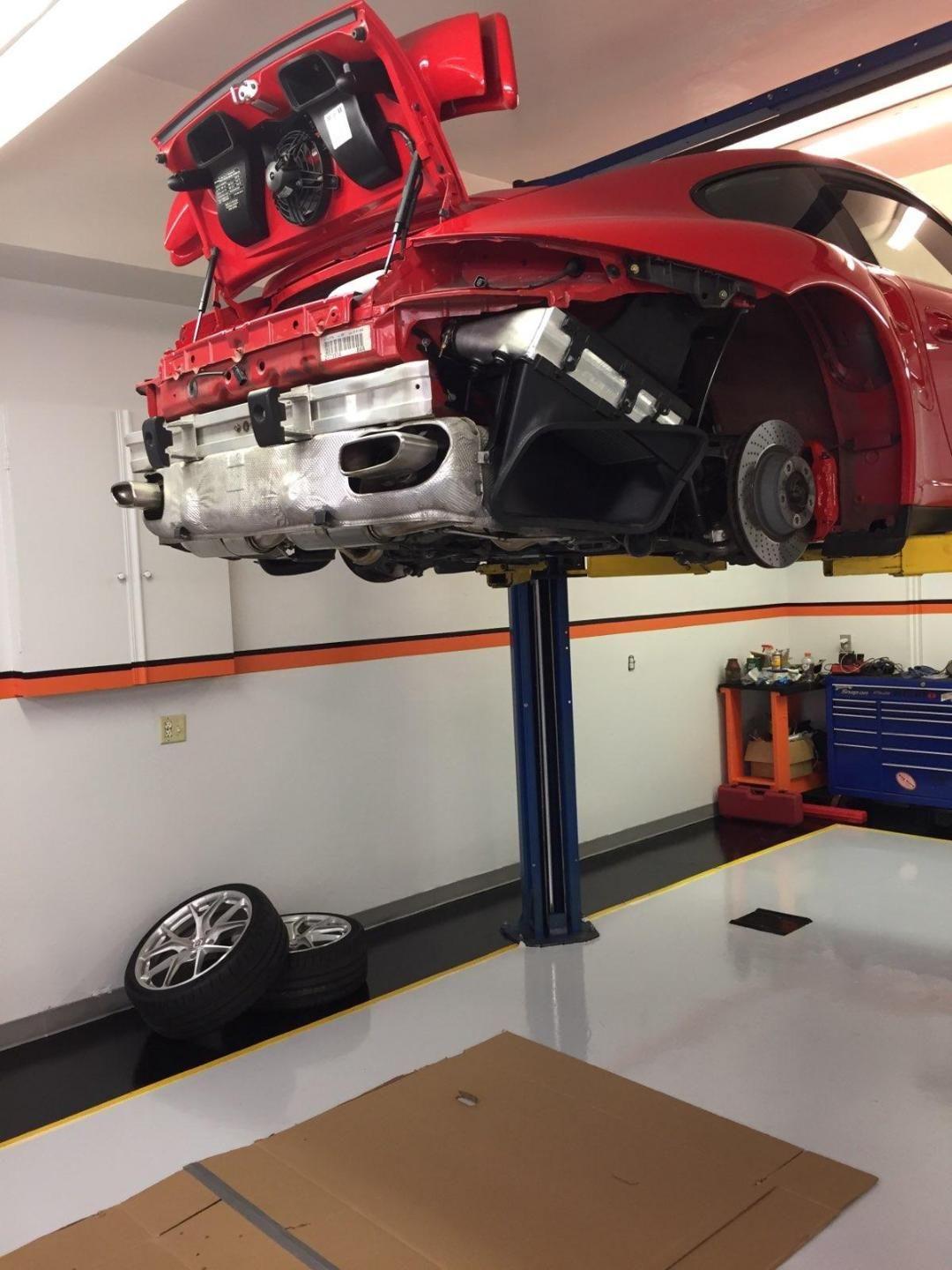

What are the base C8/Stingray Side Scoop functionalities? I am assuming one/both are for an air to water cooler of some sort for the differential/DCT? And I also assume the engine radiator(s) are up front? I am one of the guys waiting on the Z06 and hoping for a 4 liter TT DOHC V8 and just playing some mental games about how the air scoops will function on the Z as you need some BIG Intercooler air inlets. Any thoughts?
As a point of reference here is my old 997 TT with a picture of the Side scoop intercooler intake.

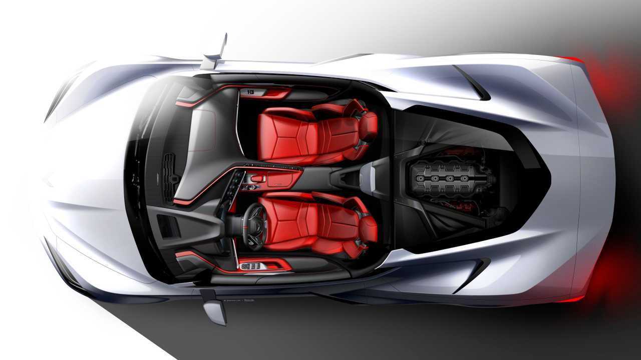

Perhaps this:
