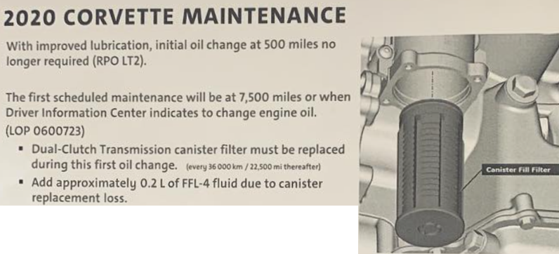

Here’s some info to get you started.

[QUOTE=BIG Dave;1600961610]
Where did this slide come from?
