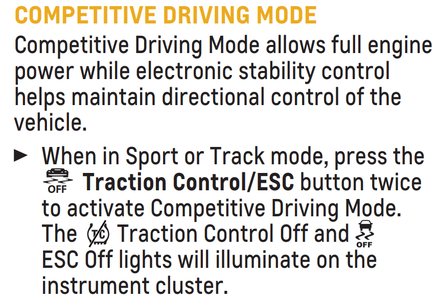

Default C8 Performance Features Quick Reference (PDF color)
https://my.gm.com/content/dam/gmowne...ence-guide.pdf

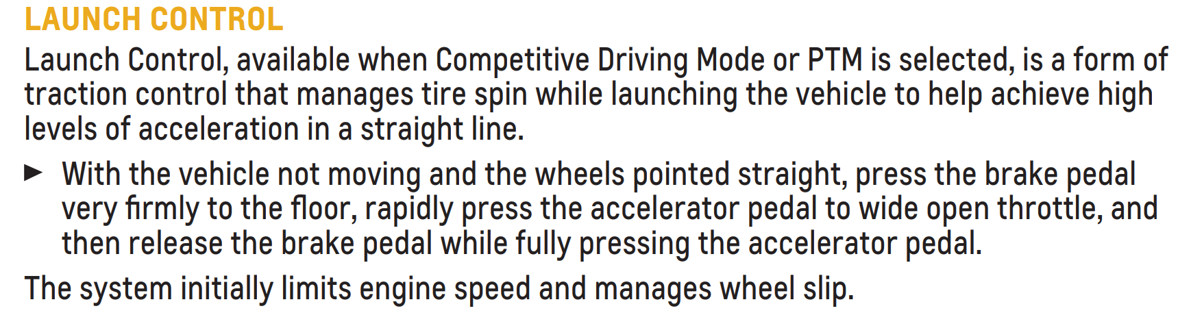

A smooth, quick release of the brake pedal, while maintaining the fully pressed accelerator pedal, will manage tire slip.
