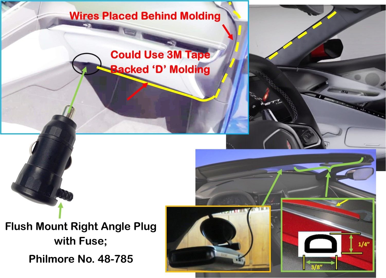

Not worried about the mount, as I mount mine as high as possible to the right of the mirror with "Sticky Mount" suction cup . BUT hoping someone will define how (if possible) to tap the mirror for power.
Until then this is what I'll do:
