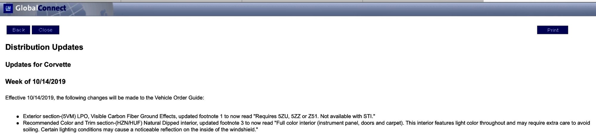

Like many others, I'm a bit concerned about the glare issue. Especially since GM is the author of it. So maybe it is bad maybe not so bad. No real life miles for anyone to tell. Car reviewers don't seem to mention it, but they might be in don't bite the hand (GM) that feeds you mode. So, would tinting with a ceramic heat blocker at 5% solve or perhaps even solve this dilemma? Factory glass 20% plus 5% = 25% should be legal most places.
Wife loves the Natural Dipped and does not love the black/tan combo alternative. So if we pass on tan, I guess we fade to black. Torch Red so it will be fine, but a compromise we both hate to make.

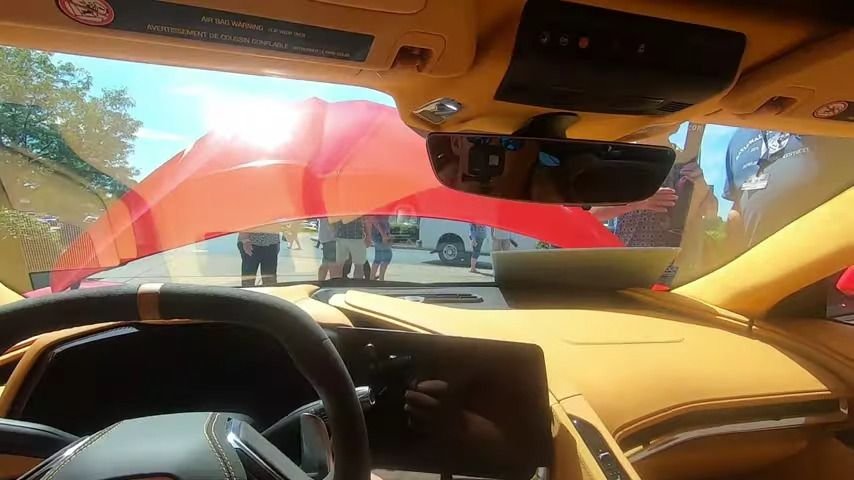

All I can tell you is, Ive been doing some testing to see if it possible to reduce glare completely. My tests, to me at least, was to try worst possible case I could think of, using Standard White paper with Black wording , an Slick finish White paper, Black wording, laying on a Black dash.
I do not have a pair of Polarized Clear Lens glasses, nor do I have a car with a HUD to test with.
All the glasses I've used have been Polarized. All of them are not equal. One highly advertised pair, that claimed to Reduce Windshield glare, were useless, could not even prevent the shine from the slick black plastic windshield defogger vent from reflecting on windshield.
The other two highly advertised Polarized Glasses, both did good enough for me to be able to ignore what glare was still their. With the white paper, even in cloudy conditions, some glare was there, any time of day, regardless of wither you were driving into the sun or not.
Like I said above, I have no way of testing those sun glasses to see if a HUD's display will be visible.
I also have a couple of sets of night driving glasses that, one set I really like, that I've used when it's clouded/rainy in daytime that I love the effect it has on glare, no testing with those, at this time.
I have not tested with white paper on dash at night to see if headlight glare will be a problem with interior at night. If it is with Natural Ddipped, then there's a real problem, safety wise.
Maybe someone that has a car with Heads Up Display, could do some testing, to see if the HUD is readable, with a couple of brands of Polarized, sunglasses, or clear everyday Bifocal ones. The best of the glasses I've tried, do look out of place on old people, one more so than the other one,,,,LOL
For what it's worth, even a C6 with a Black dash, had it reflect on windshield. One of the of the U-Tubers at Carlisle had that happen on his video showing him driving into Show....LOL All it takes is for dash to have a sheen to it.
Notice the effects on Windshield were the HUD is, how there is no glare on windshield there. Notice the difference in the ability to see the Lady in picture were the HUD display, eliminates windshield glare from Natural Dip on dash, an the same where the Dash is Black?
Last edited by Poorhousenext; Mar 5, 2020 at 06:48 PM. Reason: To add picture of Natural Dipped for those that call it Fake News.
I think the test would need to be done with a C8 HUD. Some types of displays are polarized and some aren't. If I rotate my Serengeti Drivers while looking at my computer LCD, ASUS tablet, or LG G2 screens through my Serengeti Drivers the displays go dark in landscape mode. However, there is no difference with my Samsung Galaxy S7 screen. I didn't do this test with my C7 since I could see the displays and HUD OK with my Serengeti Drivers on.
The reflective coating used for the HUD also makes a difference. I know 3M makes a film just for HUDs that allows the use of polarized sunglasses.
