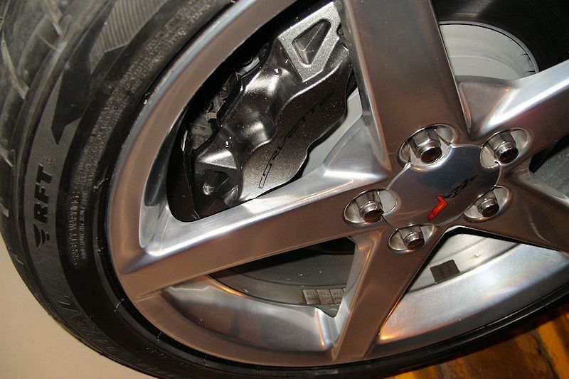

We had this discussion on the early 2014's. About everyone assured me that all C6 wheels would fit. This turned out to be false. Please pay very close attention to caliper clearance with the spokes. Her's a picture showing the interference.
