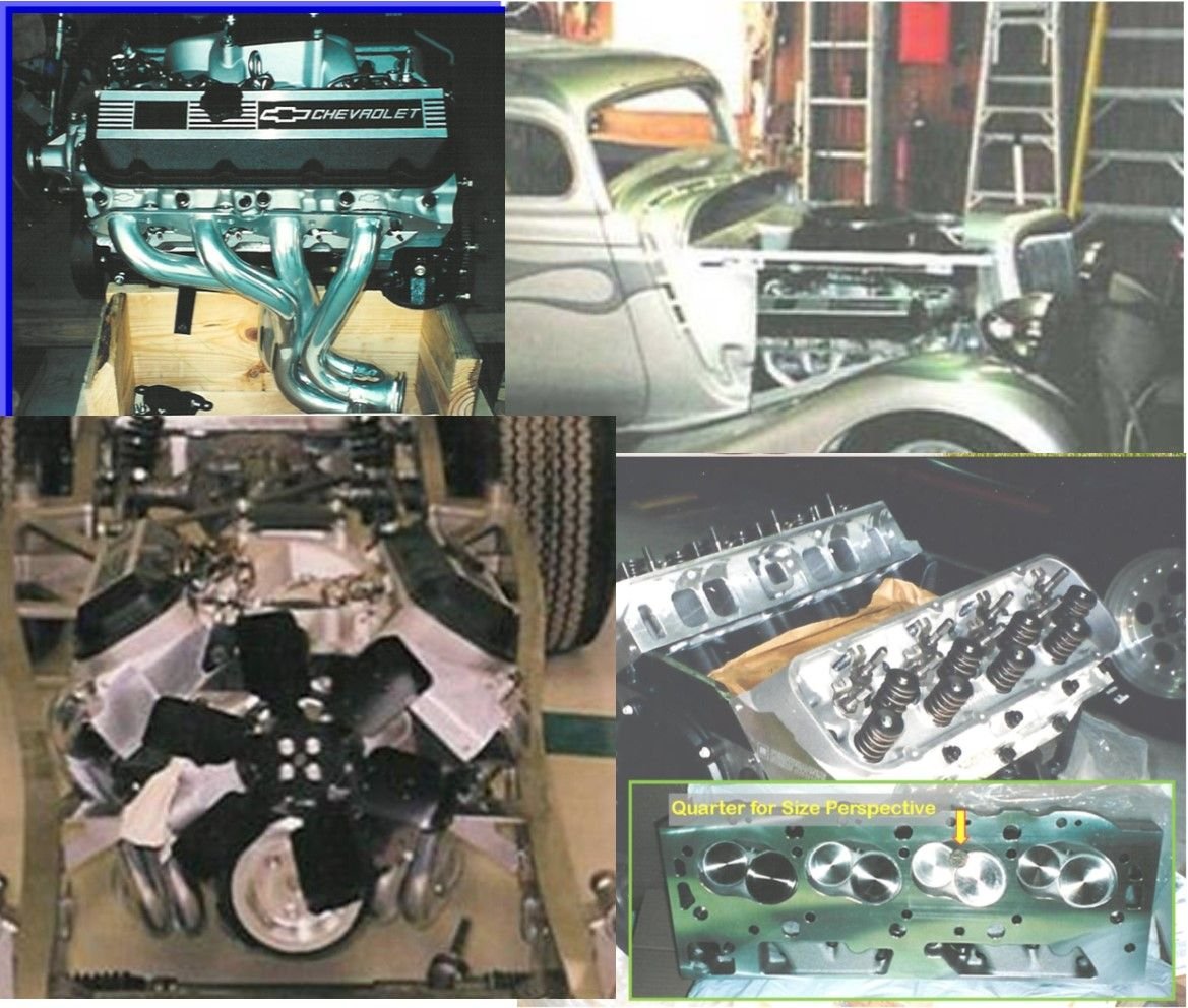

Yep the C8 headers look great in all those GM marketing pics! Too bad in reality they are covered in the necessary insulation and heat shields!
Yep Titanium or Inconel would look pretty BUT without the heat shield and insulation you'd melt the composite parts!
If Just "Looks" the Ceramic Coated Sanderson Long Tube Steel Headers in my Street Rod Look About the Same Now as When New 20 Years Ago!

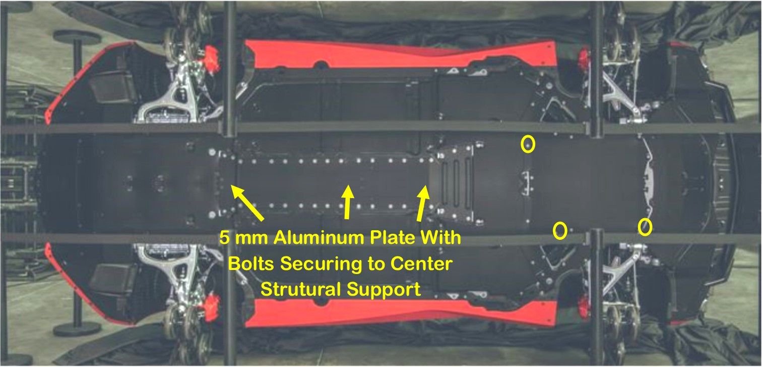

Looking at the pictures what will it take to change plugs??
Old Apr 7, 2020 | 08:37 PM
Red Mist Rulz's Avatar
Red Mist Rulz
Joined: Sep 2016
Posts: 13,180
Likes: 10,527
Done from underneath. Pop off the underbody flat floor (about 25 retained fasteners, I've read), and they are easily accessible from underneath. Along with belts, alternator, coils, water pump.
Also, plugs are supposed to be good for 125K miles, so most owners will never have to worry about them.

Thanks for info. Looking at this pic, 25 fasteners sounds about right for those right of the center section.
FWIW, thought Tadge's comment on the Autoline interview was interesting. Where the underbody sections are thin, designed just for Aero, the center section with the shinny visible bolt heads is also structural. It creates a ridged box center structure providing some of the chassis stiffness. He mentioned it as one reason for the C8 weight as it's made from 5 mm thick aluminum and the bolts join it to the "U" shaped upper structural making a box! In the leaked C8 hybrid info it will also hold the battery and battery AC cooling!
