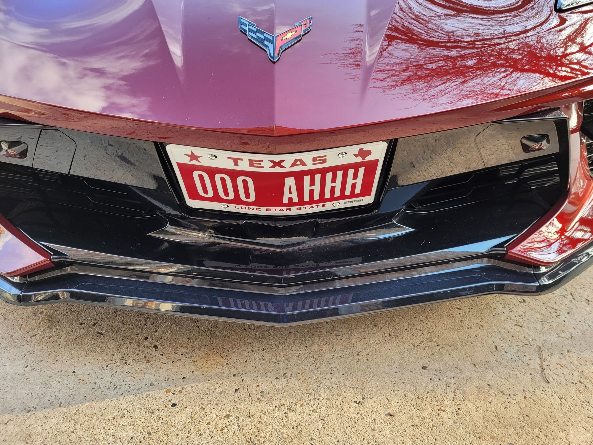

Originally Posted by CP
I drilled pilot holes into the four little squares on the panel. They matched the license plate holes. License plate bends in the middle and points slightly downward.
Do you remember what size screws you put on and I assume from your comment all 4 were needed and not just the top ones? Thanks, Sam

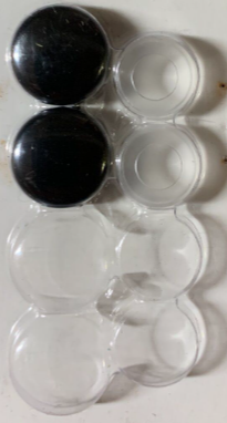

Originally Posted by JVi
You do not have to drill the bosses.
Bend the plate to match the curve of the mounting area with the plate holes lining up with the bosses.
Use self tapping license plate screws on the bosses.
Cover the heads with fastener caps.
great idea! I have never seen those license plate caps. I’ll look on Amazon. Do you know the size of the screw you used?
Old Feb 18, 2022 | 06:44 PM
CP's Avatar
CP
Joined: Aug 2000
Posts: 24,075
Likes: 1,322
From: Spring Texas
Old Feb 18, 2022 | 08:03 PM
Samuel Clemens's Avatar
Samuel Clemens
Joined: Apr 2021
Posts: 1,553
Likes: 1,061
Thats a great job on that slight bend!
Old Feb 18, 2022 | 08:17 PM
CP's Avatar
CP
Joined: Aug 2000
Posts: 24,075
Likes: 1,322
From: Spring Texas
Probably helps with LIDAR because the plate points down and doesn't reflect directly back to the laser gun.

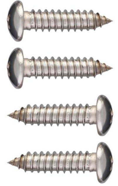

Do you remember what size screws you put on? I guess I will be covering the plate with the Novistretch though on long trips.
Nah. They were screws with the head large enuf that didn't go through the holes in the plate. Nuffin fancy. Looked like the pic above.
