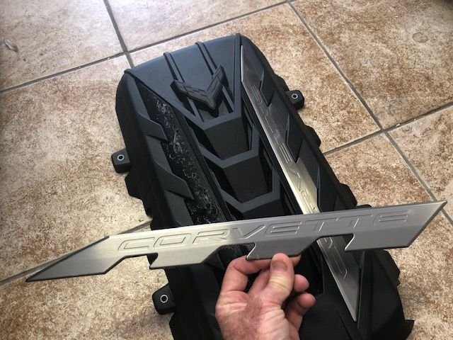

Can the corvette script on each side be removed easily without damage?
is it glued on or just snapped on.

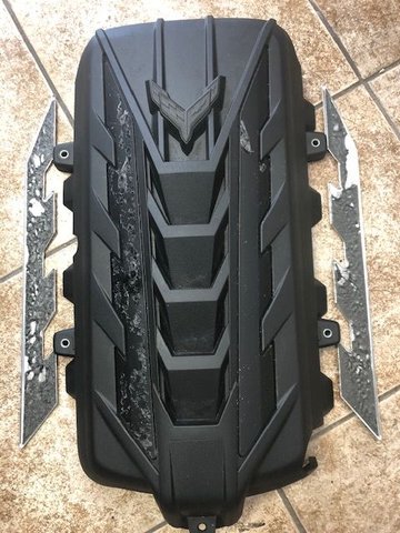

Thought I would update this - Just finished removal - its well glued on - I used a thin stainless wire between the metal script and cover and it came off with a little bit of effort. Heating beforehand would probably help. Just cleaned up the glue with a little bit of acetone. Much better and faster than masking.
