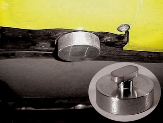

The PFYC website states "PLEASE NOTE: These Jack Pucks will only work on cars WITHOUT side skirts."
Amazing, but I contacted the one of the manufacturers ) http://www.eliteengineeringusa.com/c...pads-set-of-4/ ) of the jacking pads and they were unable to provide information on their own product regarding fit. I liked this version better because they are taller.

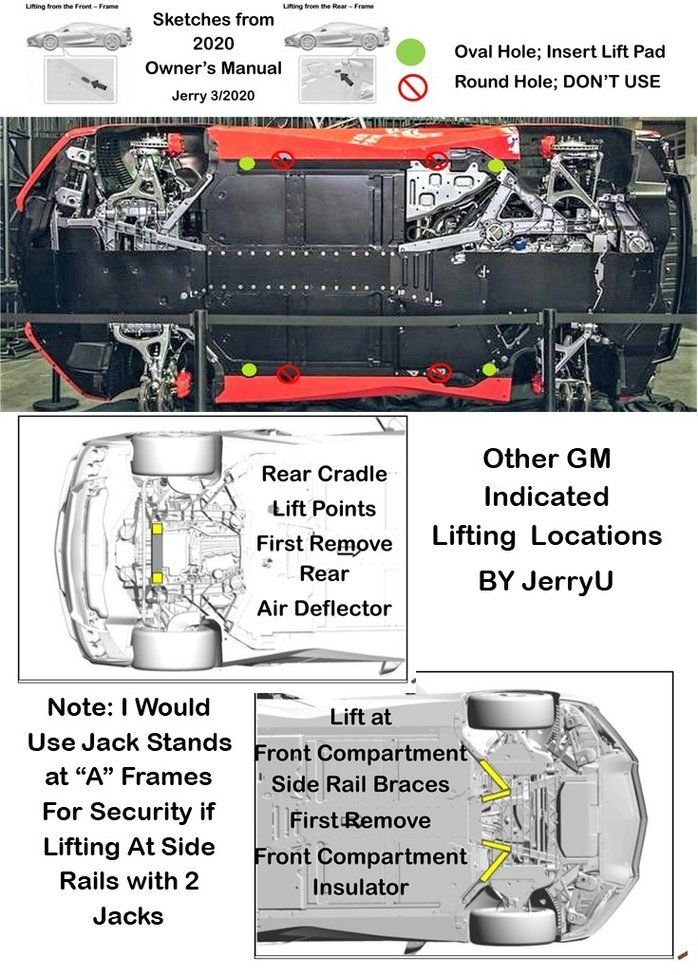

Has anyone tried the aluminum lift pucks yet that has side rocker panel extension (side skirts) option installed on their C8? It would be nice to know if they fit or get in the way of the skirt. My thinking is that if the taller version, it should clear if the shorter one hits somehow. I don't see how these would not work because they go down unless the diameter contacts the skirt somehow. If you look at the images, the round diameter should miss contact with the panels at the "yellow" dot areas. It would be nice if someone has had the opportunity to confirm or say they don't. If they don't, how does one use a lift without causing damage? Isn't the GM authorized supplied lift extensions at dealerships similar - round extensions?

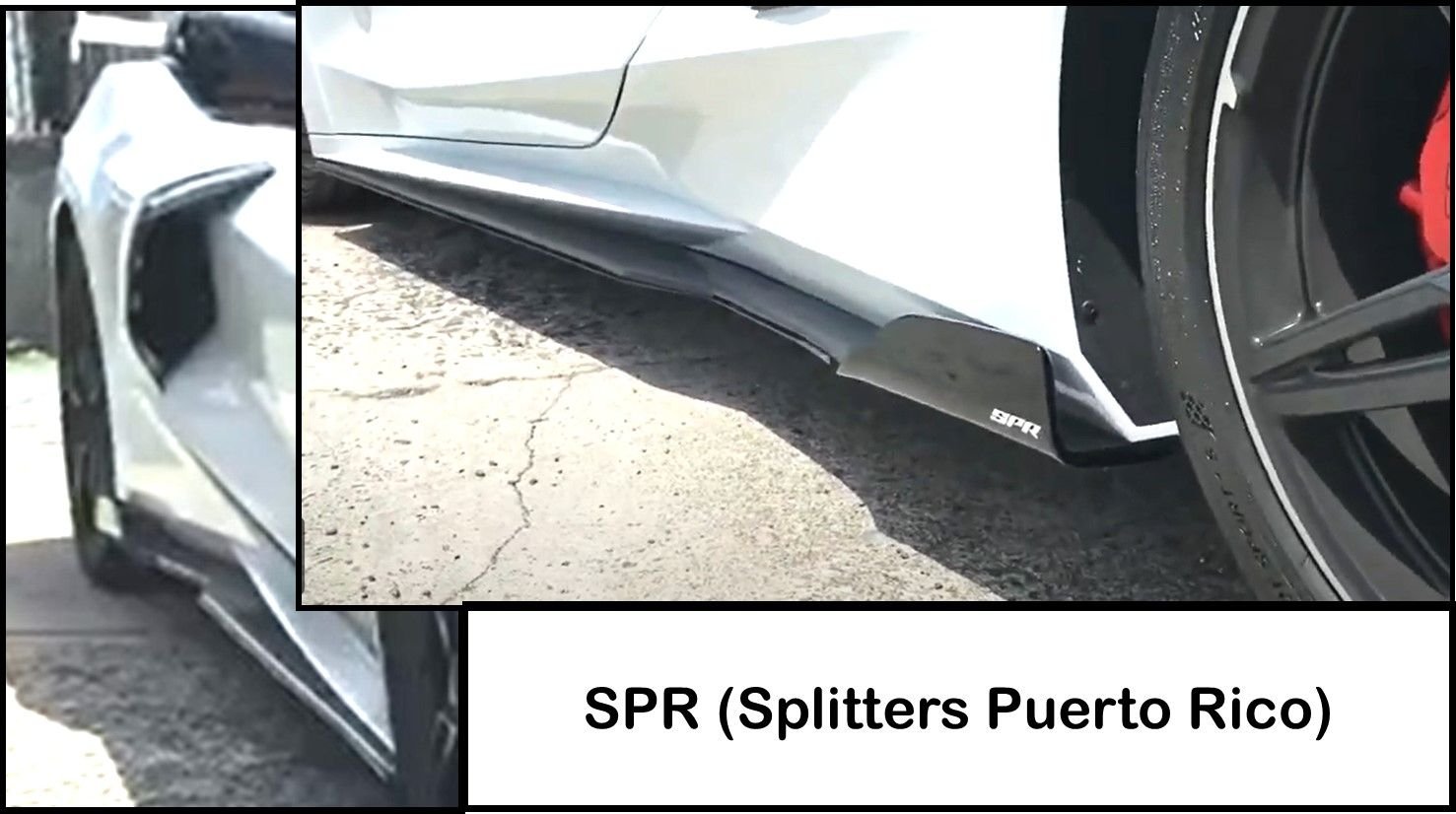

I'll get some kind of full length side skirts BUT not that GM product that only covers the protrusion ABOVE the rocker panels!
GM Rocker Protector
An Aftermarket Product That Would Work to Stop Pebbles
GM's Now Constrained Side Skirt. C7 Carbon Selling in Painted Carbon Flash OR Visible Carbon Fiber- Probably What I'll Get

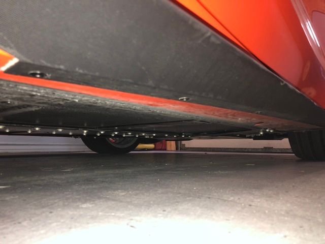

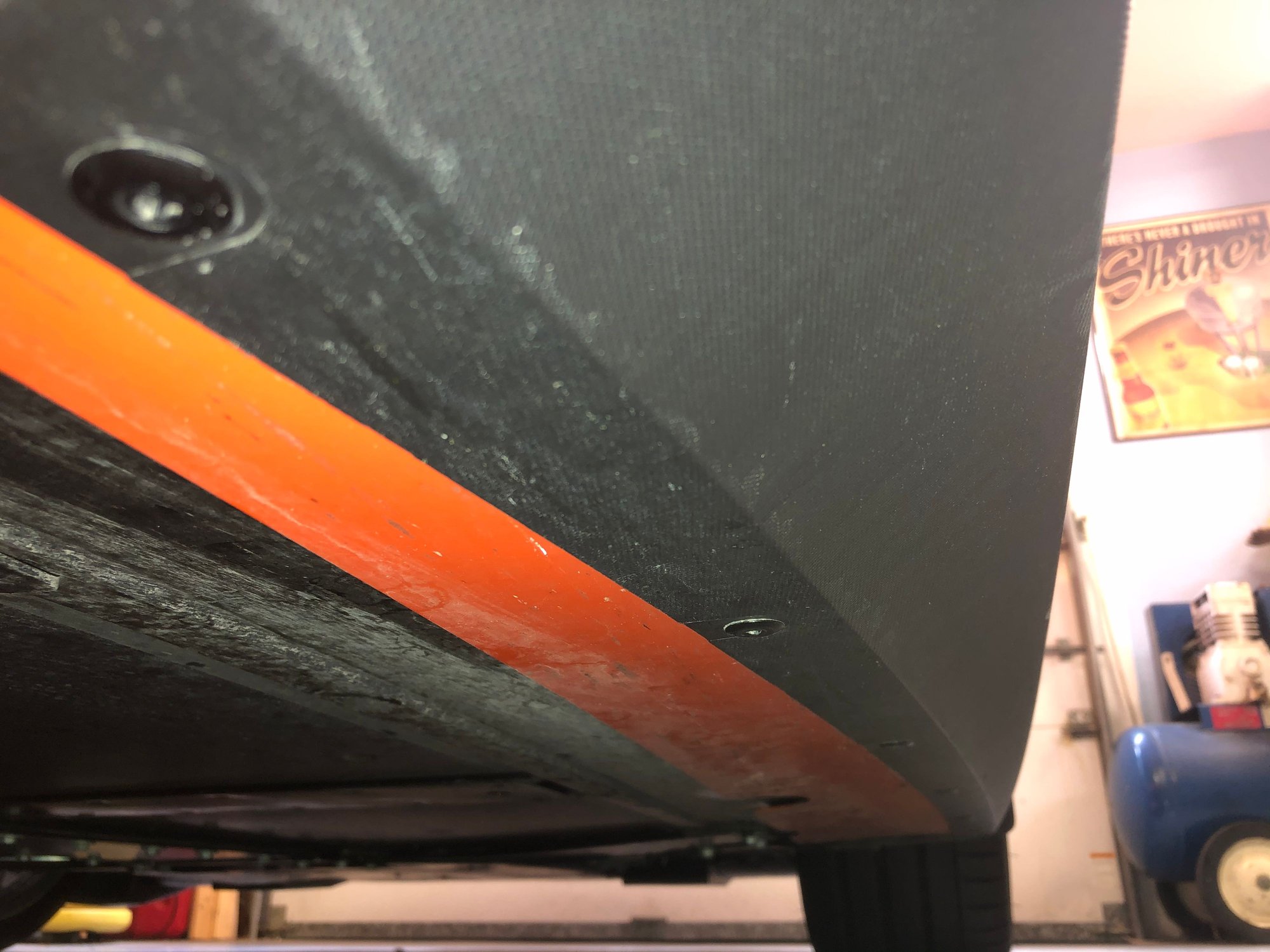

photo of the GM rocker panel extensions. I didn’t wash it before taking the photos. sorry.

That exposed area is where I had problems with my 2014 Z51. In fact the C7 GM "Protective Plastic" went from the center of the door back to up to the front of the rear wheel well. No issues ahead of the door center. When I added full length side skirts was able to remove the GM Plastic Protection, which by then was marked and discolored on the edges.

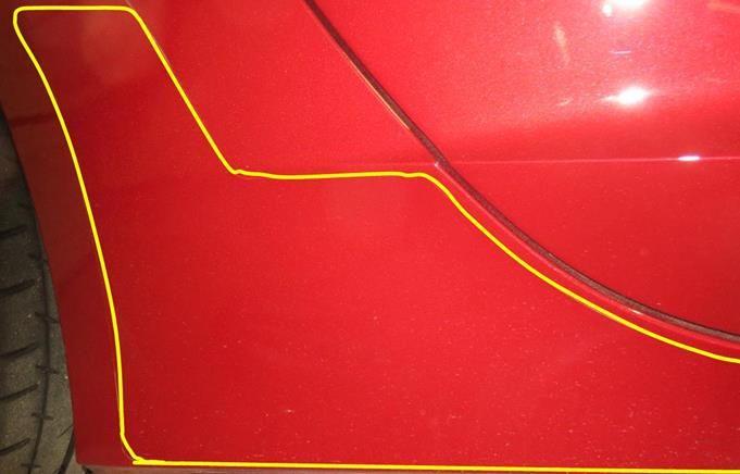

Issue is The Area Circled in Yellow is Where the Problem Occurs. As You Said You Have "Plastic Wrap" added. Not a Fan so Full Length Side Skirts Are My Choice.
This Is Where I Had a Lot of Marking From Pebbles With My 2014 Z51. GM Knew Where Plastic Protection Was Needed!
On My Current Grand Sport with Full Length Stage 2 Aero Side Skirts, I Was Able to Remove the Discolored on the Edges GM Plastic. In 3 Years NOT One Mark on my Rocker Panes or the Lower Rear Fender Brake Duct Opening, Some Say Their's Have Chips. Paid $3000 for those full length CF side skirts (and splitter) versus the 2/3 plastic one that are standard on mt Grand Sport and Z06.

It is hard to tell, but both front and rear lifting points are inboard of "orange" portion of rocker panel and I do not see anything in the way (obstructing) in order to attach or use any of the lifting pads. Again, if someone knows of a problem that has tried, please post on the forum. FYI, the ?front/rear lifting point is not the cutout section in the orange - See post #8

I agree the GM rocker extensions don't go all the way to the rear wheel wells. Rocks will get kicked up and potentially damage the paint back there. The GM rocker extensions are, in my view, partially effective in that regard but mostly cosmetic.
I have Xpel covering the rockers up to the bottom body line on the door. Its runs from the front wheel well all the way back to the rear wheel well. Xpel will get damaged and will need to be replaced periodically especially the rural Central Texas roads that have pebbles. I had to do that twice on my C7 and just believe it will be a regular annual maintenance item.

I jack the car up in that cut out. The frame is right there. I also use a hockey puck on my jack. No need for the aluminum pucks in my opinion.
