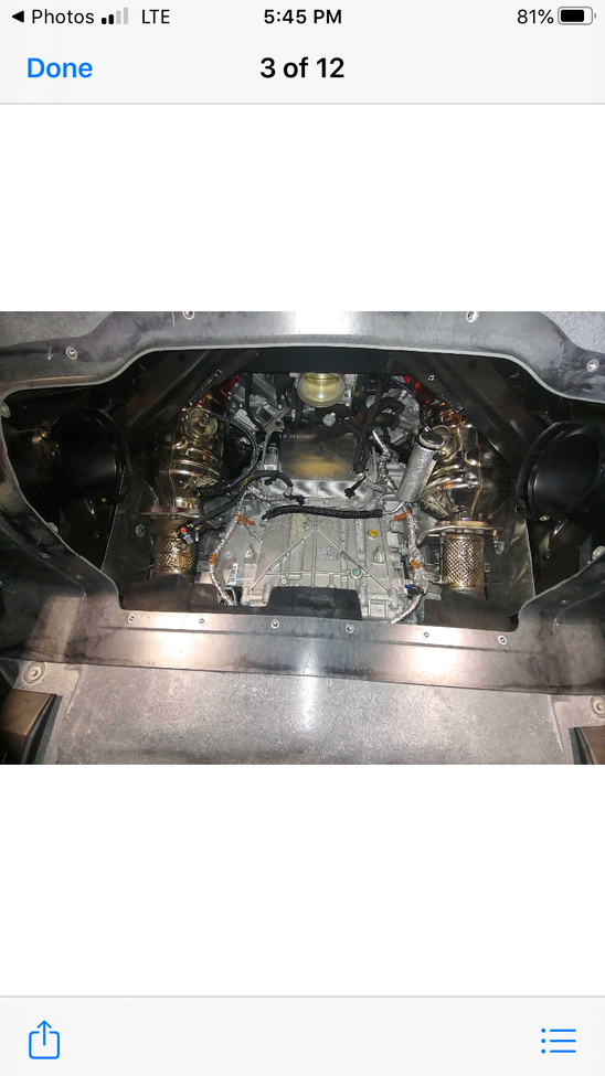

Originally Posted by Houston Z33
Is it easy to top it up DIY or, will it require a dealership visit?
Remove trunk liner, remove close-out panel, remove air box...
