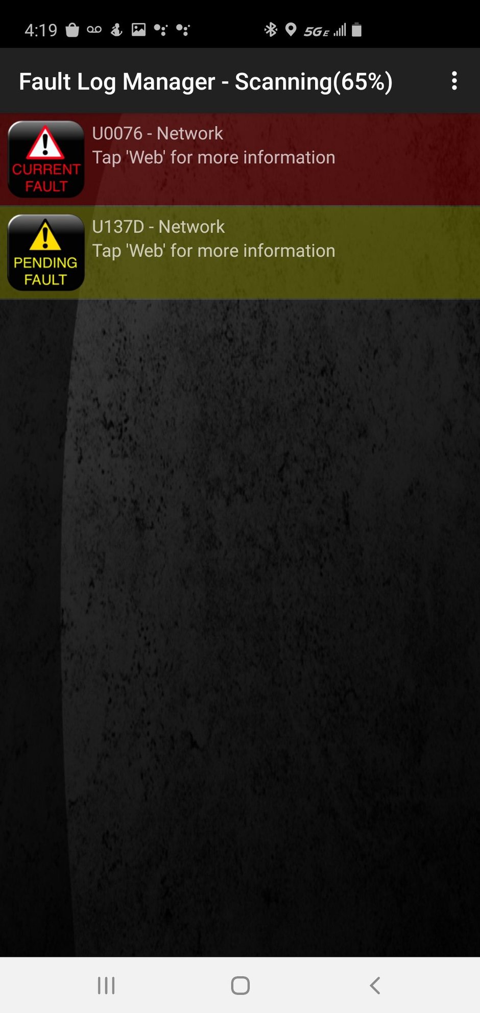

Code "U0076 - Network" and pending code "U137D - Network". Anybody have any clues? I cleared them once already and they came back. Quick google search returns nothing, which I've never encountered with a fault code in the past.

DTC U0076 is Control Module Communication Powertrain Sensor CAN Bus Off.U137D is Gear Shift Control Module Received Invalid Data from Engine Control Module and is set by K212 Gear Shift Control Module & K20 Engine Control Module.
No bulletins that I see. Looks like it could be a communication data line fault or an internal module fault.

update: The dealer still has the car. The tech found a plug that wasn't in 100%. If this doesn't solve it, they have no idea what it is yet. They talked about the possibility of a wiring harness. They also talked about flying someone in from GM.
