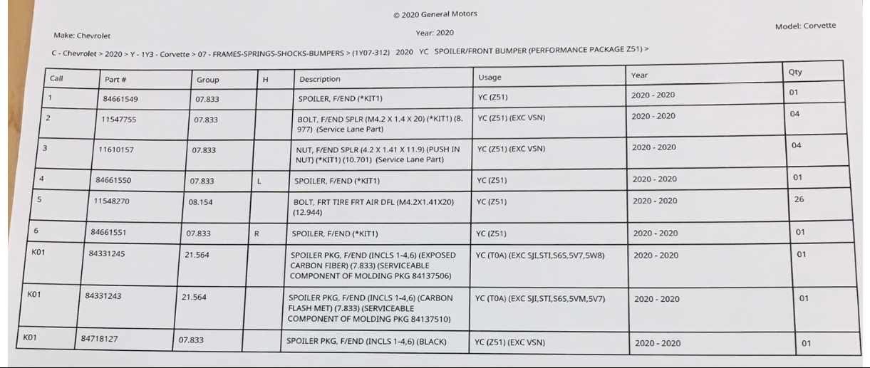

The OEM Tupperware one is an expendable piece to me. Here are all the part numbers, you can buy the middle section for $50.

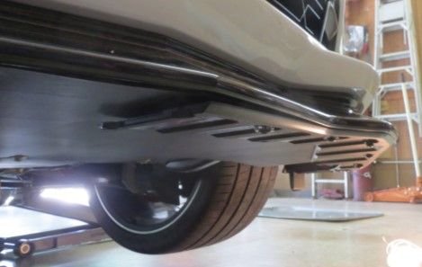

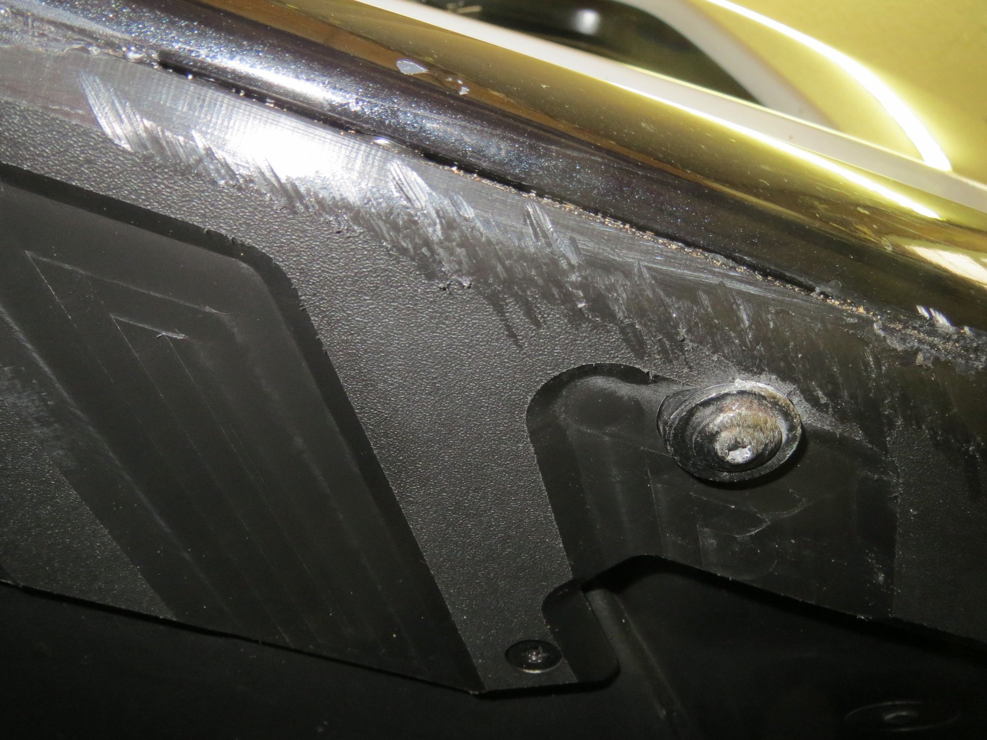

I have a "Scrape Armor" Splitter Protector on my 2017 Grand Sport with Stage 2 Aero. It saved my $1500+ carbon fiber OEM Splitter. here are some pics. They will proably have one for the C8 as they have them for Ferrari,Lambo's etc. This is a PDF of my install: http://netwelding.com/Splitter_Protectors.pdf
Pic Installed.
Scraped when going down a step driveway in town. Splitter saved.
Half Installed.

No question if you have a carbon fiber $1,500 splitter you would want to protect it, but putting $450 protector on a $50 part seems a bit If you damaged all three pieces it's only $150, so you could do that 3 times before you have just the money for a protector that's just more plastic. My last car had a painted chin spoiler and if it bumped something it was junk. I'm looking forward to having a sacrificial piece that can be changed out in minutes that is super cheap.

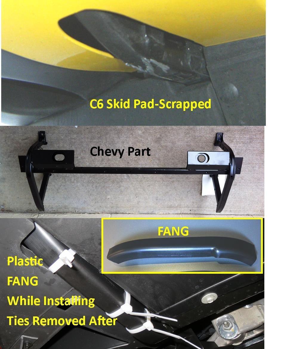

Having scraped my C6 (including the aluminum skid pads- GM calls radiator supports,) the aftermarket Splitter on my 2014 Z51 - and it's aluminum skid pad fortunately covered by a FANG, and my 2017 GS Stage 2 Aero Carbon Fiber Splitter thankfully protected by a Scrape Armor Protector plus hit it's FANG protected skid pads a few times- I'm getting the LIFT OPTION for my C8!
PIC FANGS from Forum Vendor

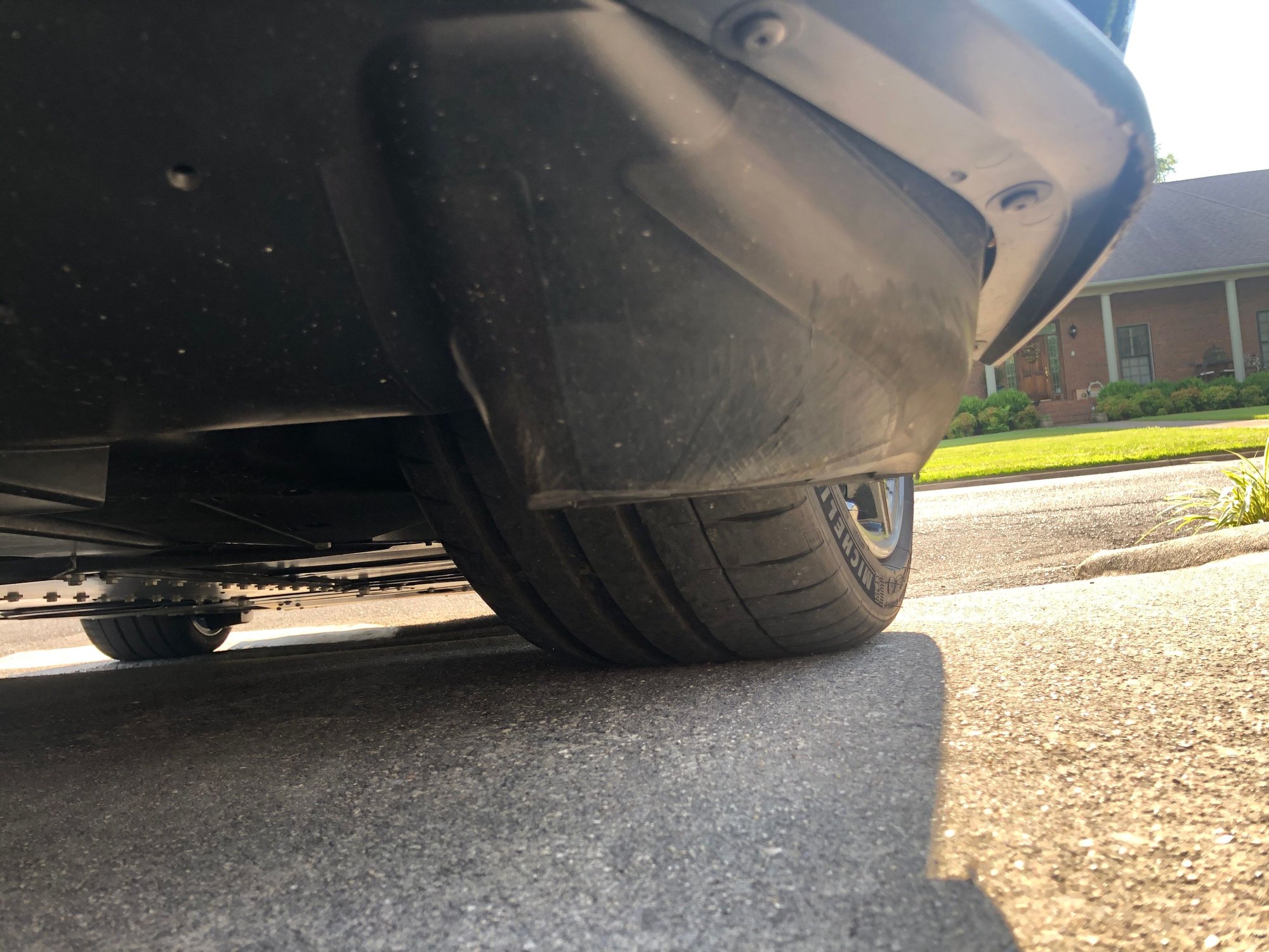

There are 2 things that scrape. The first thing to scrape are these rounded bumps tucked under the bumper just in front of the tires. They are impossible to see if you are not on your knees looking under there. It seems their only purpose is to provide an audible warning to pay attention. The splitter is the other item which will scrape in more severe situations. It has a lip at the bottom which would prevent you from putting an adhesive type protection because there is very little to stick to. Thankfully again you cannot see the damage unless you are on your knees. I have used my pocket knife to trim off any plastic fuzz that is showing. I have not found a speed bump that caused problem, only driveways. The C8 is better on driveways than the C7.

Actually there are 3! That first you thought GM added as a "Curb Feeler" is NOT there for that reason, although it also provides that function! It's called an air dam or air deflector and is designed to reduce air going under the car reducing aerodynamic drag. Want proof? The Chevy Volt has one almost as deep as the Corvette and GM says it increases mile range when driving on batteries. Frankly if you look, most cars have them going across the whole front for the same reason, as many C7s and all C6s.
The 2nd highest IF you have one is the Splitter. BUT there is a 3rd! It's aluminum called a Radiator Support but serves the function of a skid pad as well.
Side View on C7 and Pic of Plastic FANG I had on my 2017 Z51 and now on my GS. If you think the noise from a scraping air dam is bad that aluminum on pavement makes it sound like music! Expensive if you have to replace, as some pastes have!

Pictures of the 2 items I was referring to.

Yep, like my 2014 Z51 and my current 2017 Grand Sport with the Stage 2 Aero Option, you don't have a center air dam. Those are the "side air dams" that divert air around the front tires and reduce drag- WITHOUT ALSO CREATING DOWNFORCE! This makes my answer more complex but full details are in PDF I made after a 2 year "investigation" as to why my early 2014 Z51 (built September 2013) was shipped with a center air dam (as my C6 Z51) had BUT my dealer was told not to install! I was curious as to WHY! This PDF has 7 pages on aero info: http://netwelding.com/Air_Dam.pdf
