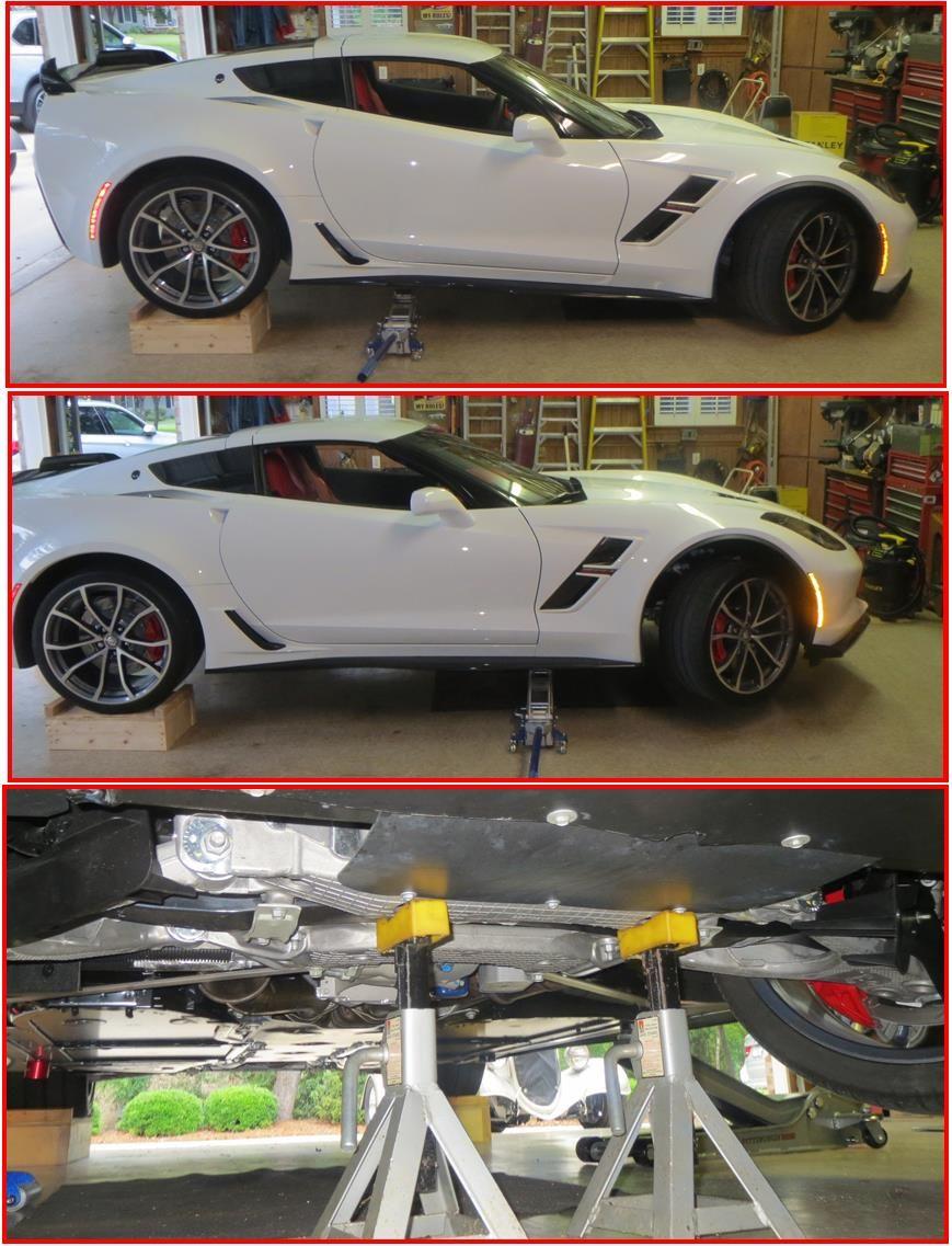

First no need to have level as the C8 drain plug (only has 1) is in the front of the engine! You'll get more out with just the rear lifted!
I don't like race ramps, found one would slip, needed someone watching etc. This is how get my C7 level. I use these wood stanchions I made under the rear wheels.

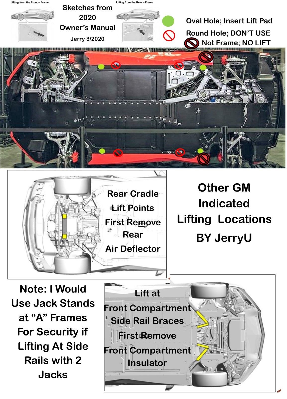

For the C8, my plan is to "always use jack pads" so I'm lifting on the frame NOT to the outside, which is a large area BUT not under the frame. I always use 2 jacks.
I'll put jack stands under the lower "A" frame as close to the spindle as possible. As I do now, will keep some tension on the jacks for added security. Could put the stanchions under the rear wheels as well. Can buy those from the race ramp folks. they are plastic and mind are stronger!
