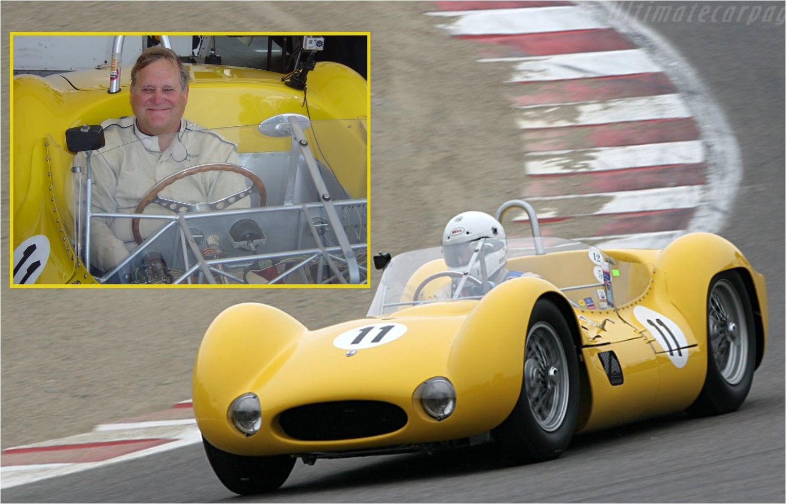

SIDEBAR
Recall Moss's comments about the Maserati Birdcage he drove when he was 30 and said it was the best handling car he had been in (referenced in my CarTech Pro Series book on automotive welding referring to the gas welded small tubes in the 66 lb Birdcage chassis.) Reminded of my friend Tom who had ~40 Vintage race cars (also ~40 old Great Lake race boats, all restored.) That's a pic I took of him in the "Corkscrew" at Laguna Seca Vintage races. He was a "purest" insisting on the original repro tires, brakes etc. Recall telling him he needed better brakes for his 1951 C-2R Chrysler hemi powered Cunningham he also raced. He'd come down the straight, leading the pack into the Andretti Hairpin and by the 2nd turn be last! I said he needed better brakes BUT he wanted to feel exactly what the driver's in-the-day felt!
Looking at the book about his cars he had published to donate proceeds to his college, he also had a car Paul Newman drove, the Honker II, an AC Bristol, Cobra, GT40 Mk III, Jag XKSS, Porsche 550 Spider. Tom, was born the same year as I but unfortunately died unexpectedly 10 years ago. After attending his Celebration of Life and seeing his many Lake Racing boats I bought some of what Tom owned. Albeit mine are a bit smaller! Have over 50 cars in my Man Cave. My Baby Bootlegger Lake Racing boat he had fully restored is my biggest model at 36 inches.
This is pic I took of Tom in his Birdcage that I have on my Man Cave wall. Great guy, very unpretentious!
