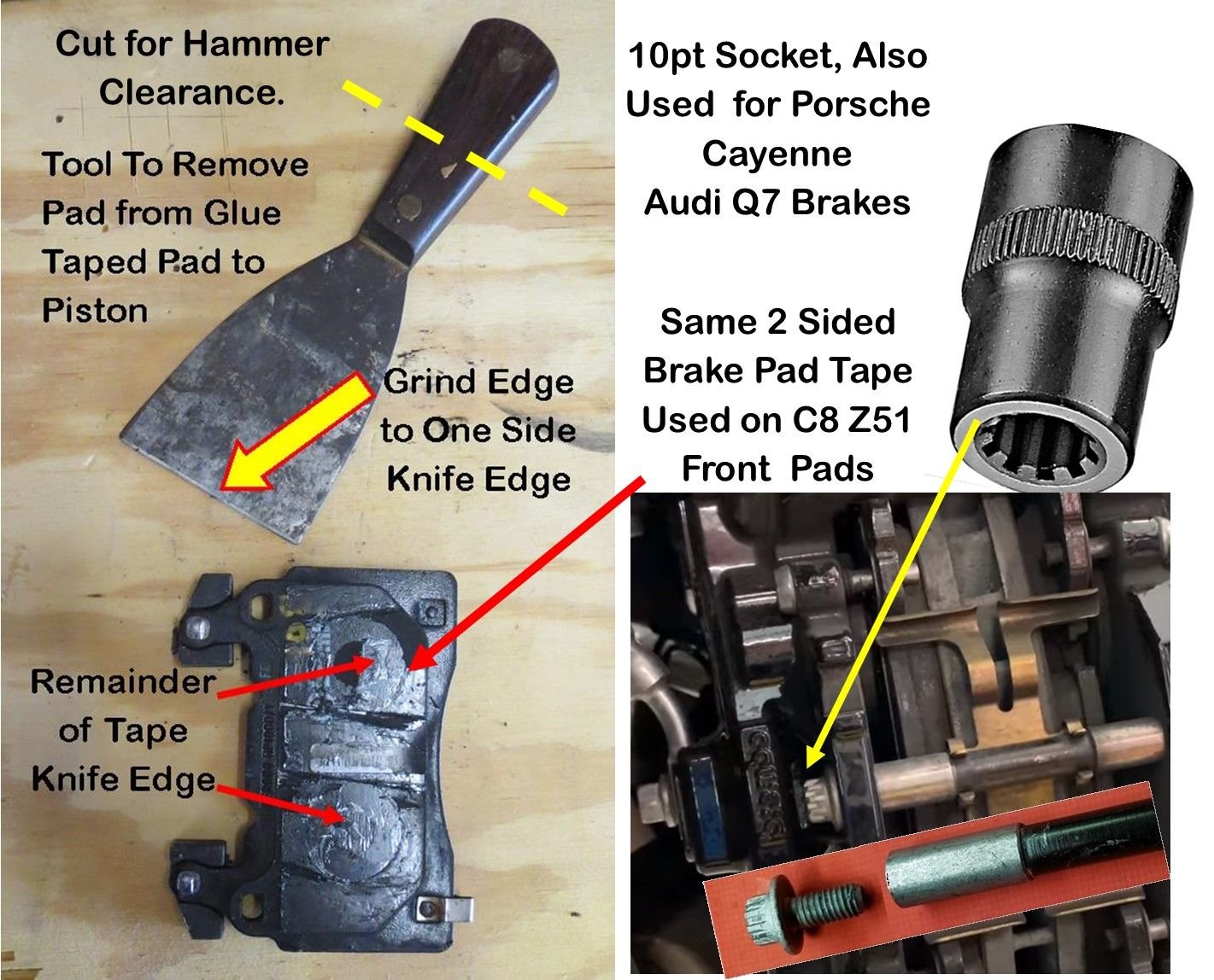

For those thinking about changing to ceramic pads , 1521, race pads or what ever , dont bother to get a 10 point socket to remove front pads. The fronts are glued to the piston, great German design? The only way to brake them loose is to remove the caliper. Just a time consuming pain of the ***. There is no room to wiggle out the pads from the top. The rears are the same as the C6 and C7, just drive out the pins an the pads come right out.

Did you try to drive an old metal paint scraper between the pad and the caliper housing to break the glue free, before removing the caliper?

You need space to undo/ pry up the glue. I tried it , it did not budge. Stock pads are relatively new, after 20000 mile or so , there may be room to work I've yet to see a video that shows someone removing the 10 point nut and removing the pads from the top. If you know of one ,please post.

SAME THING ON MY EARLY 2014 Z51(built September 2013!) It had the same strong, double sided high temp tape on the front brakes! Used for about the 1st 6 months of production. Had to figure out how to remove pads and not much help even from a friend who does European cars that use the same tape. Even called 3M who make this type of tape - NO HELP. Below pic shows what worked for me. Takes quite a bit of force with a hammer! This is a PDF with many pics of my brake pad installs on C7's. The 1st had the tape, the two on my Grand Sport, did not: http://netwelding.com/Ceramic_Pads.pdf
PS: Be 78 when my C8 arrives. Will do the brake pads, install the splitter and side skirts I have on order from C7 Carbon BUT may consider letting my Courtesy Delivery dealers, great Corvette Tech change oil! Be the first time in all 6 of my Vettes didn't do it myself!
Pic below is what I did (on left) and what you'll need for the C8 (right.) Would like some feedback from anyone trying. That's my plan:
