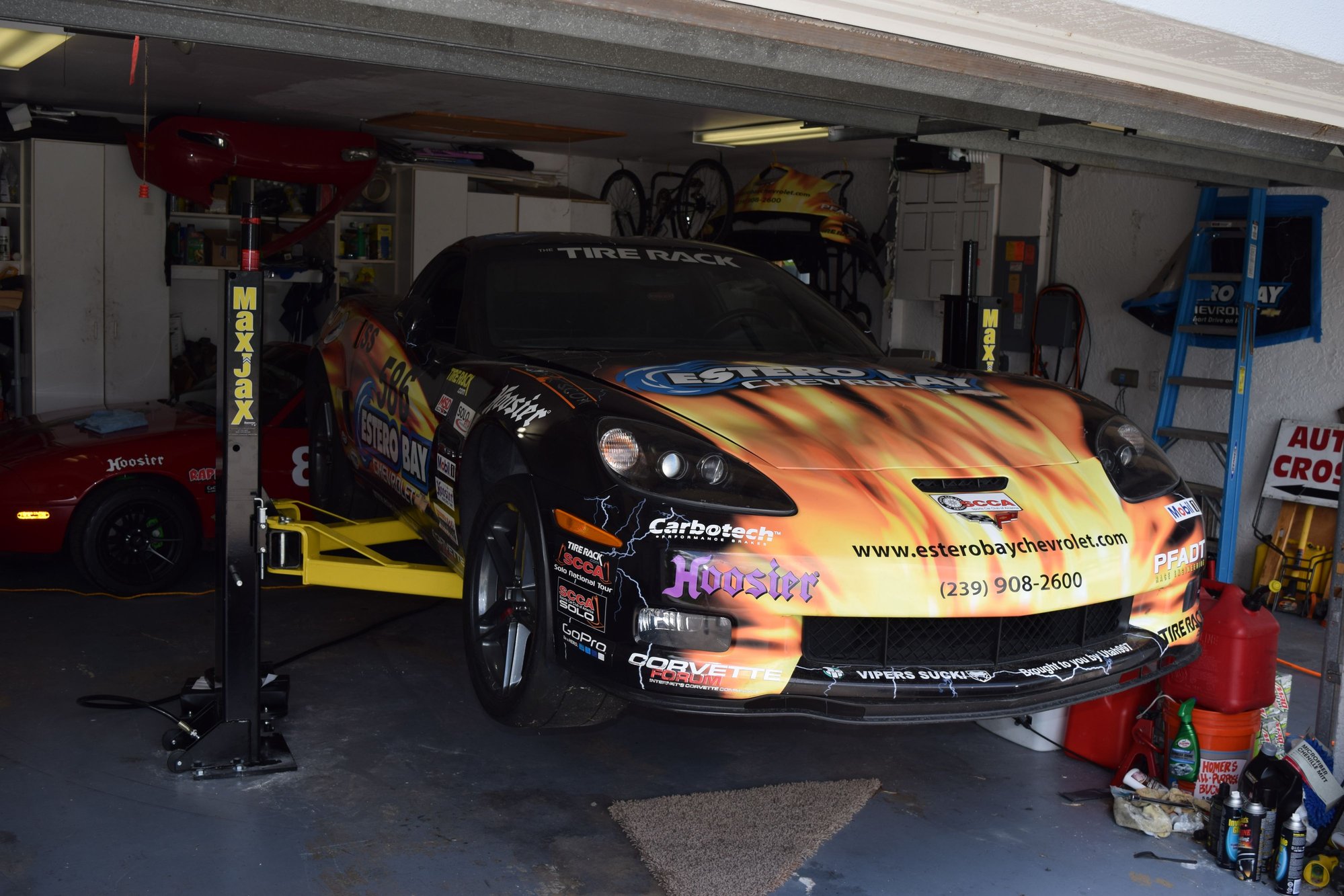

I've got a MaxJax lift. It's great! Portable, can be moved for wider vehicle, arms are adjustable, easy to install. Simple maintenance like oil changes, trans fluid changes, installing exhaust headers, etc. is easily done with the MaxJax. Don't know how compatible with other cars, but my C5, C6, C7, wife's Mustang, and my Silverado all fit without moving the lift to other position.

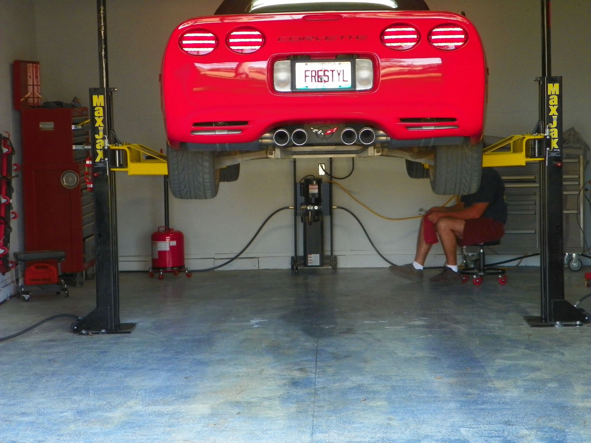

I have had a maxjax for over 7 yrs. I tossed the cart and mounted the hyd setup on the wall. the hyd quick disconnect fittings are junk. toss them in the garbage and buy some quality fittings. I spent about 150$ on better fittings that wont leak. you need to ensure your concrete floor is 6" thick and make sure the anchors are properly seated. using a impact may loosen them over time so check them often.
lastly sliding around under the car on a rolling stool can crack your noggin on suspension parts! . overall its a great asset and I couldn't do the maintenance and mods and repairs I have done over the yrs

I still use my original MaxJax that I've had since 2013. Agree with other post that you need to replace the hydraulic hose disconnects with good ones. Only issue I've had over the years, is that I've had to replace the hydraulic cylinders. I can say that as of last August, Bendpak tech support was supporting the MaxJax and recently provided me with a replacement cylinder. It took several months because they were sourcing new replacement parts for the MaxJax. However, I have no idea how long they will support.
These days, there are more alternatives for residential garage spaces.. I don't care about portability, I never unbolt the columns. I periodically check the column bolt torque to 90 ft-lbs and have magnetic fence post levelers on each column that will tell me if a column starts to move.
