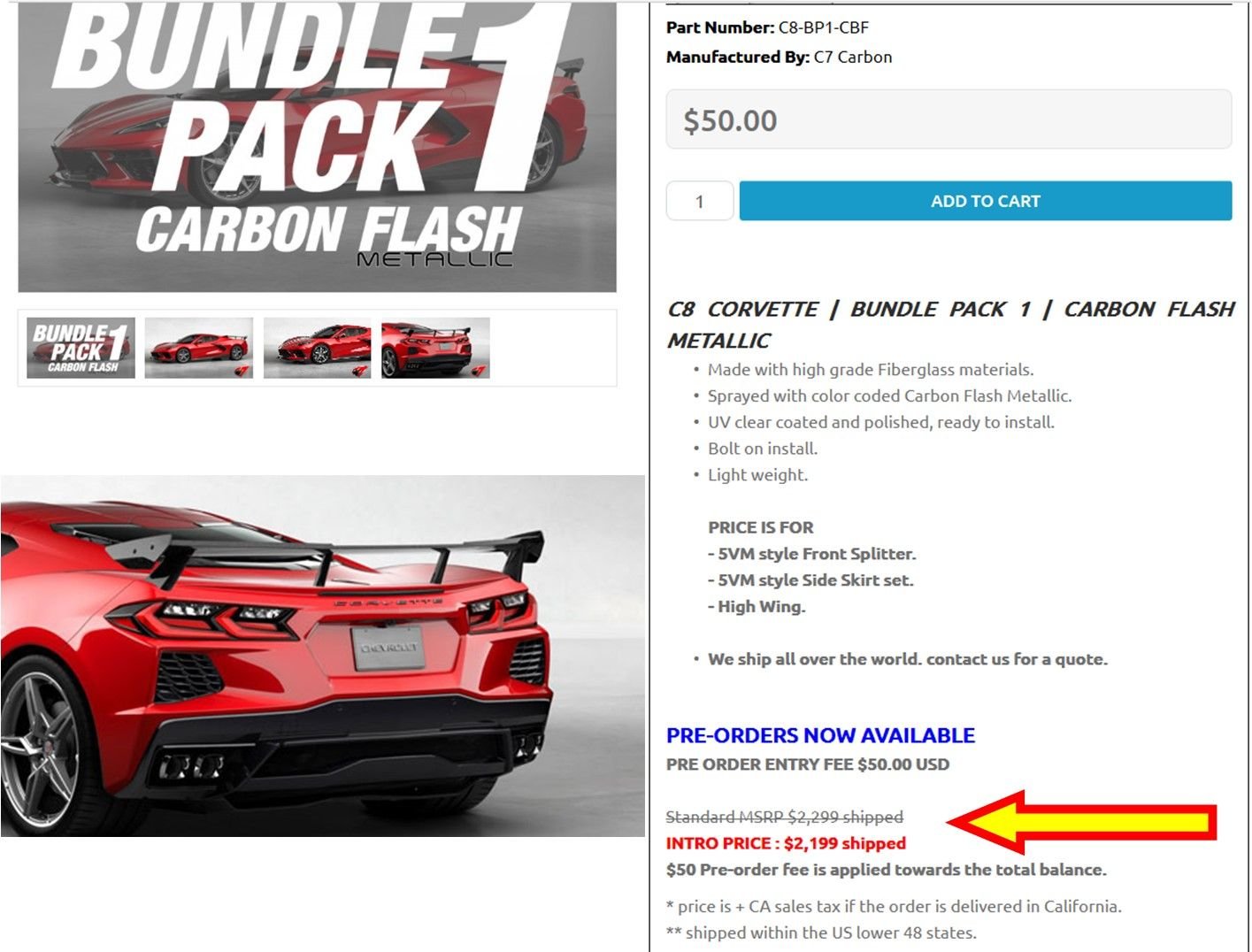

I have the Side Skirts and Splitter on order from C7 Carbon. This is their High Wing in two finishes. Real Caron Fiber $1048 shipped or $799 painted carbon flash like the OEM.

Yep, sounded like it would be delayed anyway. Once I get the formal notice the price for my C8 will decrease ~$1150 I'll chage my order from C7 Carbon to this pacage. Adding the Wing will add $820 over the Side Skirts and Splitter package so I'll save $330. However will have to watch that install video a few more times!
