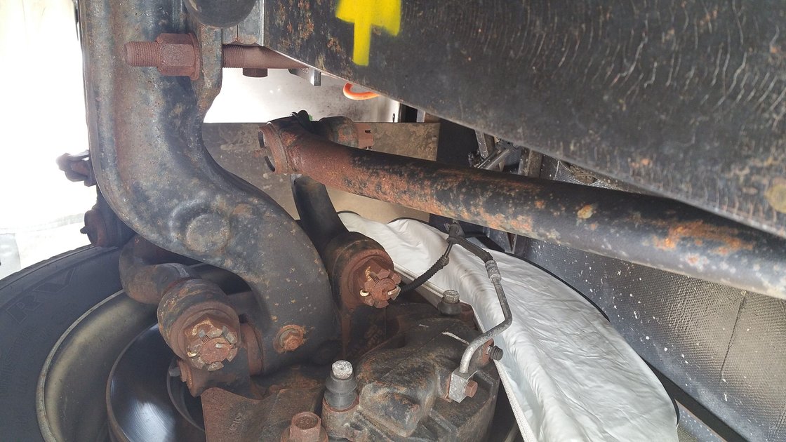

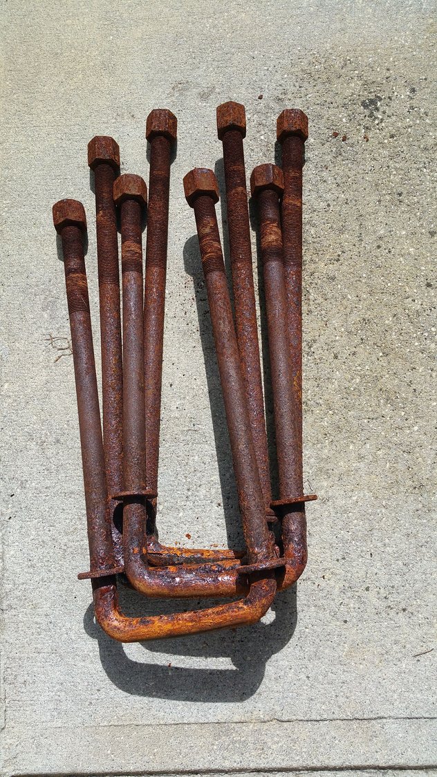

You want to talk rust? Don't get me started about the ATROCIOUS RV industry.
This is rust on a "PDI" never performed by Selling Dealer or Manufacturer and then left for me to hopefully never find on my PDI! They were not ready for my Navy "Attention to Detail" training. These are not apply the brakes and POOF it's gone. It's not always greener on the other side.
This is only 1 of 70+ warranty items I took them to court over (Yes, I had them Settle) for not honoring warranty! There is no similarities between the RV "industry" and the automotive industry except that they both have wheels. And the RVI uses China Bombs - Go Google it.

Geezzzzzzz! Wow! I cringe when I look at your pictures. What you have here is a literal "rust bucket"! Mass produced vehicles are great so that your average person can own one, however cost has to be cut somewhere. Glad you came out with a settlement.

Sad thing is that all of them are like this. Even the high end Celebrity coaches. The chassis sit outside in the snow and rain uncovered for almost a year before they are used. These are not a JIT Item. They bulk buy to get costs down to THEM.
