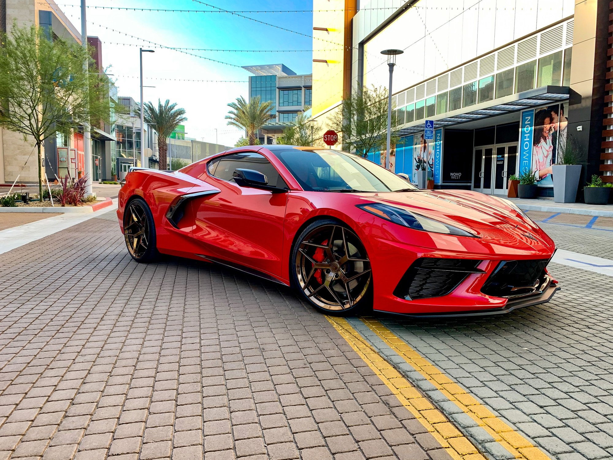

Ended up going with a 20/21" setup, 255/30/20 and 325/25/21.

Originally Posted by Blkout
There are vendors selling 20/21" combos that claim they fit just fine and I've seen some posts that claim the front is a very tight fit going to 20" and might scrub in the inner fender in some circumstances. That's got me worried to go with a 20/21" combo.
I just drove 400 miles home after getting AGL53s in 20/21s installed. My car is also lowered. I didn’t experience any kind of fender rubbing and did plenty of u turns, ramps, bad road surfaces and twisty roads. I’m keeping my 19/20s for performance use but 20/21 seems just fine for the street.
