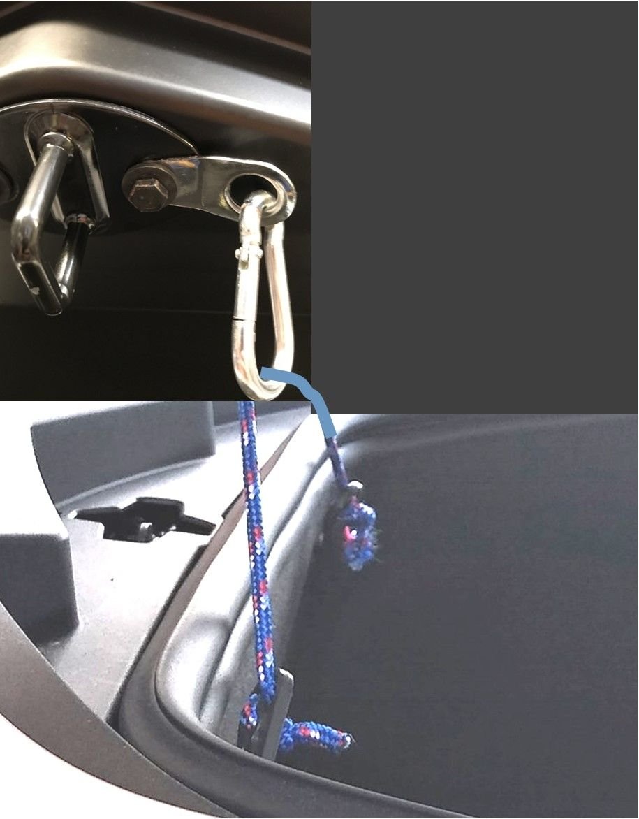

Whatever! His idea is a good one and with a modification of using a bracket (easily fabricated) with a Carabiner then removing one OEM hasp bolt to install is very easy.
It "May Be" an electrical issue BUT until GM defines the cause (other than user error) IMO pulling the fuse would not give me security! Especially after I get past 500 miles and hit redline! I prefer a mechanical security tether! For the ride home from the dealer, using those bottom net attachments and a bracket with Carabiner will be good enough!
Will that bracket and carabiner fit between the hood and the trim / seal around the frunk itself, without damaging the rubber seal?

Kuryakyn 4179 from Amazon plus common AR15 sling. 1 minute install. Stays out of the way of the mechanism. You can easily adjust the length of the sling.

This is a very diversified and knowledgeable group of individuals that have come up with all kinds of safety tethers. C8 Jake’s looks like it worked like it was supposed to and the cargo net holders stayed in place. .
Or maybe running the cord through the loop is what caused the hood to not latch securely?
Then there should have been a warning message and a warning chime. Which there was not. Again... This whole situation is frunked up...

The fact the cord is through the striker, it probably prevented the latch from working properly.
