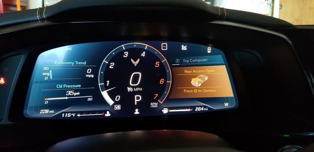

I was taking my C8 for a ride to add some miles toward 500. I got in, place fob in armrest area, started engine and I can not remember if it was before or after I backed up, but that fact is somewhat irrelevant.I was stopped in my driveway and I hear a CLUNK. I thought I hit something or ran over something, but I WAS NOT moving. I was in PARK and stopped! After looking around and not noticing anything, I finally saw my dashboard and WOW!
I can not remember if I had opened the rear trunk to show someone my C8 a few days earlier or not, but on my best memory, I always watch the trunk get sucked down - too cool, why not watch! So 99.99% sure trunk was closed. There is something strange going on with the computer / electronics on this vehicle is all I have to say!
So question why I was stupid to install a secondary frunk safety wire all of you _____! Too many years flying and military to not do so! Not sure what to do / report to whom from here. BTW, as soon as I realized what occurred, I immediately documented both items with my cell phone. BTW, Android Cell phone was plugged in USB. NOTE FOB is such that no buttons are in contact with anything. I specifically intentionally place it like that JIC - NOT knowing it would be valuable information 15-20 seconds later.
I heard the event happen! Hard to recall if it was 1 or 2 clicks. No money on it, but it sounded like two, but again, could have been 1. The sound was loud enough for me to hear with my hearing loss! Feedback and thoughts are welcomed. I'm at a loss for words.
After closing and making sure Trunk was closed I went for my leisurely drive and added another 25 without incident.

Again, I actually heard the noise of the Rear Trunk Latch opening while I was already sitting in the car and not physically holding the FOB. It was placed in the arm rest area intentionally with face side away from any surface out of frunk considerations never thinking that the Rear Trunk was an issue too. I'll report this event to the wonderful Concierge and see what they do with it.
Fyi, and no pilot jokes necessary, as I make my approach to the driver's side and door, I walk down the passenger side first, then the back and up to the driver's side to get in. If the Rear Trunk was already open, I would have noticed it.
Last point of note that I am not sure matters, but my wife was nearby waiting for me to get the C8 out of the garage before she got in the passenger side. She was going through her Apple Phone getting ready to hook it up to the C8s audio. I only mention this because I'm convinced that somehow there are spurious signals being generated and received causing unwanted actions. I think that I might now pass on the wireless android or car play coming in the 2021 MY.
