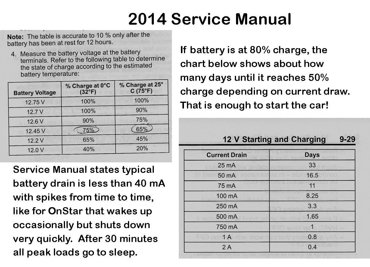

I seldom used a charger with my two C7s- even when going on vacation for 2 1/2 weeks. (Lots of lightening around here in the summer and have fried some things in the house, sure don't want that with the Vette! I do keep a charger on my Street Rod 24/7 BUT I did all that wiring and IF needed could do it again!) . The C8 is probably like the C7. Not like older Vettes these shut down most power after ~10 minutes and all after 30 minutes. Will power up OnStar for a very short time periodically but shut right back down.
Good for at least 30 days starting with 80% charge.
