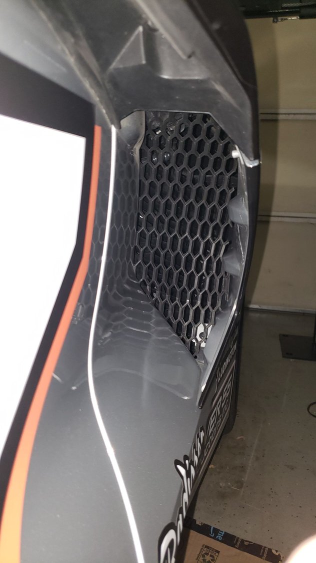

i have the side intake ones behind doors from radiator grille store it has alrady kept countless leaves from going in there.

here is a pic

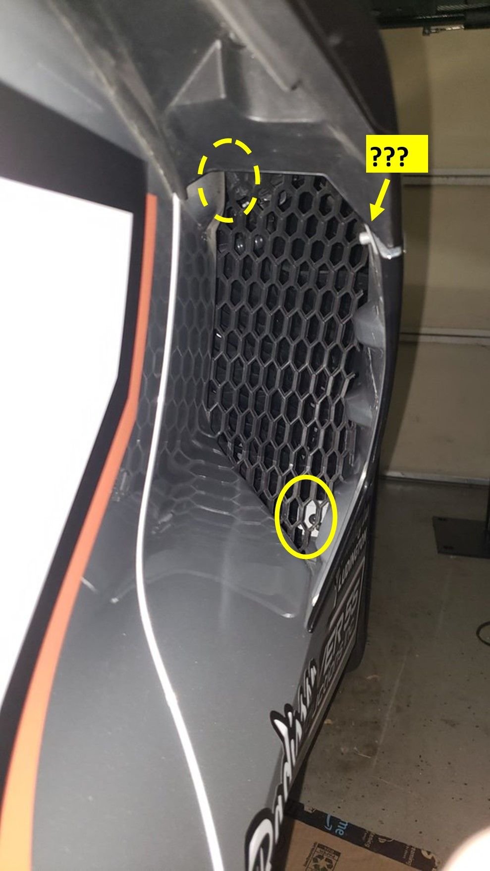

Thanks. Just installed screens over the front AC Condensers made from a 16 inch X 48 inch sheet purchased from Custom Car Grills. Have plenty of material left to make side vent mesh protectors so just looked at my vents.
On the driver's side there is already a grill stopping "stuff" from entering that fan, which is only to blow air over the engine. Only have heard that on a very hot day when I pulled into the garage. It ran for a short time then shut off. That mesh is deeper in the vent opening but any debris would fall out the bottom of the car.
On the driver's side, where the extra coolant rad is on Z51s, only thing I see to attached the mesh is a screw on the bottom I could make a Bracket to use to attach in that spot and a bolt holding a wire and ring on the top where I could do the same with a fabricated "L" bracket. One is visible in the circle I made below and one out of view in your pic. There I used a dotted circle on your pic.
But yours is not attached that way. There is something I note with a Box and ??? that looks like it may have been used but don't see how it was attached, if it was used. How Did You Attach The Mesh?

it is flexible abs mesh so no added brakets or material was used

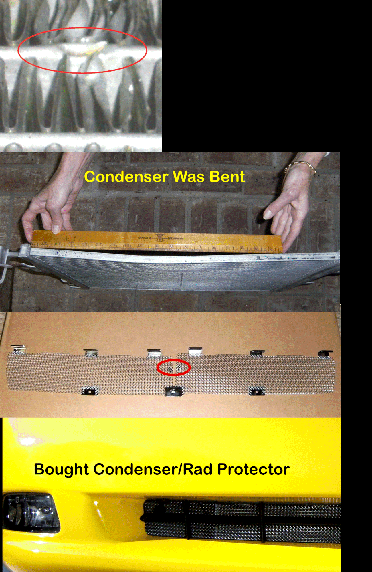

May not be a big issue with the side vents BUT a piece of debris, small rock etc can damage the AC Condensers, especially since they are low and cover a lot of the front. This is my experience with my C6:
My 6 month old C6 had AC coolant and some lubricating oil coming out of my car! Had just driven into town and was close to the dealer. Pulled in and the Chevy Service Manger said yep you have a small hole in the SC Condenser and GM will NOT cover on warranty as it was probably caused by a rock etc. Paid $800 and had a new one installed.
Did not believe it could have been a rock etc so asked for the old Condenser back! Sure enough with a 10X magnifier it was obvious to me the hole was caused by pressure from the inside. Then saw the Condenser was bent right near the hole! I postulated the Condenser was dropped prior to it being installed. Wrote a letter with pics and also quoted the tech who installed the new one saying he never dropped the old Condenser. Asked the Service Manager if I could talk to his area GM Service Rep when he visits and bring the Condenser to show him. No need, he sent my letter to the area rep and I got all my money back!
Here are some pics of what occurred AND the aftermarket stainless protector I installed (that GM did not see a need of installing, as it's not their problem, it's yours IF a hole occurs!)
PS: Someone sells something similar to my C6 AC Condenser protector for the C8 costing ~$350 but most of us installed a less obvious mesh from Custom Car Grills etc for much less! Your Car Your Risk!

Thanks. If I decide to install my black power coated aluminum mesh will make two brackets and attach where I showed.
