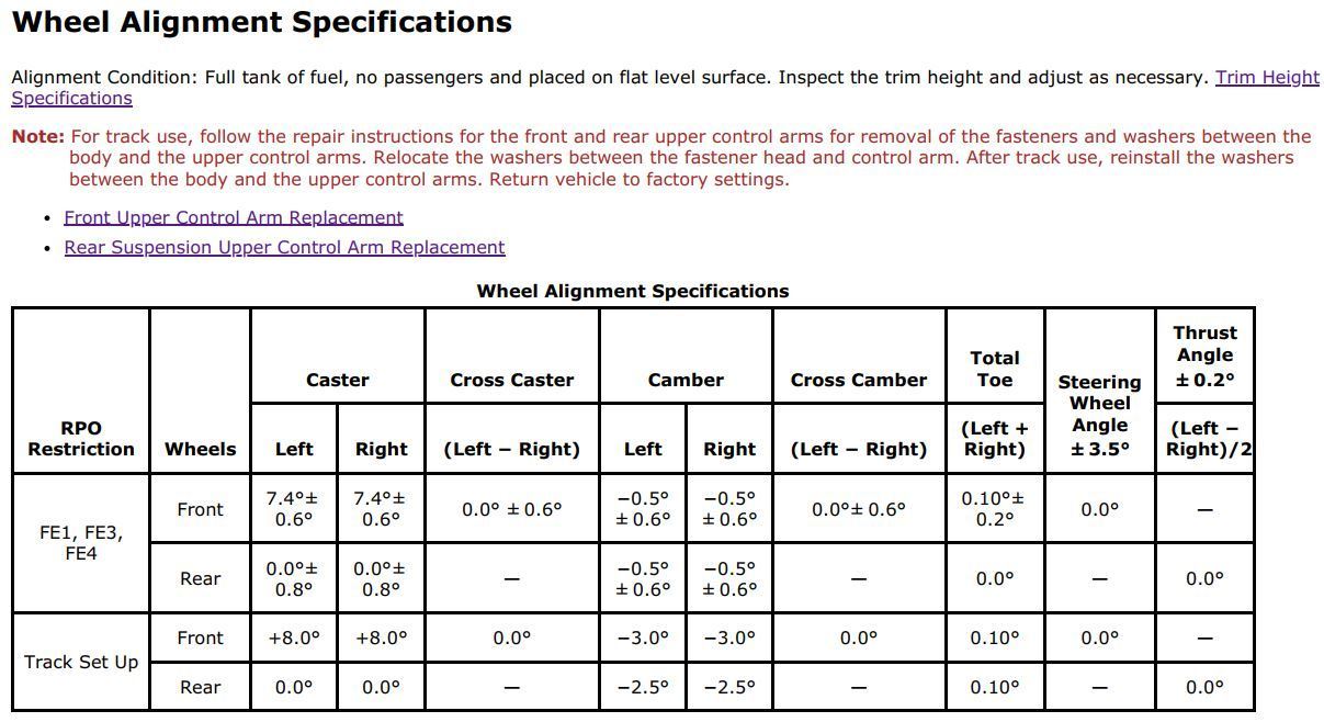

So with past models, the front wheel alignment was often set aggressively at the factory for track performance. For those owners who did not expect to track their Vettes, this resulted in rapid wear to the front tires. Some owners identified alternative alignment specs that were less track-focused and greatly increased front tire life.
I've searched the C8 forums for any posts on this and found none.
Is the C8 alignment set aggressively for performance? Have any current owners experimented with front wheel alignment?

There are tons of threads on the alignment settings. Cars come from the factory with street alignment to help with wear during daily driving. GM then has a recommended track alignment your dealer or shop can use if you plan to track it.8.5.2

Here's the factory alignment specs with both the standard and 'Track' settings. Personally, I've chosen to run something slightly more aggressive than the factory/street alignment for my non-tracked car.

The street camber settings are very mild and tire friendly compared to C6Z settings which were something like -.09* to -1.4*
