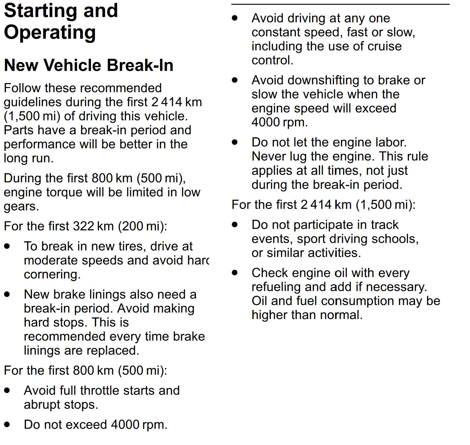

Yes, don't over think this or try to out-smart the engineers. Here's the text from the manual:

Not correct. Stay under 4000 rpm for the first 500, which could be 100 mph in eighth gear.
Originally Posted by davelv
but change it by 1000 miles if possible.
Not correct. 7500 miles, as per the owner's manual....written by the engineers at Warren, MI.
Where do people come up with this wive's tale stuff? We're not talking 1968 Impalas here. Stop the madness!
