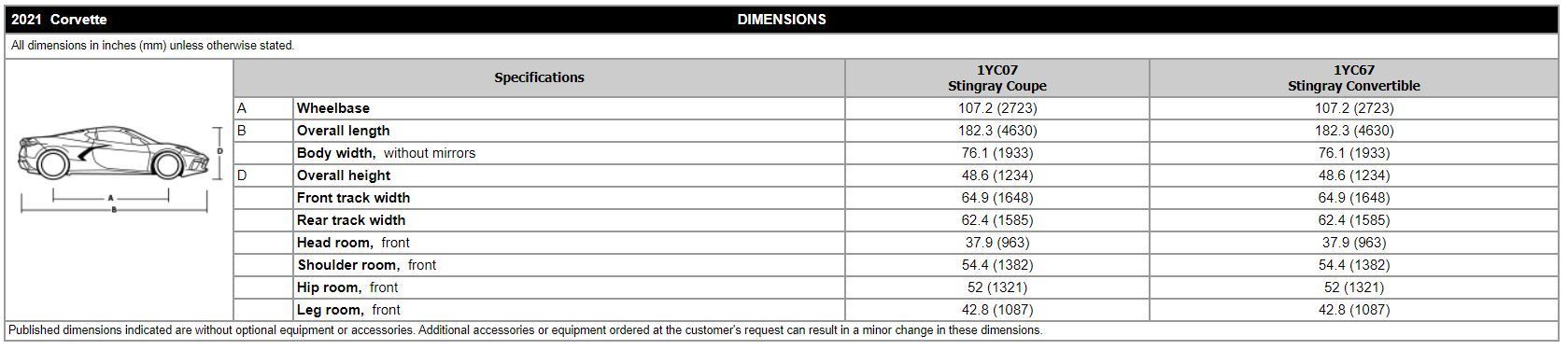

Per the official capacities and dimensions, both are the same.
However, it appears that some parts of the THC roof intrude more than on the coupe.

I wonder how Chevy measures headroom versus how Jeremy measured it? Chevy says the headroom is the same (see post #2).

I think the main difference is that Jeremy was measuring to the structural part of the roof with the seat all the way back. The official SAE measurement of headroom is done with the seat in the middle of its travel, so GM's measurement is to the removable roof. The aluminum structure and latch mechanism limits room at the rearmost seating position.

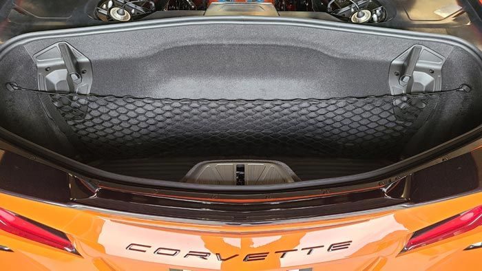

There are subtle differences in the trunk shape. The coupe may have a tiny bit more space for very small items at the very front of the trunk, but not enough to make a measurable difference:
Convertible:
Coupe:

The question is, will a Coupe Targa Top fit in the HTC Trunk?

I assume you were just joking, but the answer is no. That’s why they are shaped slightly differently. The top forward part on the coupe has a slight cutout for the targa top. It barely fits. They used that space on the engine side in the HTC for something, I think maybe part of the coolant recovery tank.
