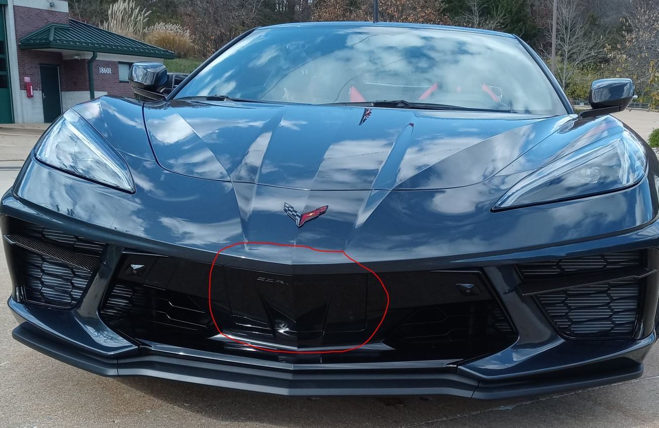

Anyone know how to remove the front cover where a license plate would go?
Thanks!
Old Nov 18, 2020 | 10:27 AM
JVi's Avatar
JVi
Joined: Mar 2020
Posts: 1,570
Likes: 1,029
From: 31 hours East of Peoria, AZ
It can be pried out with some plastic trim tools.

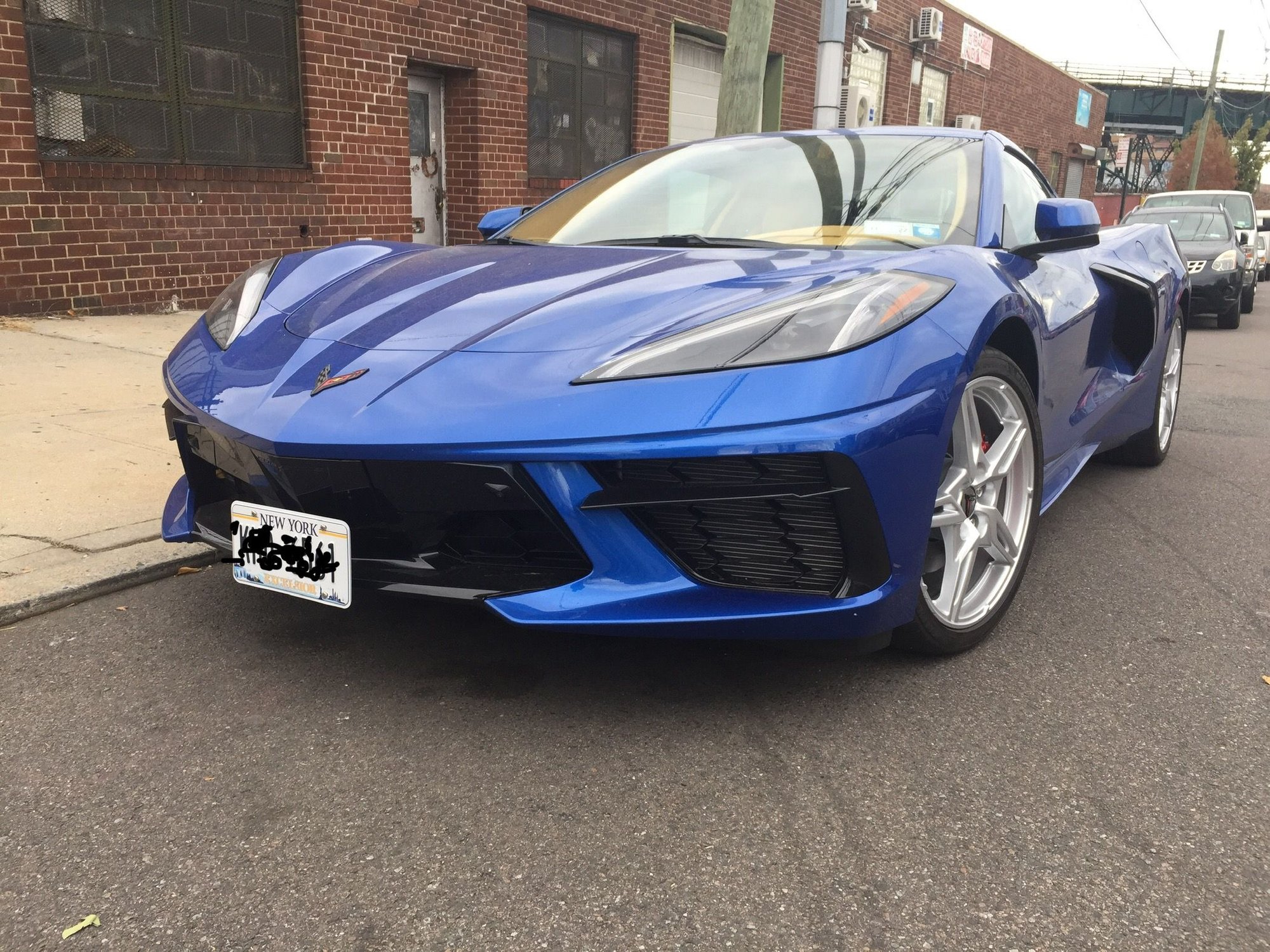

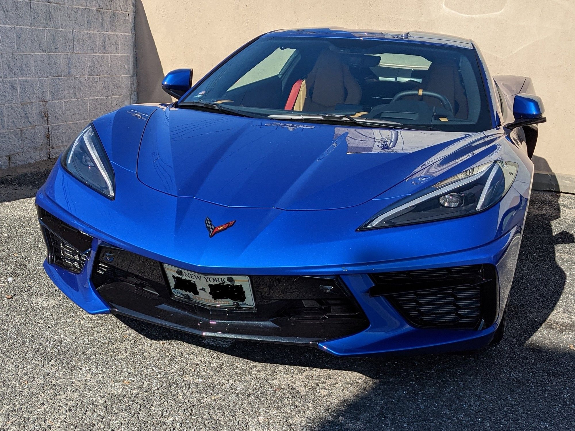

If you don't have the plastic trim tools, a flathead with some electric tape on the tip and a credit card will do the trick.
FYI
Once you get it off you will immediately notice there are no holes drilled back there. You are going to need a couple of self tapping screws.
i put a tinted cover over my front tag and the plate is barely noticeable, but it should prevent me from getting meter maid tickets.
Old Nov 22, 2020 | 01:00 PM
RDSC8's Avatar
RDSC8
Joined: Sep 2019
Posts: 445
Likes: 479
Source for cover?
Old Nov 22, 2020 | 02:00 PM
Cenzoooo's Avatar
Cenzoooo
Joined: Jul 2019
Posts: 791
Likes: 679
From: New York Sitaye
I bought two different ones because I wasn't sure how dark I wanted.
Amazon Amazon
And
Amazon Amazon
I ended up going with the darker one on the front and left the rear uncovered entirely.
I gave the spares to a buddy who just got his c8.
The plate is definitely there, but the cover helps hide the stark white breaking up the clean nose.

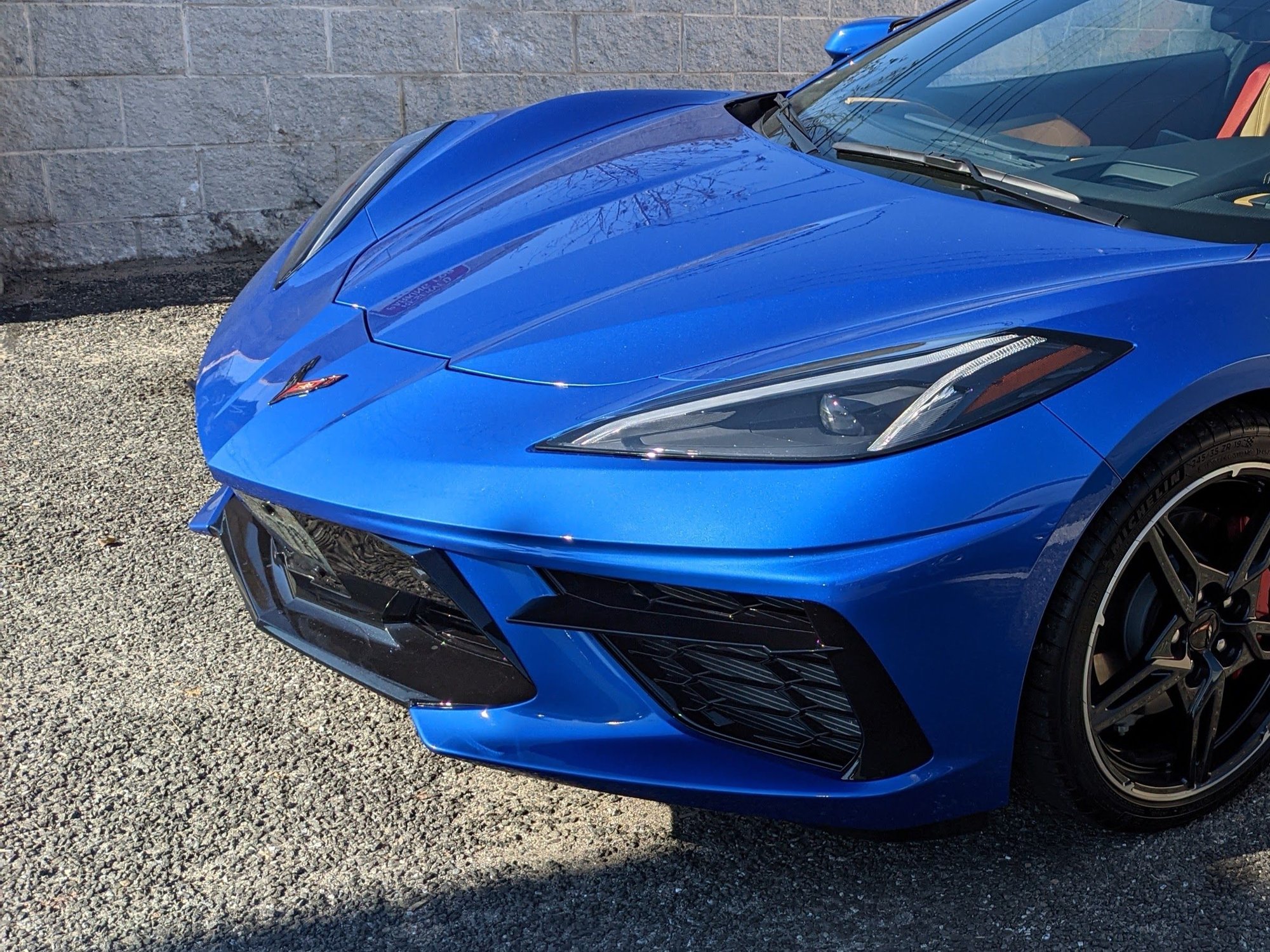

EVL-C8's Avatar
EVL-C8
Joined: Apr 2014
Posts: 750
Likes: 297
From: Central MO
Default Cover
I was too bored!
