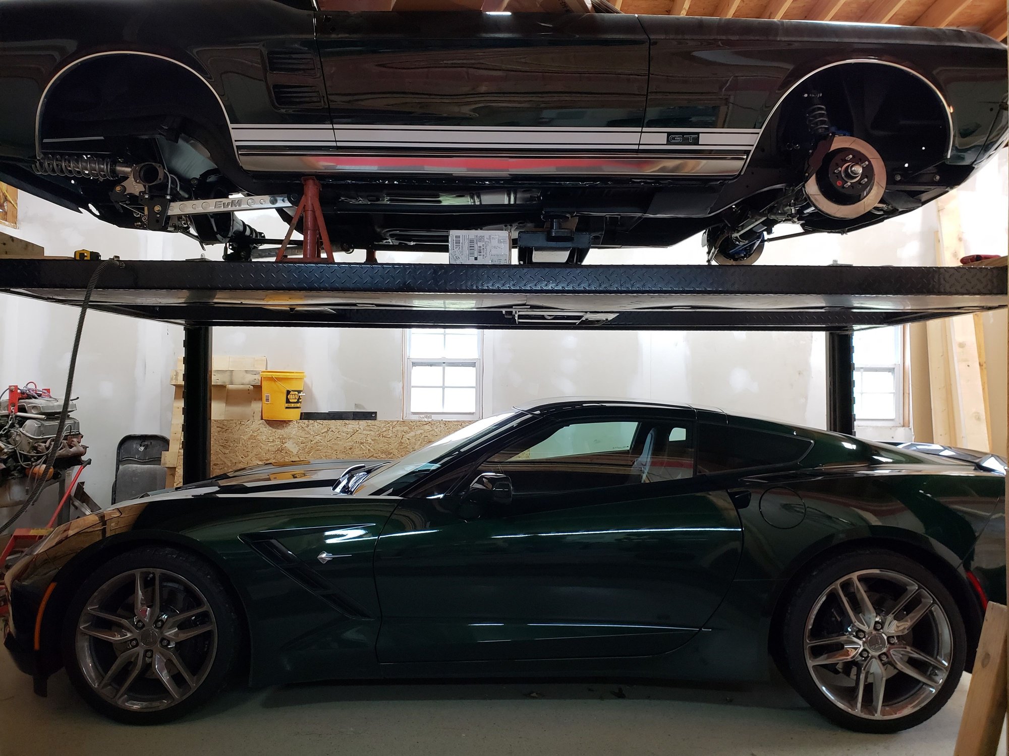

I went with the Titan lift. Not as expensive as the Bendpack but does the job perfectly.

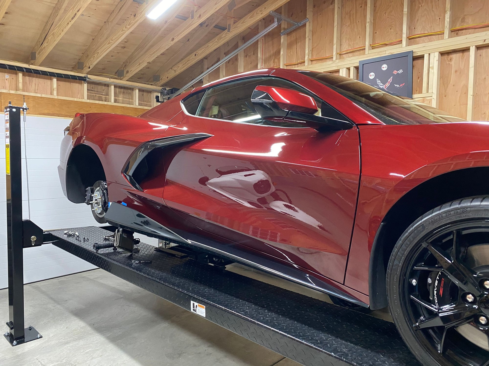

I picked up an Atlas lift from Greg Smith for $2000 and added the jack.
The lift is wide enough for my C8 , the Z06 tires hang off each side by 1 inch.

Is that the Titan SDPL 8000 lift? What is the height of your garage ceiling?

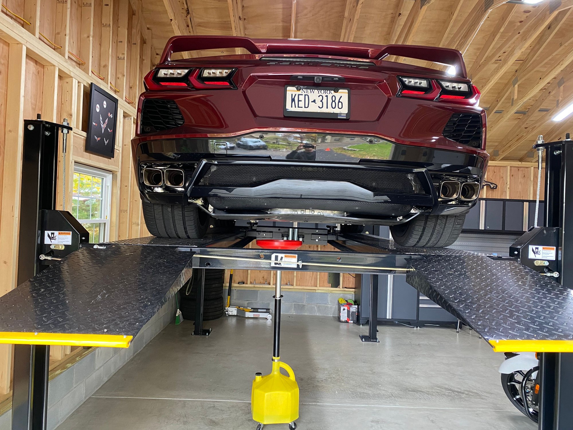

George Vee. I have an atlas lift can you drive the car up on the lift with the rolling jack in place? Do you just push it all the way forward and once the car is up you roll it where you need it?

The C8 clears the jack . I leave the jack in the middle of lift

Yes it is. My garage is 12 ft high. In that picture I have it on the top setting.
